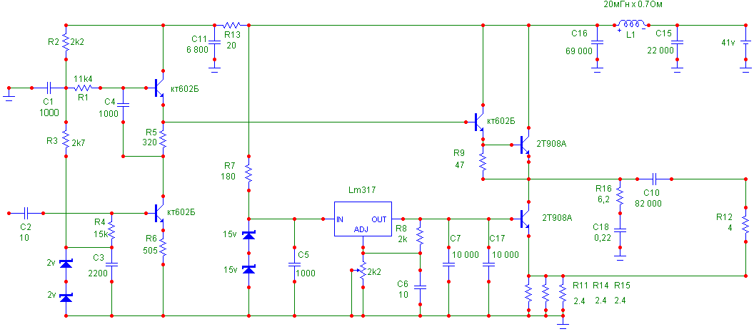

Apparently you have no time to open the link. Here are two circuits based on the same principle - Vbe error cancellation.
These circuits are old classics, they are variations on the Taylor / White theme.
The topology probably has a name of its own, clever guys like kenpeter should know it.
The idea is to keep the current in the upper device as constant as possible.
No Vbe error cancellation occurs, merely a reduction.
As with any NFB based system, the factor of reduction is governed by the gain available, in this case from the servoing transistor (the lower one).
The tringlotron is one of the rare topology where true error cancellation occurs: the error voltage from the compensating transistor is actually substracted from the output; it is an open-loop process, which means there is no theoretical limit to the depth of the nulling (there are higher order effects limiting the accuracy, but this is another story).
Both topology bear a superficial similarity, but as soon as you analyze the inner workings, you realize that the mode of operation is not only different, but downright opposite.

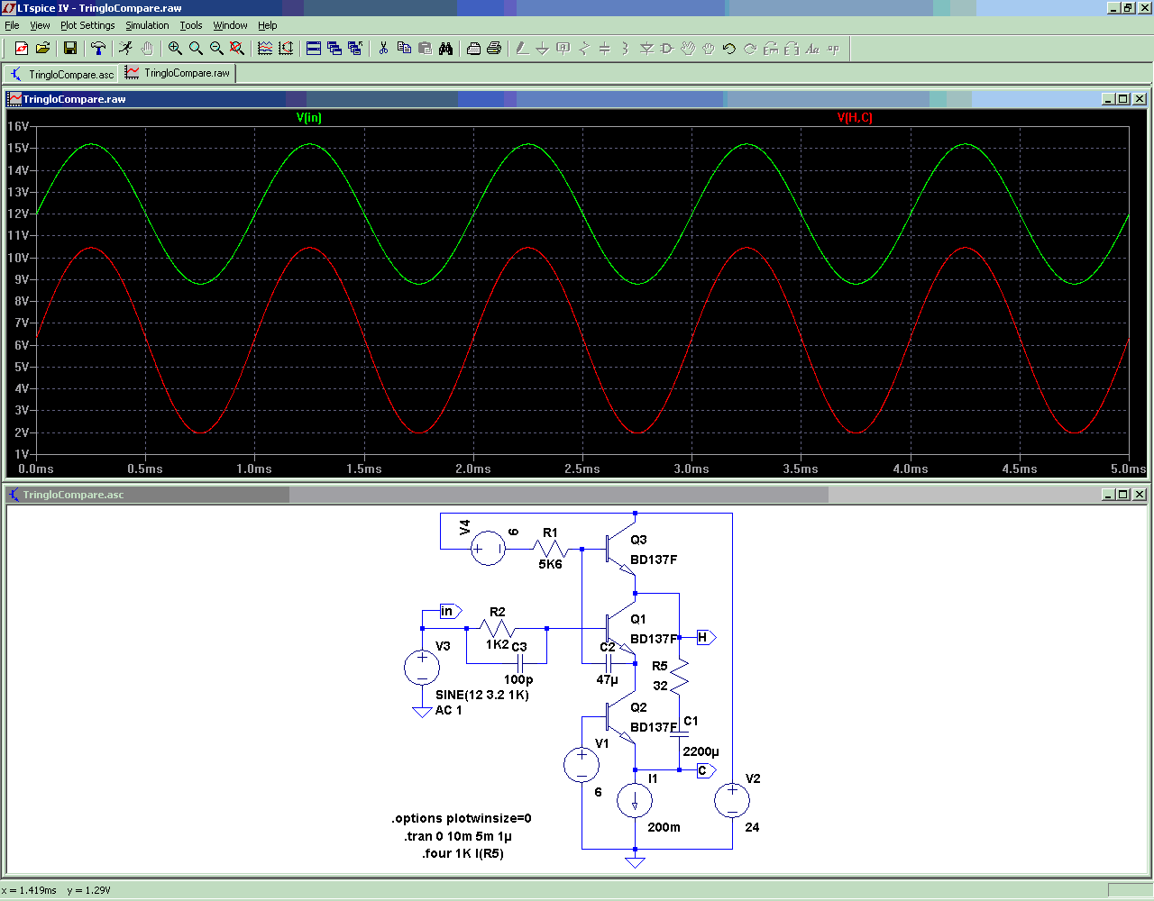

This can be seen below: the green trace is the base current of the transistor in the modified Taylor circuit: as expected, it is nearly constant, and it is in phase with the input voltage (magenta).
The red trace is the equivalent in the tringlotron: the current has the full swing required to drive the load, but the phase is opposite to the input voltage.
This means the input resistance is negative, and that's the key to the "magics" of the circuit.
The result is a THD substantially lower than the conventional circuit on the left.
Thank you, now we are talking the same language.
Conventional follower: input = output + Vbe
Taylor/White - current in the upper device is constant, input = output - Vbe of lower device, current change in lower device has different sign
Your follower - M1 and M2 share the same current, and if devices are identical - the same Vbe. Vbe of M1 (which is equal to Vbe of lower device) is added to the input signal and applied to the gate of M3. Thus Vbe of lower device is subtracted from the output signal, the accuracy of subtraction is equal to accuracy of matching Vbe of M1 and M2.
