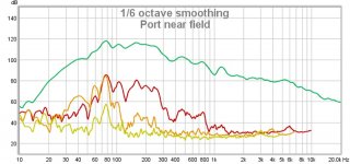

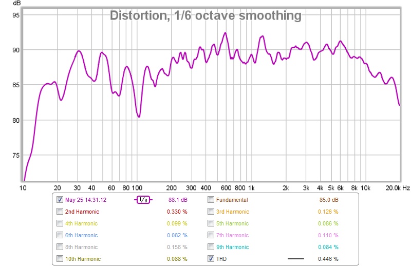

My statements above statements about not measuring any back wall reflections from the cabinets was really bothering me, so I looked closer at sundays measurements and they appear in the distortion plots at ~800 and 1000 Hz, 30 db down but still 10 db above the other harmonics
I am also curious about the group delay measurement. It is "flat" across the crossover point then drops above 3k. How do I interpret this? Is this time aligned?

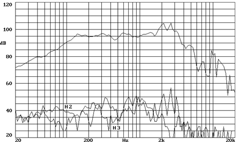

Do you believe in the Easter Bunny? The Great Pumpkin? Doppler Distortion?
Doppler type high+low_freq Intermodulation Distortion can become audible in wide BW speakers.
Simple conservative simulations of Beyma 12P80Nd IMD at 100db SPL estimate -40db margin at 90Hz Xover down to -16db margin at 50Hz Xover. -40db is often considered the audible threshold.

I got impedance's measured, everything loaded into winpcd, added 5uF to the low pass and took some measurements. All without room correction.
First I cranked the amp up to near 120 db and measured the near field of one of the ports. I wanted to make sure that there were no resonances coming from the ML-TQW

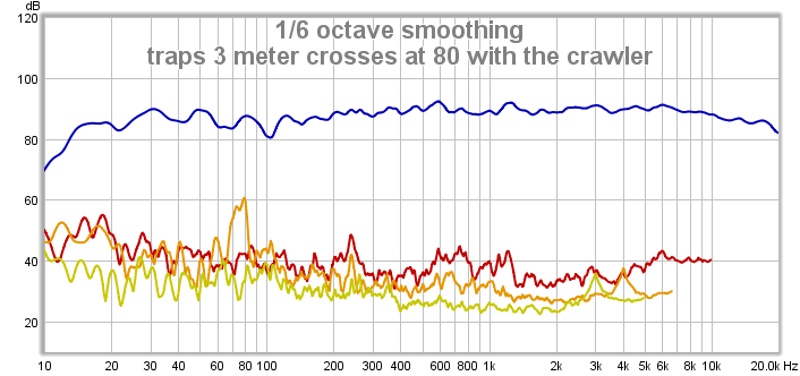

Second is full sweep response including sub.
Waterfall, waterfall at crossover and impulse all look good.
All measurements are 3 meters on axis from the one on the right.
Also did sweeps at 10, 20,30 and 40 degrees off axis and saw no evidence of beaming of the 12p80nd.

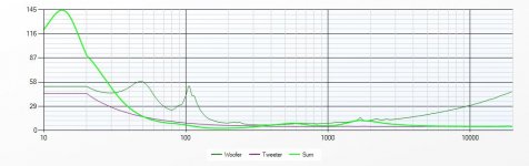

I have become familiar with psd lite and decided to go ahead and use the full capability of the software and add BSC, impedance correction, phase matching and ports to the Traps. Managed to take a quick sweep to make sure I didn't make any errors and it looks pretty good a couple db loss on the low end probably from the addition of the port tubes. Some day I will learn not to change 3 things at once, however the crossover is wired such that it will be easy to make changes and measure when I have a little more time. The audessy results are probably the smoothest I have seen for any speaker in my house.
Is this filter alignment acceptable? Am I missing something, making the wrong measurement etc...?
In pcd lite for offset is says MP to driver AC. Is that telling me that in order to be time aligned the tweeter needs to be 1.85 inches behind the acoustic center of the woofer in this case??

Your graph looks a little more realistic now. One sixth octave is pretty revealing, as it covers a span of only two notes per smoothing calculation. So much less smoothing than one third. Where most of the real music is your actually pretty darn good. 300 to 4 khertz looks pretty nice. The peaks may be room effects. You can find that out by close micing and seeing if they are still there. Close is 6mm (1/4") or less. Best is as close as is possible without hitting the diaphragm. This type of measurement will give you the least room related effects.
The floor bounce/ceiling bounce is very noticeable. You can calculate time of flight and distances from microphone to reflective surfaces and you will find that the really big dips are from those effects.
But as Linesource said with the subwoofer you have there can and will be modulation effects at times.
The air pulsing around you is an oh so cool effect right!
I think overall you have a pretty good crossover design.
