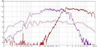

I probably spoke too soon. It would be nice if you could give response of each of the drivers with no crossover. I was speaking of the filter for the Beyma. It looks to have a natural rolloff in that range, but it is very possible that the woofer is having an affect here as well. That is the reason for the need for unfiltered responses.

I must be chasing my tail. The 12db dip moves with the microphone. This is a 2 meter measurement, full system uncorrected. I don't understand how one could design a crossover with that kind of data?
Help, please.

Near field measurement, no, didn't even think about it, will try tomorow. Center of the 12p80nd is 65 cm from the floor, So did not quite work out with the floor bounce since the 1 meter measurement has a 300 hz dip and a 150 hz dip at 2 meter's. maybe a cancelation from the front facing ports near the floor?
Yesterday, I realized that I could make impedance measurements with near field sweeps simply by changing component values of 1 st order networks then analyzing the slopes with parts on hand. ie, 1, 1.5, 2.5 mh for the 12p80 and 10, 15, 20 for the tpl150. So I got pretty close frequency wise but payed no attention to phase at this point. I wound up pulling almost all the stuffing and port tubes out of the TQW all good until I ran full sweep there is a significant dip at the sub crossover which I believe to be caused by the fast rolloff of the TQW >24db/octave where the AVR is doing 12. so I can either put the ports back in or raise the crossover frequency. I'll try both. according to hornresp I am right on the edge of port loading the cabinet just a couple db impact if I open up to the mouth size to s3.

Just chasing room modes again. but did manage to find the overlay function in rew. I like the 1600 ish crossover, sounding really, really sweet, as I type. I will optimze when I get the next set of cabinets built. need to better understand the offset and phase pieces, all in good time.
