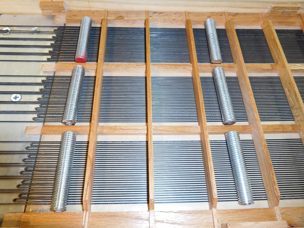

To clarify, the reason I asked about the jig width, is I'd like to make one that could do an 18" panel, even though this one will only be 15".
I think I'll do that and just oversize the lattice until fastened, then cut off excess later, I'd really like to have the capacity/option of making a bigger panel in the future.

As I recall the jig opening is exactly 12 inches wide but I made the lattice about 1/32" narrower to facilitate removal after gluing. Basically I just folded a sheet of notebook paper and inserted it between the lattice side rails and jig to provide clearance.
The lattice details are notched to interlock together so the center support rails and horizontal slats lock in at correct locations. I used a right angle square to square the vertical rails into the jig, and then the horizontal slats drop into the notches and glue down over the wires.
As for welding the sub plate to the jack bolt rods, I just used an old Lincoln stick welder, nothing fancy. The heat warped the plate some but a little hammer work brought it back reasonably flat again.
After building the jig I changed the CAD design to simplify construction-- on the jig I built the sub plate rides in guide slots cut into the jig frame but on the revised CAD drawing I moved the guide slot and made the pin plate wider so now the pin plate itself rides in the guide slots.

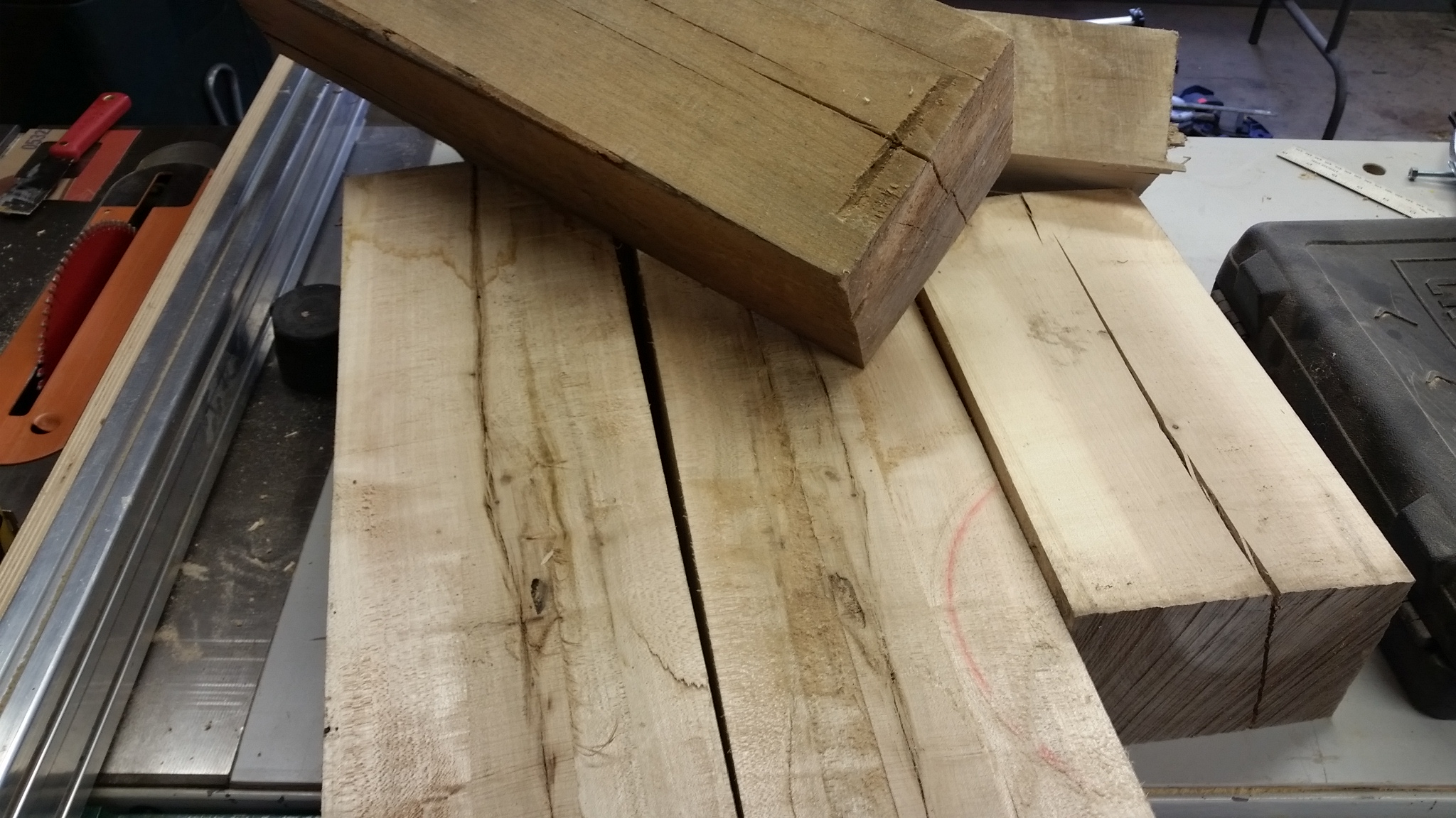

Finally, speaking of the lattice, I forgot that the local Amish gave me a bunch of Maple (which I love) that I could use for it's construction. I can get a ton more if needed, it's all aged/dried too. Any reason I shouldn't use it?
Of course if I do use it, it'll be lots of squaring, planing and sanding, (+omitting splits etc.) but the price was right..

I think maple would be a good choice for the wonderful for the lattice details. 1/4" A-A plywood would be the most dimensionally stable but it certainly wouldn't have the esthetics of maple.
As a woodworker I can tell you that wood warps when you cut it; depending on the amount of dried-in stress that it has. Therefore, NEVER rip a board to net width in one pass. Rather, you have to sneak up on straightness in multiple passes.
I use rough sawn hardwood a lot. A planar won't plane a warped or twisted board to flatness. First you must cut one face flat using a jointer, and then cut the opposite face flat and parallel using a planar.
Also, whenever you feed a board through a planar, don't shoot for net thickness in one pass but use multiple passes removing a small amount on each pass and eyeball the board for warp after each pass. If you see a warp developing, flip the board over and plane the convex face-- the board will then start warping back toward straight/flat condition.
This is why I say that when cutting hardwood, you have to sneak up on flatness and straightness using multiple passes through the cutter.

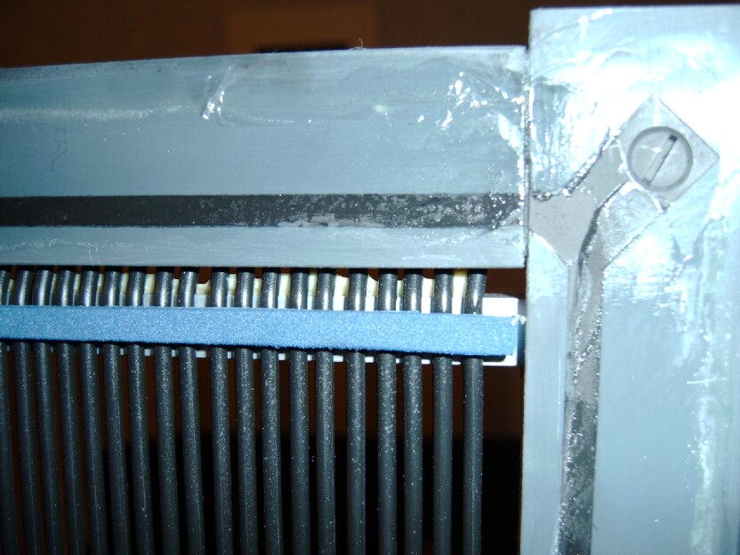

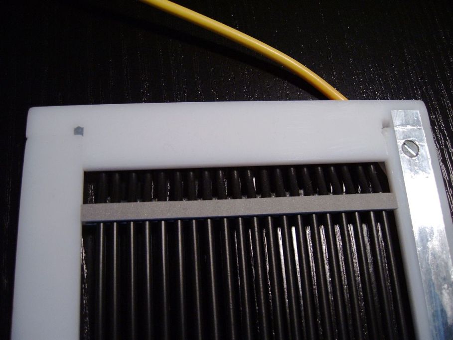

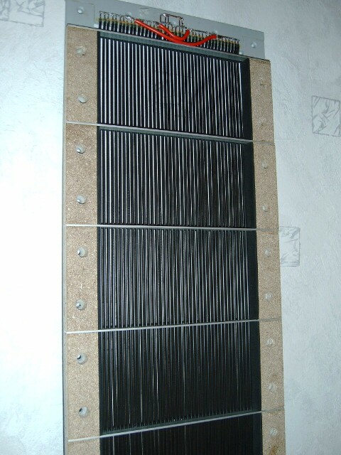

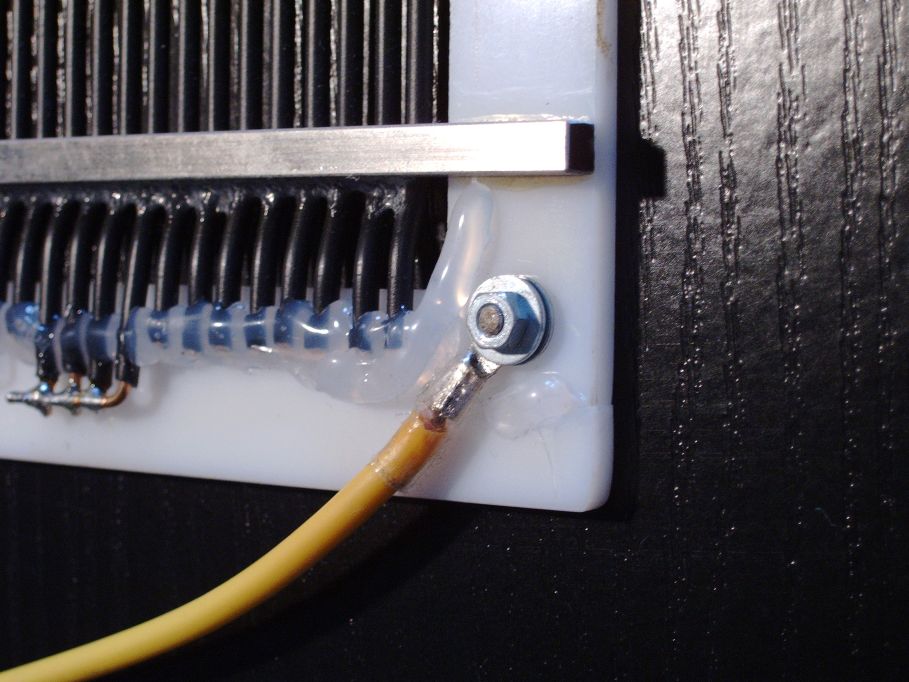

here are some suggestions from my early days panels 😉
First I used Nylon screws also, with the threads cut into the PVC spacer frame.
Found that it had no edge over simple taping everything together, but was a pita for servicing.
Second pic shows the connection and kind of contact ring.
I used graphite spray as charge ring and a simple screw for external connection.
Similar solution in pic 3 and 4 with the difference that the charge ring was made from thin slices of household aluminum foil ... certainly cheaper and easier to source than copper strips ... and functions equally well.

@Charlie: How many 5/8" threaded rods were required to space the wire before adhesion? In the picture I see two sets of three.
Looks like you have a set about every 7-9"...did you have additional sets every 7-9" going up the whole panel, or did you just move them as you went along? Thanks in advance..

About your question:
As you can see my stators are sectioned as 3 groups of 30 wires separated by 2 vertical center rails for the diaphragm support spacers. The horizontal wire support slats are on 2.5" centers. When assembling and gluing in the horizontal slats, I positioned the threaded rods just far enough apart to allow installing 3 slats between them-- installed them one at a time and then placed weights across the slats until the glue set. I actually had 3 additional threaded rod pieces (not shown in the above photo) with which I then assembled 3 more slats and applied weights over those too, until the glue set. If I had more threaded rods and plenty of small weights I could have continued without stopping. As it was, I was content to do six slats at a time and let the glue dry for at least an hour before continuing. I used various items for weights, including quart paint cans full of water. I let each stator set overnight before taking it out of the jig, though.
