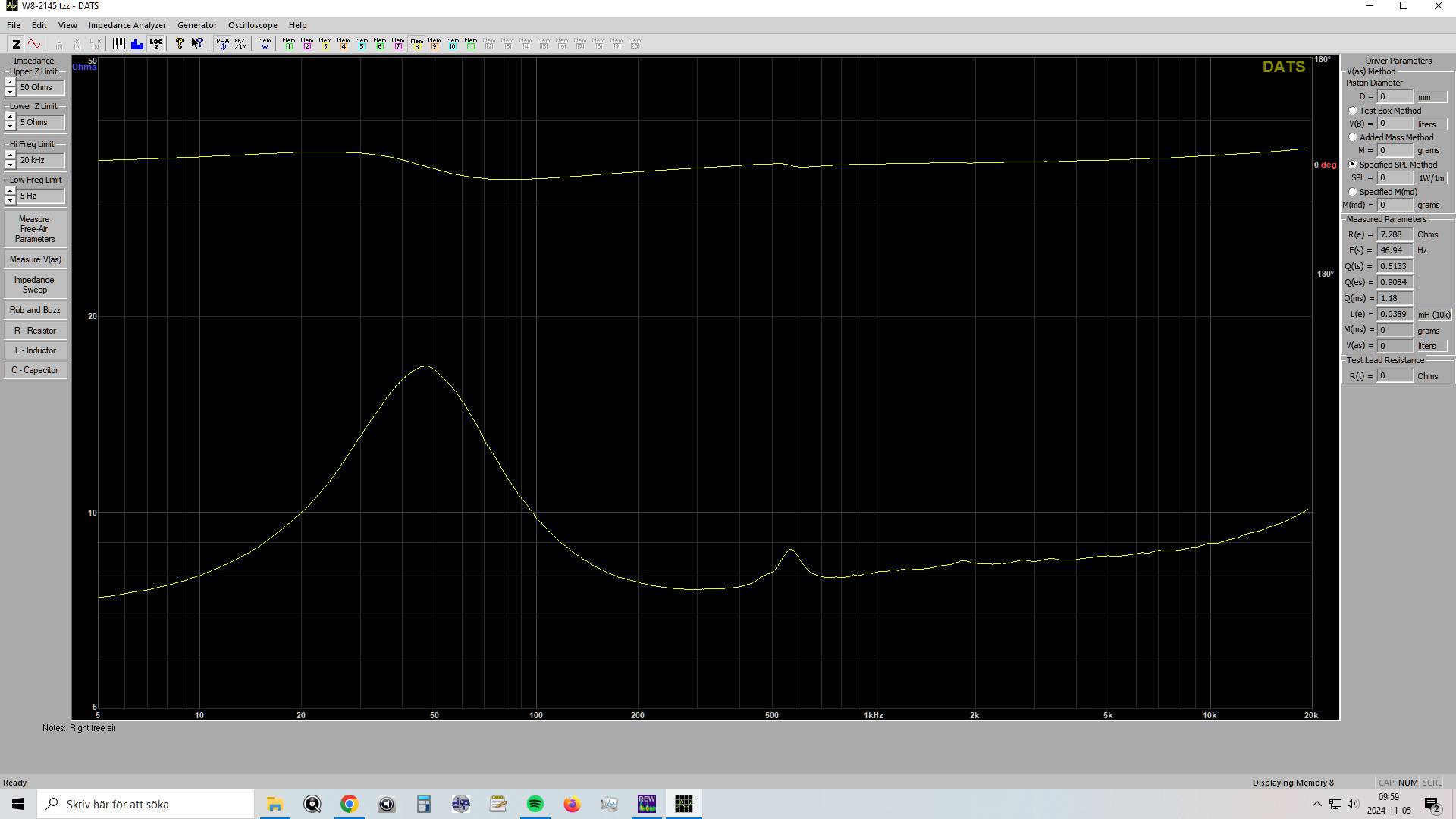

Anyone playing with these ?
I'm thinking 1 in a big .56 qtc sealed (when port stuffed anyway) as a center channel under my tv.
And yea, I've had 8" before and am well versed with their dispersion.
But couch wide, it should be fine for bringing out voices.

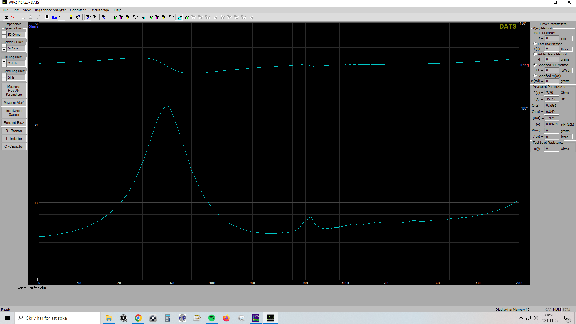

W8-1808 vs W8-2145
seems there is a lift in response past 1khz (above baffle step ?)
yet manufact freq response looks better than most 8's past 1khz (flatish).

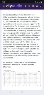

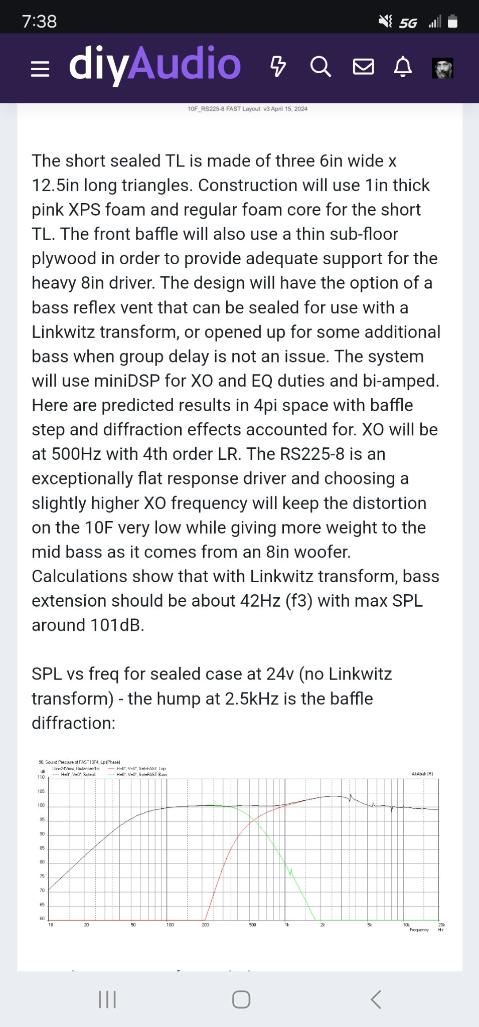

The popular rs225/10f project is basically a 2-way crossed at 900hz with a 6db crossover....

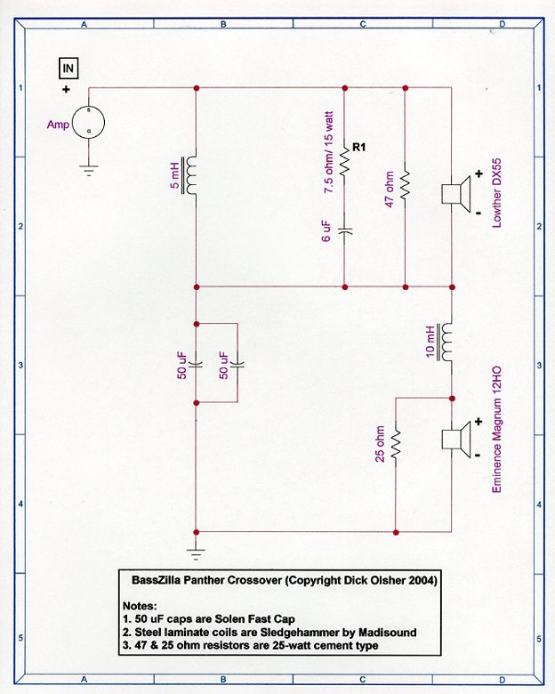

Basszilla open baffle actively crosses a Lowther dx4 6db/250hz, while the woof at 18db.
I don't know...Maybe his 2145 is run wide open and the woof runs up to 2.5k ?
Yup.
Actively?
Basszilla I know is passive.

1 of the basszillas is active.
https://www.blackdahlia.com/html/tip_56.html
A full range driver is its own thing, a balancing act between what you like the driver does well (to you) versus what you can tolerate it does badly.
Driver size, listening distance, room, setup, dispersion, music types, volume levels, detail, all sorts of variables....
Is a tweeter better ? Sure, but added cost, integration, losing some of the point source-ness.
Eq usually helps, especially mid-bass at low volumes.
