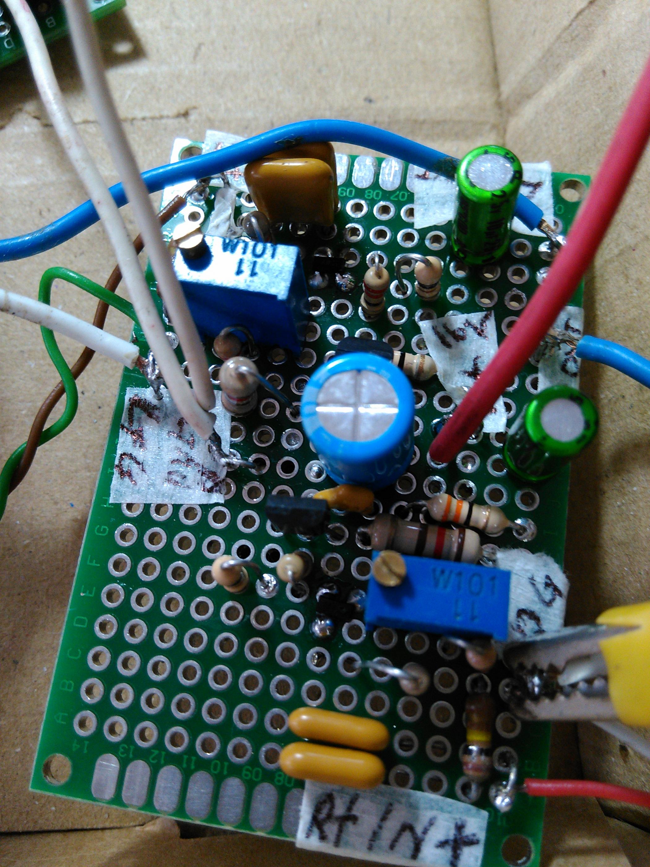

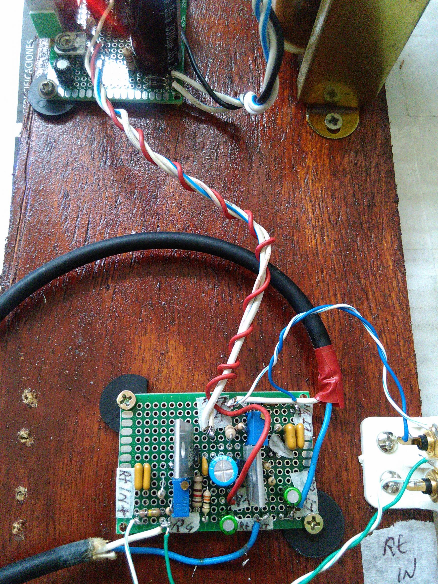

Zvn 4306 overheating
I built the circuit according to the schematic in the first poat. Manage to trim the voltage at source of zvn at 6.5v. Very nice sound but zvn is too hot to touch a few minutes after power up.
input voltage is 16 v .
ZV bought from element14
Any pointers to solve the problem?
Sure it is.... zvn is too hot to touch...
It is dissipating about 0.5W ((6.5/120)*9.5) so some sort of heatsink is needed.
You are using TO92 part and it makes heatsinking a bit more problematic. If you were using an SMD part that would allow for easier heatsinking (by using the large copper area on the PCB).
Nice work. Thanks for trying it.
Use a TO-92 heatsink or use SOT-223 and large copper plane for heatsink.
SOT-223 actually easier to solder than TO-92.
