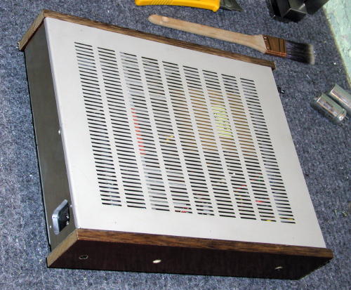

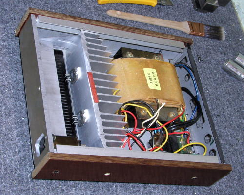

Peter Daniel said:I found an old amp, removed everything out except for transformer which is perfect for that purpose
What amp? so we can keep an eye out for them.
dave
Peter Daniel said:I found an old amp, removed everything out except for transformer which is perfect for that purpose, cut the chassiss in half and with few mods and additions I have a very nice chassiss. 😉
Mmm... what a smart guy!

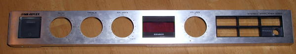

Peter Daniel said:An old Dyna Reflex, pretty nicely built actually.
Don't think i've ever seen one of those... shouldn't you be in bed... don't you have to go on holiday tomorrow?
