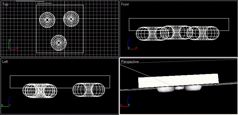

"I don't understand how the air platform makes any difference with a CD player."
From a previous post -
I'll Say It Again.......
"Another scenerio where damping could be seen to benefit is: without damping we get more vibration on the disk making the laser mechanism work harder to track the disk. This causes more noise and load in the power-supply degrading the analog section of the player."
Yup, thats what I said earlier on .
Additionally, digital power supply fluctuation causes modulation of the analogue waveform datastream slicer (jitter), modulation of the clock oscillator (jitter) and modulation of timings in the DSP chip.
Seperated power supplies for servo, digital and analogue audio stages pays big benefits.
Mechanical damping helps, but the electronics require attention also.
Eric.

What I would wonder is how, even though the table dampens vibrations travelling across the floor, the CD player doesn't vibrate from the sheer transmission of sound through the air, since he plays sometimes at full volume?😕

"What I would wonder is how, even though the table dampens vibrations travelling across the floor, the CD player doesn't vibrate from the sheer transmission of sound through the air, since he plays sometimes at full volume? "
Because when the cdp is isolated, the only acoustic energy recieved is into the cdp cabinet itself, rather than being coupled from an excited shelf, which represents additional acoustical coupled energy, and further elimination of resonances between the shelf and cdp cabinet.
