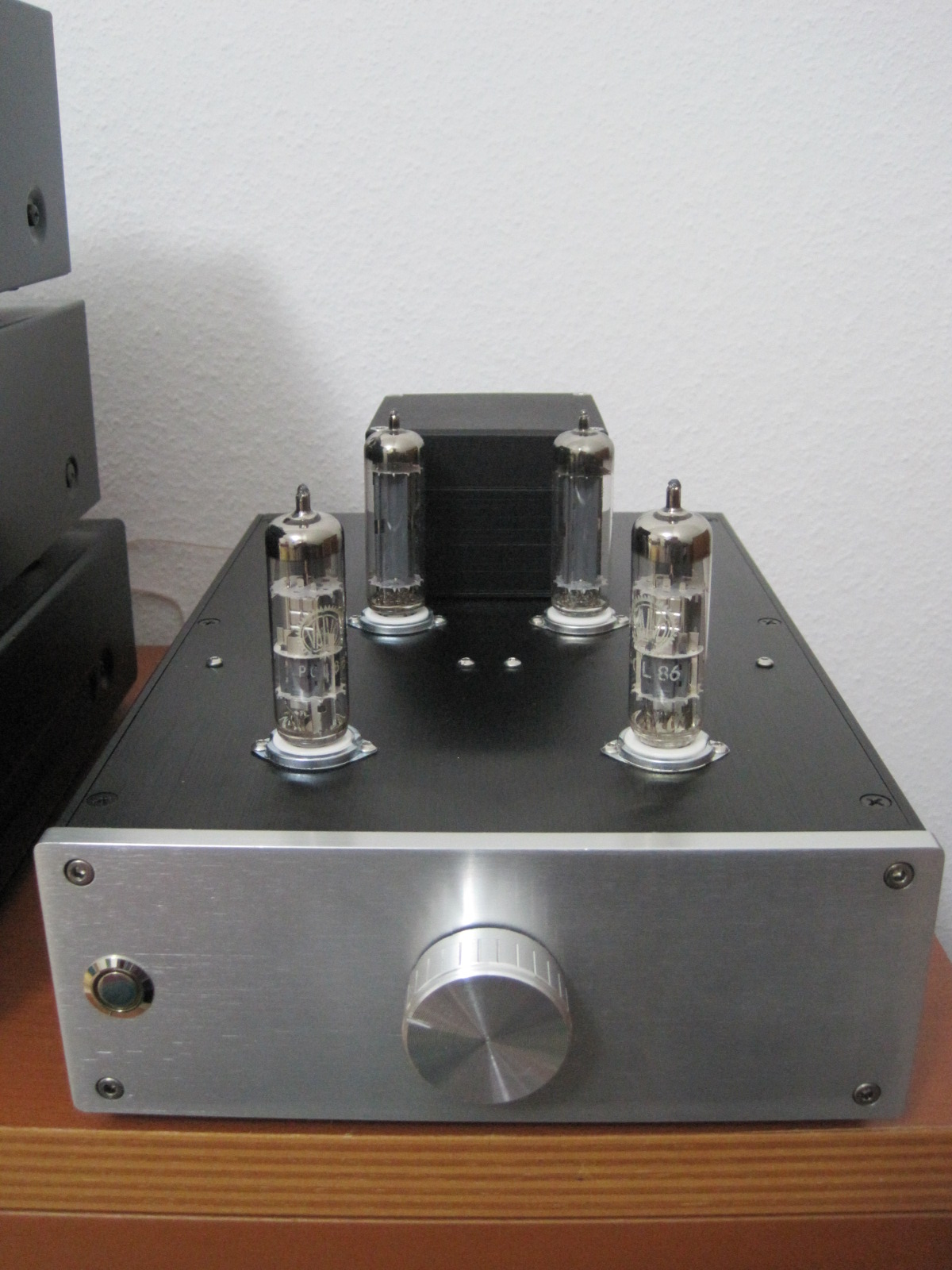

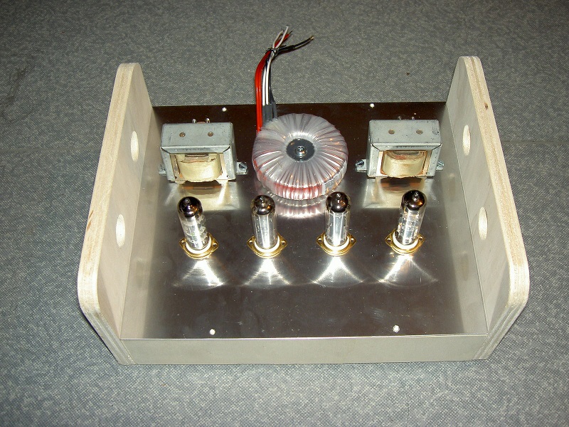

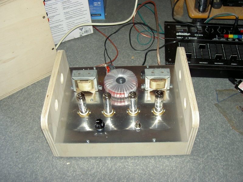

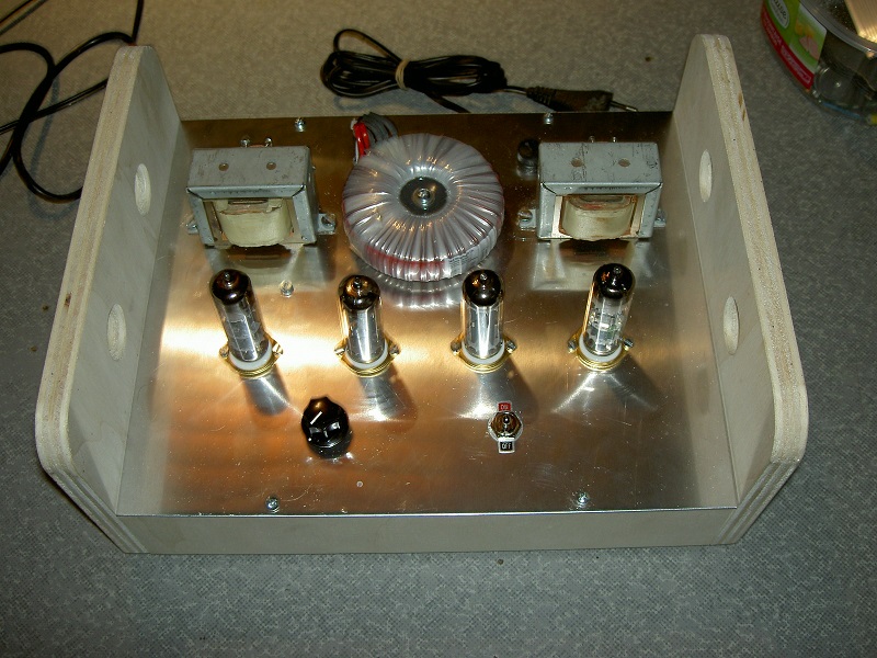

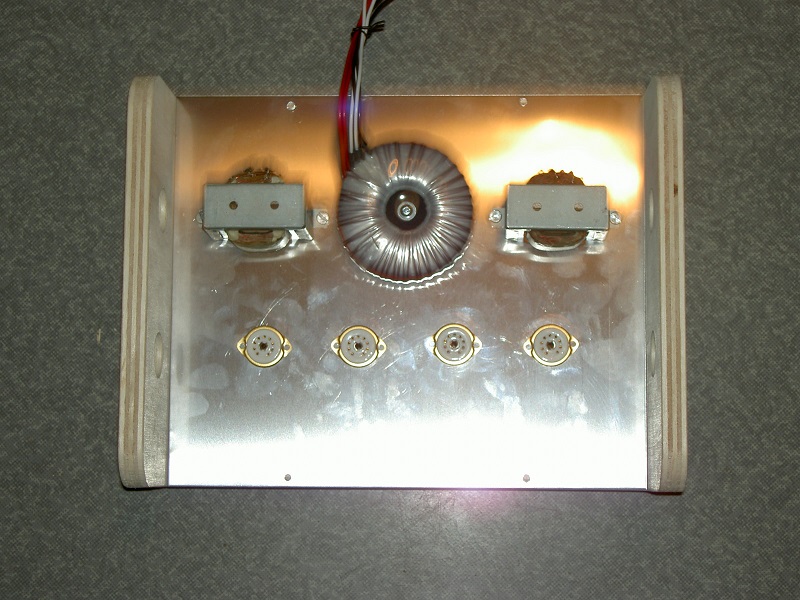

Hello all .
i started the small amplificator to ECL 86 and 2 EY82 Hybrid bridge ...
the look is Wood and Aluminium ...

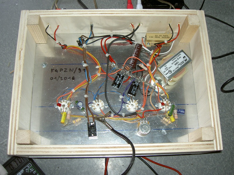

Hallo!
I am sorry to say that the cabeling of your amp looks a little "wild".
I wonder, that there are no problems with oscillations.
"Wild" wiring can be better for reducing oscillations because there is less coupling between the wires compared to tidy "loomed" bundles. It will also shorten the wire length if it goes directly point to point which may be an advantage.
The disadvantage is of course that it does not look good, and may be more difficult to fault find and repair

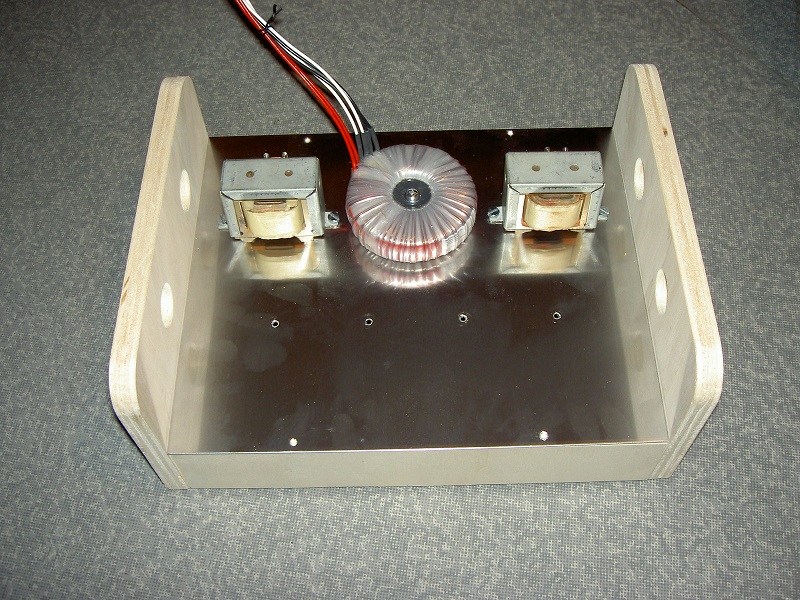

Hallo!
Thanks a lot!
I build a PCL86 amp about 3 years ago, using a "wild" wiring.
That causes very bad oscillations.
I was not able to solve that problem, so i decided to use this time very short cables an do erverything possible to do not get oscillations.

hello ,
me ECL 86 is based to old build to ECC 83 / EL 84 ...
the wire negative ground is connected to noval support and negative HT , i use maximum plane for good T° and not HF for wire to BF ...
the old ECC 83 / EL 84 for good build to 1960' ... so not problèm to oscillation HF .
