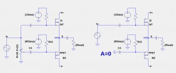

...I definitely like the SIT3X adjusted at the single-ended source-follower setting, where the M1 PFET is acting as a current source...
Have you listened with P6 set to minimum and R11 shorted?
That setting, where the A parameter = 0, would have extreme Schade feedback, equivalent to connecting the gate of M1 to ground thru a capacitor as shown in schematic #3 of post #134 The SIT-3X Amplifier. This would cause rhe AC current through M1 to be a huge multiple of the AC current through J1 and of the same phase.
I have listened to the amplifier with values if A (and X) below the point where M1 is acting as a current source, as described in post #247. As the value goes lower, H2 increases and the class-A power level decreases further.

Oops, I missed the effect of connecting C4 to ground with The CCS being a P device, now I follow 'A < A_M1ccs push/push SIT signature magnified', thank you for clearing that up 🙂

I looked further at what would happen with A=0 as you suggested trying. In that situation, the combination of M1, C4, and R13 will act as a capacitance multiplier.
