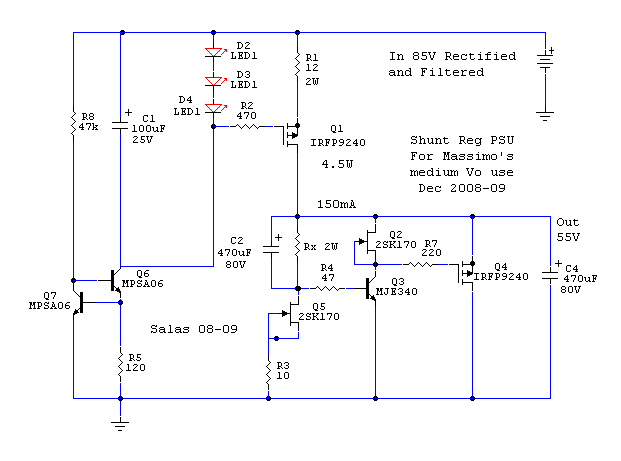

Dear Salas, what should I change in V1 (or V1.1) schematics (zener aside) to get a "medium voltage" version of your shunt?
I mean a regulator that can deliver 50 to 60 V for a 80 mA load.
Is a 60 V AC toroid too much? I can eventually use a CRC to drop some voltage.
