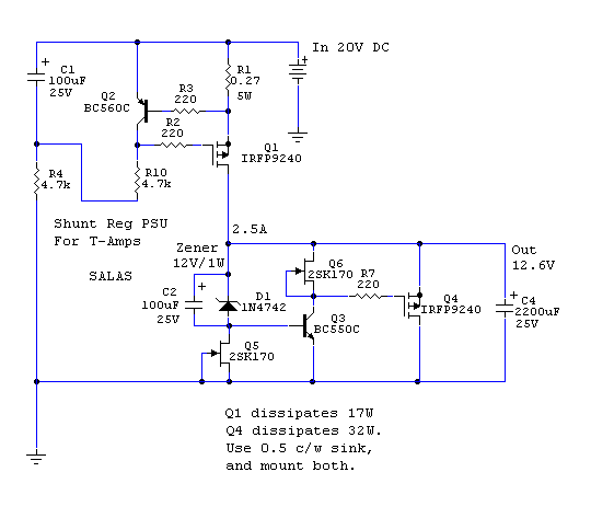

Does not matter much in the regs. Just find 2 0.1-0.3mA near ones for under the Vref, and about 1mA different around.
Sorry, I don't understand - do you mean that Q5 & Q6 in the attached schematic is OK if with 0.1 to 0.3mA of each other? mA range doesn't matter?
As long as they are between 6-10mA ie BL it will work fine. 0.1-0.3mA I care for same position jfets in symmetric regs. 1mA between Q5 and Q6 is fine. They are on other positions. Also 1mA is fine for the symmetric position of the led version njfet under the 3 leds to the left.

Does it mean I don't need to measure them before use and randomly pick up any to put in the board? or there are some that may be out of the desired range?

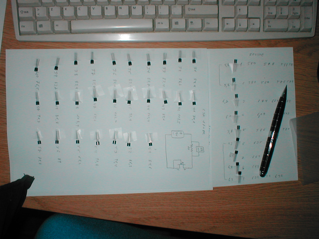

We said they must fall between 6-10mA as a pool to pick from. Each symmetric position must fall 0.1-0.3mA close. Between positions, 1mA is OK. In other words, you can peak 7 & 7.3 for those under the Vrefs in a symmetric, 8 and 8.3 for those over the driver bjt or vice versa and no problem. I believe you undertsand that you must note them after Idss measurement so to know what you have to pick.
Bill, I'd imagine that it is a good idea to measure them before use and pick close ones as they come in a range!
It looks worst then it is in reality.... Here you have a practical method:
First you measure each jfet and note it´s value and a ref number (123.....)
Then you input both values as columns in a excel sheet. (Remenber to name the first cell for Nº and the second one for Idss and input the values below).
Then you sort by the idss column and choose the pairs by their numbers.
Quite effective.
When you start building, You must measure the chosen ones again so you are sure there are no mistakes...🙂
Works like a breeze

I just write the idss beside each jfet - it's easy to scan 50 or so for close matches - don't need a computer. I can see excel being useful for large nos but I don't have the time for all that measuring 🙂

I read that MPSH81 (PNP) is to replace BC560C (PNP) in v1. This is for the neg rail. What is to replace BC550C (NPN) for the pos rail?
I will be building both. Iko, thanks for posting those schematics and simulating v2 for me. They are for 15.7V rails. I am using SOIC opa627s on browndogs and even the top one runs a bit hot on +/-15VDC and I can imagine the one soldered underneath the browndog may get less heat dissipation. So for +/-15VDC rails I prefer to go under instead of higher. I think I can use exactly the same schematics and component values you posted, only with the 1n4744 replaced with 1n4743 (v1), and 1n4737 replaced with 1n4736, to get about 13.6V instead of 15.7V, to reduce the heat on the opa627 for some peace of mind. Have you got an existing PCB design for v2? If not, I could use ExpressBCP to draw one in reference to the PCB layout of the existing v1.

-They are OK. (IRFP9240PBF - IRFP240PBF).
