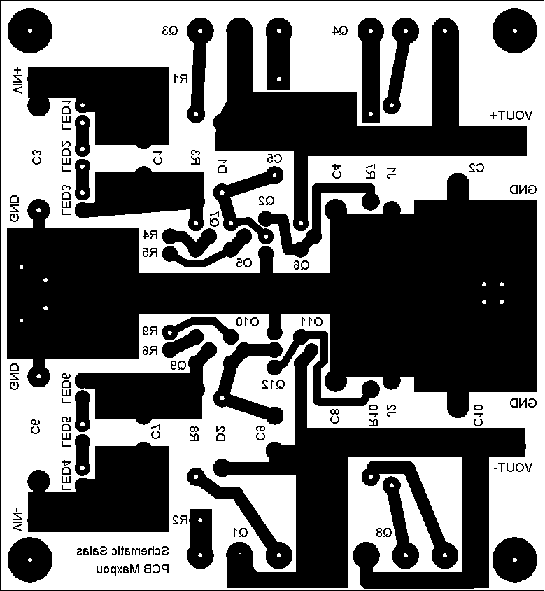

Hi Salas!
I draw the Salas shunt, And layout it for my DAC!
It is very good, the cricuit you can see!
Thank!
Hi Salas!
Thank!
I can not see! Thanks anyway! If you want me to see attach picture or schematic or both. Happy that you like!🙂🙂🙂
