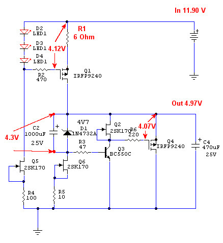

I am using 2 x LED + 1N4148 in series for 5V output. Less noise than Zener.
Shunting 225 mA, voltage output is 4.97V. Input is 12V. No oscillations so far.
shematic post #745.
@salas
Vgs for IRFP9240 is 4V. We are very close to margin with voltage reference at 4.3V and output at 5V.
Do you have any experience with MOSFETs with low gate treshold voltage?

The Vref is sitting on Vbe so it is 4.97V actually. It will be no problem if there is low input ripple, lower than 1VP-P which is normally much lower than that. Did you actually measure the Vgs of Q1? It tends to go lower than 4V at low tensions. Looks like 3.15V to me if with 5.4V CCS LED string and R1=10R, ICCS=0.225A. You applied it to a DAC already? If yes, sounds OK?
D1 as voltage reference 4.3V in my mind 😀
Measured Vgs of Q1 = 5.3V
I am thinkink of 3.3V output, for this I need MOSFET with low gate treshold voltage.
I will test soon. No working DAC at home this moment 🙄

stormsonic said:D1 as voltage reference 4.3V in my mind 😀
Weird number, are you sure that you did not measure Vds instead? Vgs is between pins 1 & 3.
4.12V/6R=0.68A. You said 225mA last time. Why you need so much current? Plus you show no Vgs measurements on your schematic.

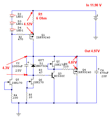

stormsonic said:oops, correct drawing
No. Please measure between R2 at the Mosfet and under R1 at the Mosfet for Q1. Also measure across R1 only. Let us know.

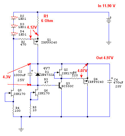

Values are correct, arrow is again pointing at wrong place
Voltage accros R1 is 1.365V. Value is 6.1 Ohm.
1.365V / 6.1 Ohm = 0.22377 A or 223.77 mA
Some thermal drifting, after 10 minutes voltage across R1 is 1.395, resulting in 228.68 mA.
Output is rock solid, always at 4.97V.

stormsonic said:
Values are correct, arrow is again pointing at wrong placeHope that drawing is now correct 😀
All that shows that the circuit is correctly working. What you want it for? Buffalo 32s again?
