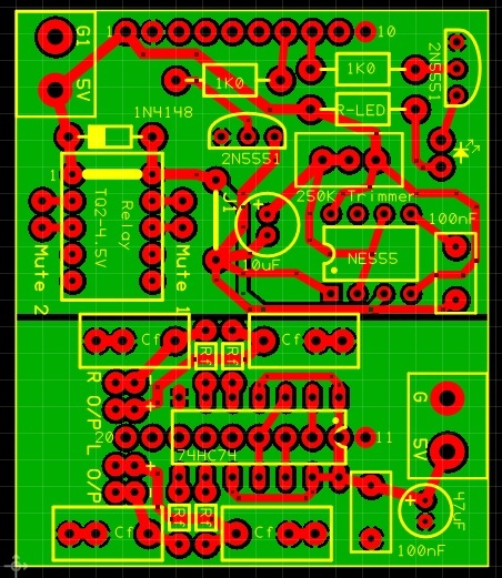

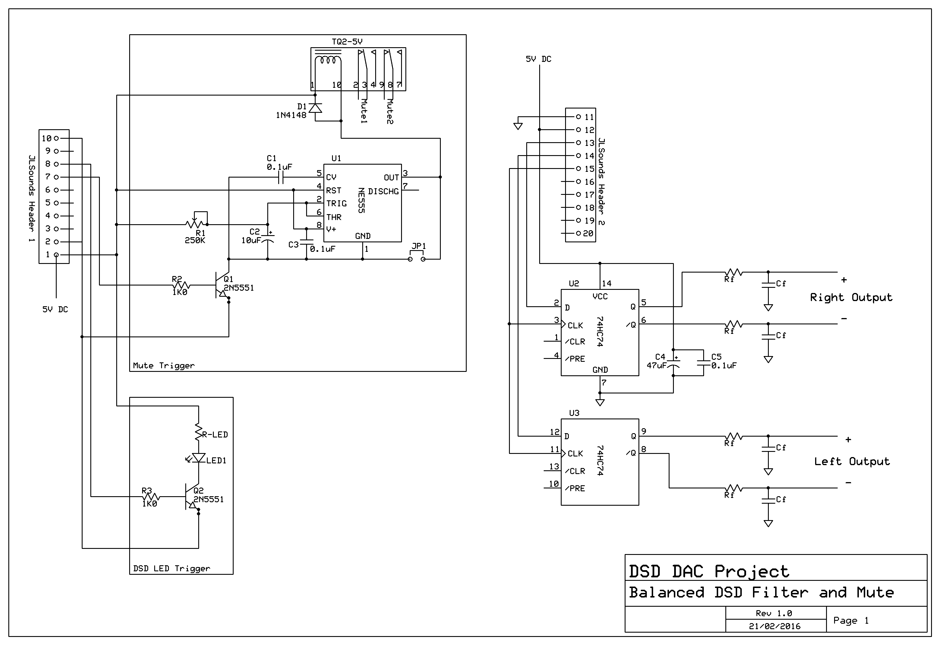

Salas I'm powering with Reflektor D a Flip Flop with LP filter to listen DSD without DAC but I'm getting high white noise mixed with the signal & I read some people is related to the PSU, that's the reason I ask your help.
Attached schematic of Flip Flop.
I'm only using the Flip Flop & LP filter, my system is Amanero USB-I2S + DIYINHK i2s ISOLATOR, Amanero is powered with BiB & the I2S isolator & the Flip Flop + LP filter is powered with the Reflektor D.
Actually I'm using only the LP filter direct from the isolator with any kind of noise and I'm very happy, I have tried Flip Flop to have more gain.
TIA
Felipe

I extracted some information from the thread "The best DAC is no DAC" http://www.diyaudio.com/forums/digital-line-level/273474-best-dac-no-dac.html
DF96 posted
In either case you need a good supply rail for them, as you are listening to the supply rail modulated by the final gate
benb posted
As far as terminology, the 74HC74 as used is arguably a "dual 1-bit DAC", and indeed a good power supply is critical because the PSRR here is 0 dB. Any variation of the 74HC74 Vcc line directly modulates the output.
peufeu posted
Of course since your DAC is basically a logic gate, and its output is the product of its power supply and the digital value, it means you have to use a balanced output... for example you can use a 74HC flop with normal and inverting output. It should have a very clean power supply...
DF96 posted
You will still get noise IM, as it is the supply rail which sets the voltage gain of the output stage. The rail must be very clean, probably cleaner than usually required for normal analogue stages. Normal analogue stages have their gain loosely set by the supply rail; this analogue stage (yes, it is an analogue stage even though it uses 'digital logic') has its gain set directly by the supply rail.

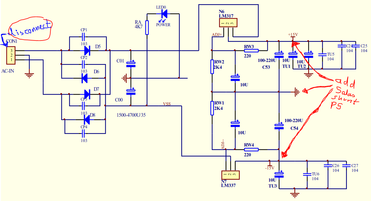

Hi Salas & others,
I would like to substitute the LM317/337 in a DAC with a Salas Shunt - just as a quick trial - without removing the LM317/337 in the circuit
If I disconnect the ac power to the LM317/337, leaving the inputs to the 317/337 'floating', and connect +15v/0v/-15 on the LM317/337 outputs, am I likely to cause damage to the LM317/337 or any unexpected / unwanted effects ?
diagram attached.
Thx !
