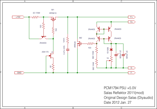

This is what Vgeorge configured at 5V for instance. (see post #6252)
What about this for R7
http://www.digikey.com/product-detail/en/MR1061K0000TAE66/MR106-1K-.01-ND/957482
MR106 is not potted I believe.Is there any advantage of using variable pot in this design?I have the George's design and the Reflektor design.One uses 10Volt and other 14 with some difference in componenents.Which one will you recommend Salas?Looks like top notch for axial and potted.
I wanted to mean covered in resin not naked like the sensitive VAR. If it does not have to be adjustable, a string of LEDs is better. George's is just a Reflektor with LEDs Vref, nothing more.
What should be the voltage source for Reflektor in Georges design. Can I just use a Transformer 11 Volt RMS out with a bridge rectifier and capacitor bank to make 14V DC to supply Reflektor. What if the line voltage goes up (there is always a chance of 10%variation)from 120V or it drops below 120V? Will Reflektor will maintain the Voltage out?
Yes 11 VAC RMS trafo will cover mains play if talking a 5V out Reflektor. The Vin-Vout difference will still be sufficient not to disturb it.
So what is the range of Vdc inut that would still output 5vdc with George's design. Which all components value change with change in Vdc input?
As long as you got >7V between the reg's raw DC in and its DC out even at worse mains drop it will tick in spec. It will keep its series CCS Mosfet breathing right.
Is there a maximum Vdc in for a given voltage out?

Max VDC in is mainly a matter of no wasteful dissipation. That 9610 CCS Mosfet can take 200V across it.
Each one Zobel values variation had a builder or an application that was tuned by/for. All work, its a matter of their taste. If you do George's config, follow George.
Mylar can be used, prefer PP quality wise.
Gate stopper, base stopper. Anti oscillation measures, shaping the very high frequencies.
Use 150R. They are near for what they do anyway. More important is you keep them on a short lead to the semi they connect to.
