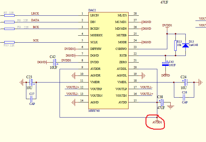

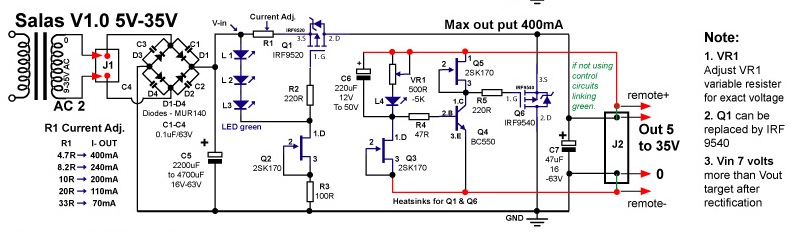

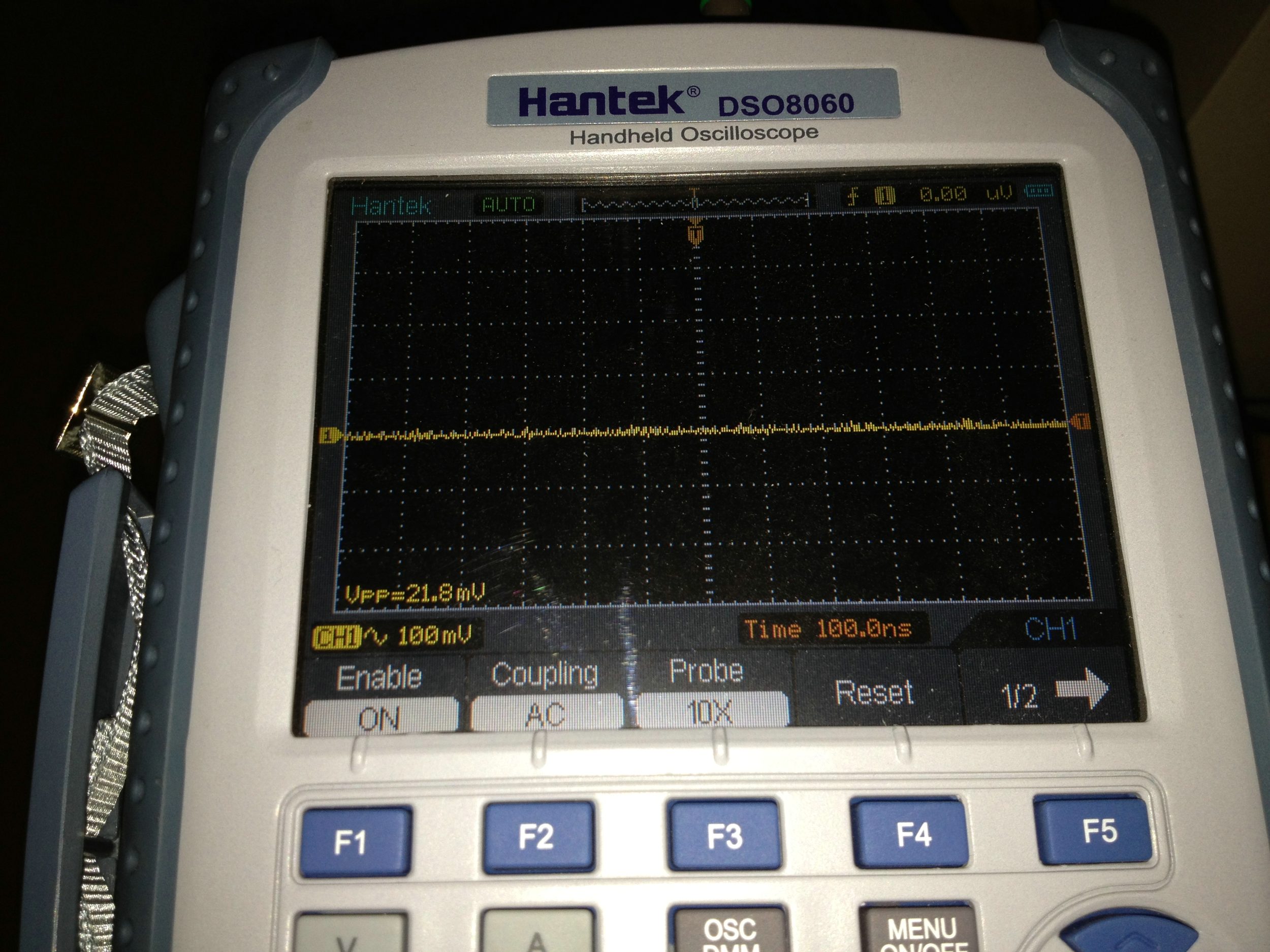

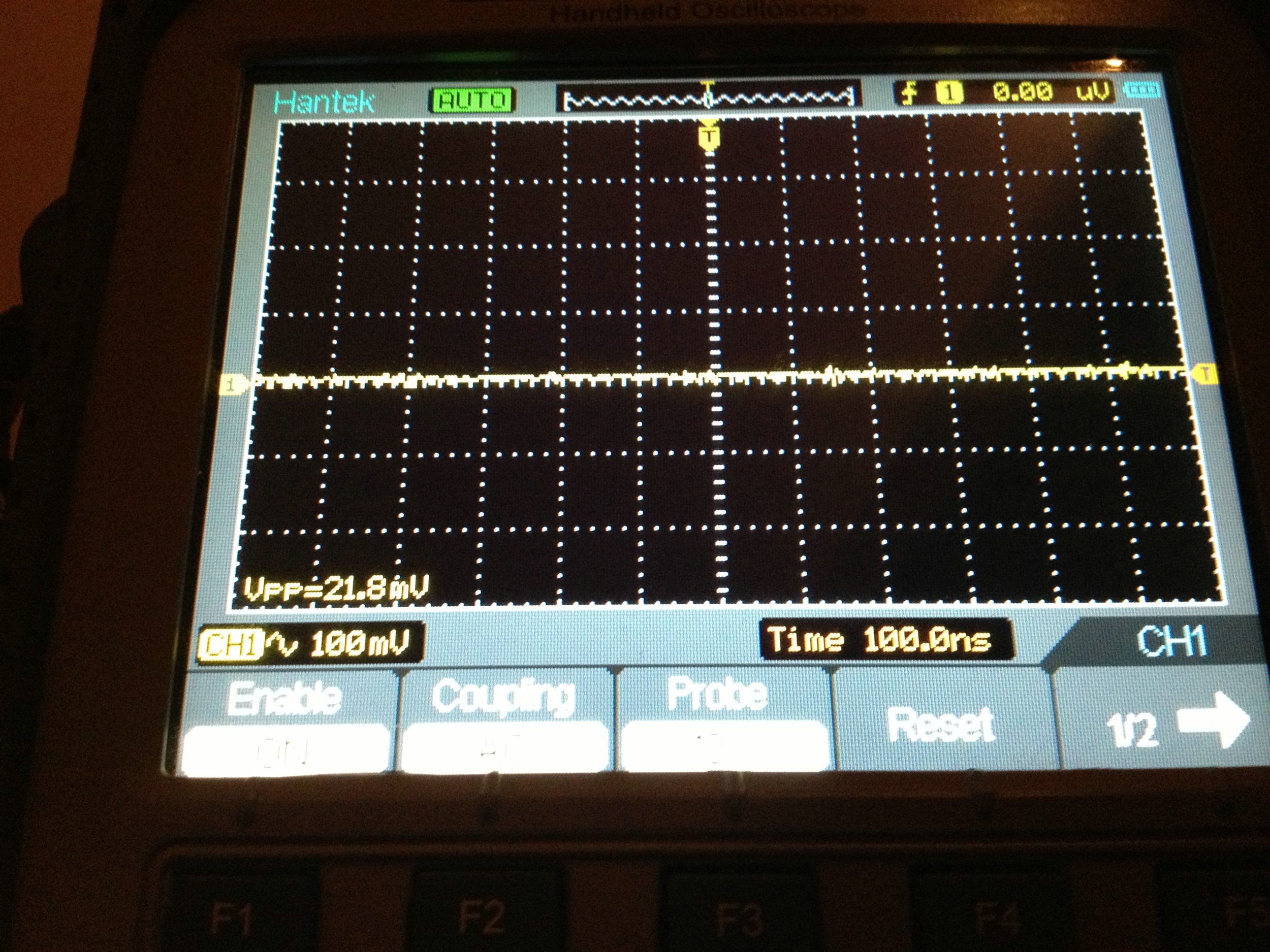

hi,
a quick question regarding v1.0 5VDC, I got 115mv pik to pik oscillations, is that fine?
They look like aperiodic glitches. No, not acceptable. Must be rid off. What exact circuit you made, and what is the load? Has anything extra parts on its rails? Is it a two wire PSU connection or 4?

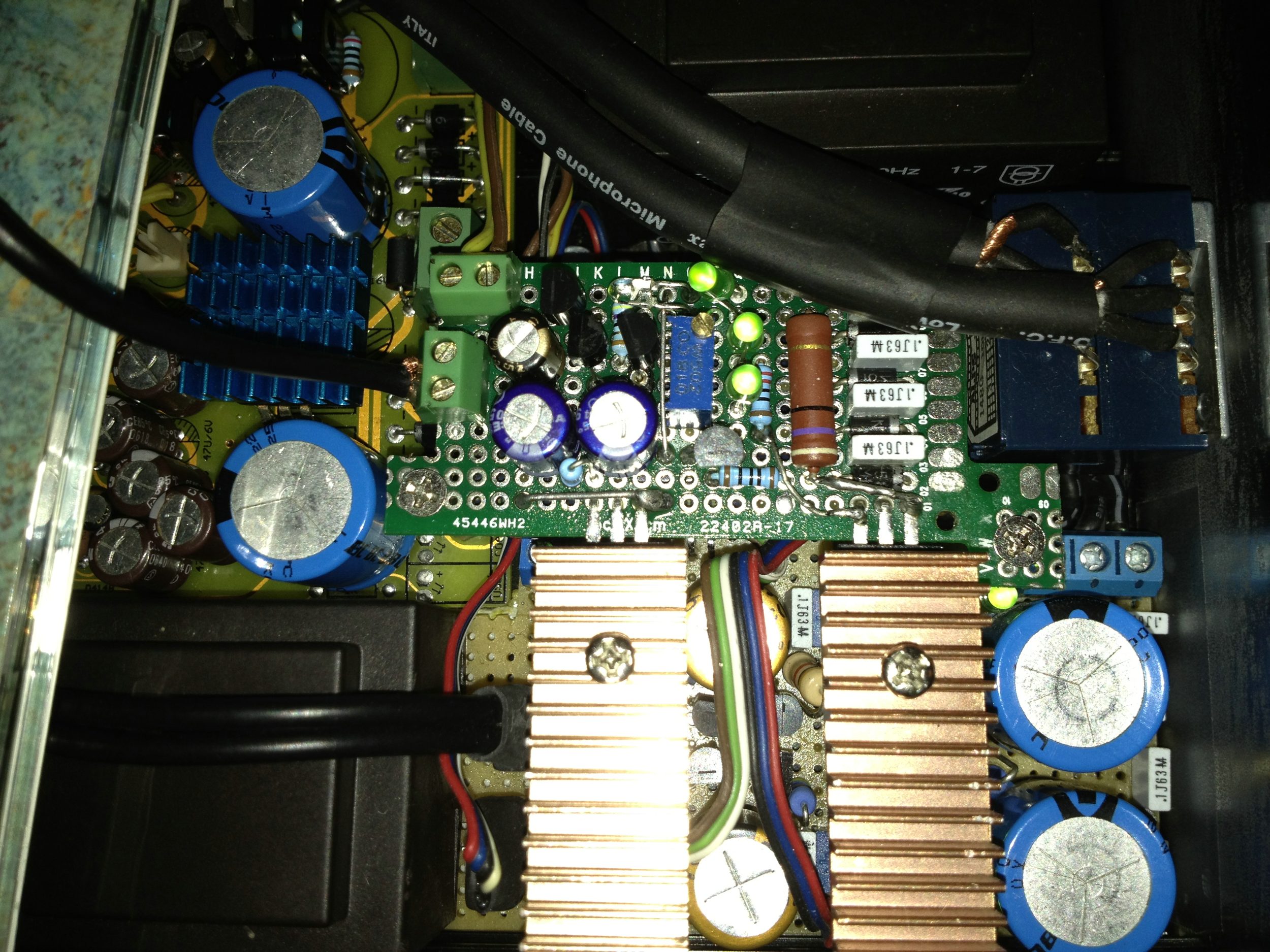

hi Salas,
1. it is 1.0 version with 47uf Tonerex on the output (att) & BF245A as Q3
2. the load is two Wolfson Wm8740 chips
3. no extra parts
4. about 5cm coaxial cable (two wire)
5. no oscillations if I disconnect the load (pls see att)
Could someone please attach a scope screen to see how a decent Salas shunt reg should look like?
It does not look you got a problem in your build, its stuff from the digital jumping on rail we may suppress better. What does the Wolfson have for rail to ground components where the 2 wires meet its board and beyond?
it has only a cap C38, the reg goes to 3 analogue supply pins only of the chip.
His scope does not show a periodic waveform, just glitches here and there. I would take the 2 wires directly on C38 and see what happens by making it bigger or smaller, preferably using Tantalum cap.
hi,
sorry for late reply. Tried to remove C38 and found out that I've already removed it when connected the reg, so it looks very weird now. Should I add it and see if something changes 😕
btw, there is another v1.0 shunt reg that works fine (no similar pics at all) and is connected to several opamps.

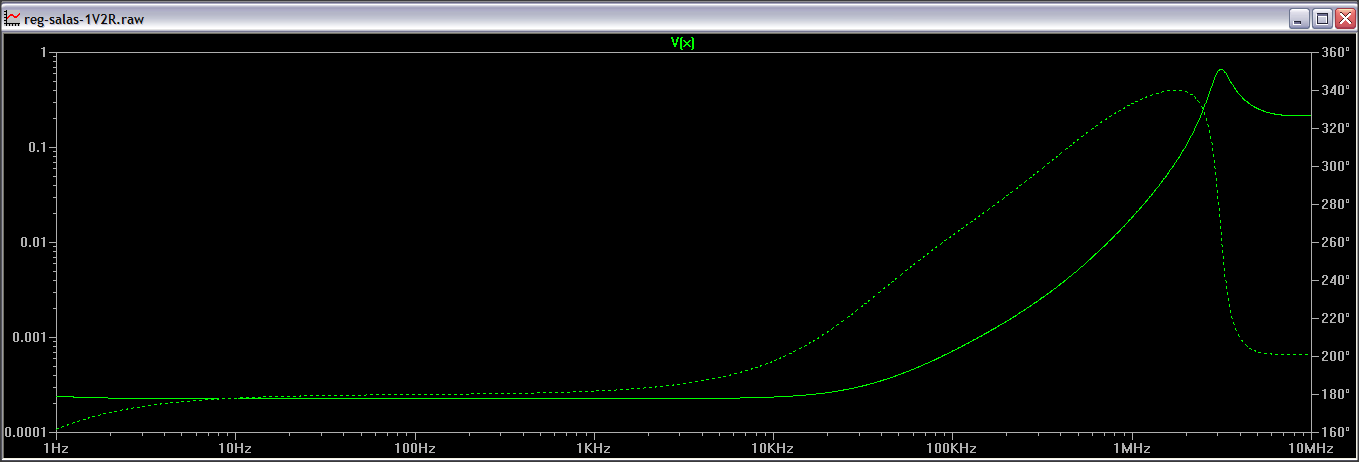

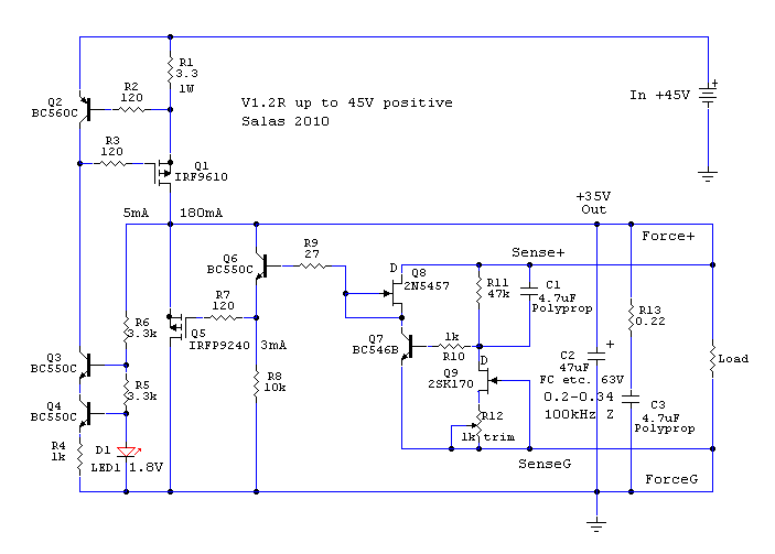

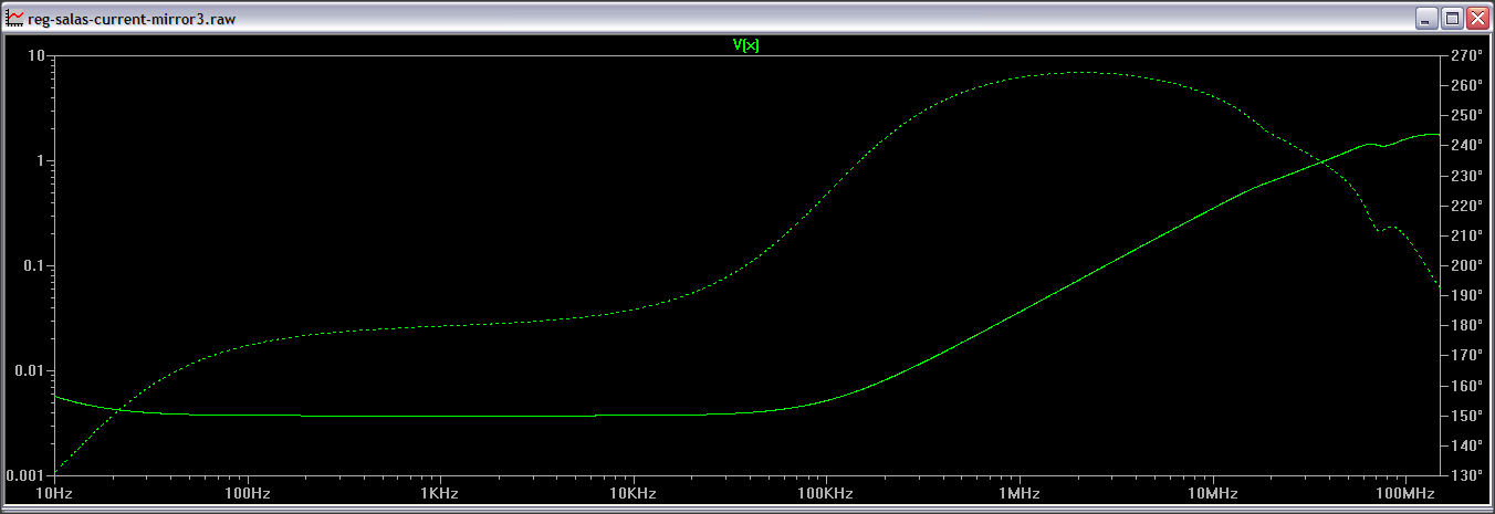

Hey Diy'ers,
I've been following this thread with interest on & off for some time now yet have not seen any measurements/discussion about the HF (HF output impedance, i.e. e.g. 200 kHz to ~10 MHz) response of the shunt regulator. If this has been discussed might one of you guide me to the relevant posts?
Greetings,
Jesper
Greetings,
Jesper
These are the sim curves for 1.2R and Reflektor (the two versions that fair better in that respect). A 1.1 reg was measured by a member on AP station up to 100kHz once and followed well, fairing a bit better than the sim actually. So the sims should be trustworthy enough.
