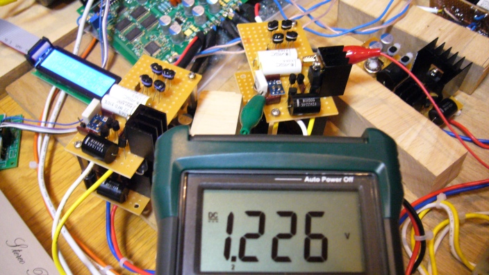

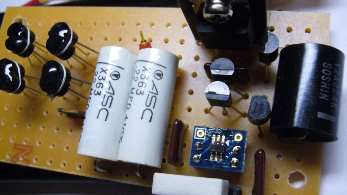

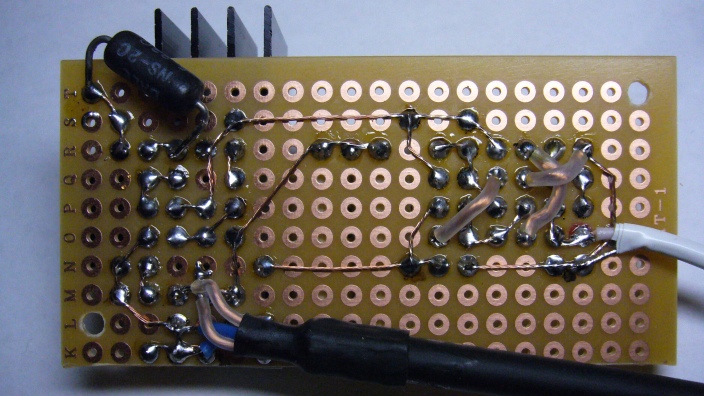

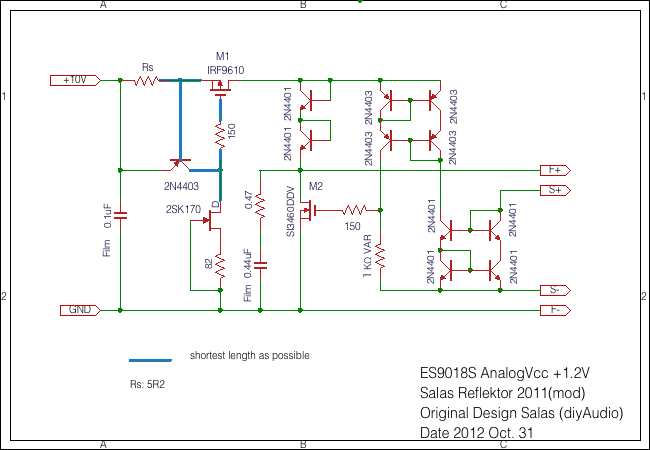

With joy I would like to announce that Reflektor +1.2V has come out.
Two big walls of threshold are overcome. Though I have no confidence to call this circuit pure Reflektor.
Last night I replaced old MOSFET source follower regulator, that is simple no-NFB type, with new Reflektor in my Sabre DAC. The sound has changed dramatically far beyond my expectations. Quoting Michael Elliott's words, "this one left us with dropped jaws". It is my impression.
Zobel is same as Reflerktor +3.3V, I have no need to change.
You doubled circuitry the other way around to give it several Vbe threshold. Excellent solution, if it MUST be 1.2V and Reflektor. More circuitry but what the heck, still a Reflektor! Congratulations. MOSFET is not still the logic level STP?
Thanks Salas. I am encouraged.😉
Shunt MOSFET is Vishay's SI3460DDV which I happened to find via search engine. I think it has good spec regarding to low Cxxx, high gfs and very low Vgs. For TSOP-6 package, need surface mount adapter.
For that purpose OK but to generally sink it, plus the dioded 4401s dissipation roof, small current stuff. How hot is it now for how much current you spare through it?

I was worried about same points before making.
In my case constant current is set on 115mA, and the current of target board is 10mA. MOSFET is running without heat sink. Touching finger, temperature of 4401s and MOSFET is a little bit warm.If more current is needed, they must be changed to another one which is more power dissipation.

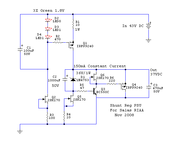

Hi all, I want to supply the input, VAS and pre-driver stages of a class A amplifier with + and - 37V using a Version 1 regulator. The DC voltage I have after rectafacation and filtering is + and - 51V. How do I calculate the value of R1 if I require 250mA ( or any other current ). Also at a later stage I may use this supply for the drivers where more current is needed if so would it be OK to select R1 for this higher current even if initially I do not require it? I appreciate that the shunt transistor will dissapate more heat .

If you mean a post 1 like arrangement then Iccs=Vbe/R1. Using 100mA or more spare helps for lower output impedance. Its more about how much thermal burden your sinking and your consumption scheme may allow.
your +-51Vdc is likely to rise to ~+-53Vdc worst case mains voltage.
This combined with 100mA for the CCS will dissipate a worst case 5.3W in each CCS mosFET if the output gets shorted.
Decide whether you want the mosFET to survive this worst case scenario. Then select the heatsink appropriately. If you go for this "survivability" and the heatsink is isolated from the chassis, then the FET can be bolted/clamped direct to the sink for lowest Rth c-s.
Vr1+VgsQ1 = Vledstring.
Arithmetic/algebra allows you to re-arrange the equation (or equality) to:
Vr1 = Vledstring - VgsQ1.
Vr1 also equals the current through the resistor times the resistance of R1, i.e.
Vr1 = R1 * Ir1
and re-arranged to give
R1 = Vr1 / Ir1
Put that back into our earlier re-arrangement and we get
R1 = [Vledstring - VgsQ1] / Ir1
You need Vledstring and VgsQ1 and Ir1

Put these into our equation and we get
R1 = [5.7 - 4.0] / 0.1 = 1.7 / 0.1 = 17r nearest e24 value is 18r.
Adopt 18r, or 20r, or 22r, or 24r, or 27r, or 30r, or 33r, or 36r.
That now allows you to directly measure that guessed at voltage of 1.7V across the R1 resistor.
Once you have that voltage you can calculate the actual CCS current.
If it's not big enough, then ADD second resistor that gives the extra current you want to give a total CCS current ~ =100mA.
Again lets suppose you measure 1.71Vdc across a 24r resistor in position R1.
CCS current = 1.72Vdc / 24r = 0.0716666 repeating ~ = 72mAdc.
You need an extra ~28mAdc (=0.026Adc).
1.72Vdc / 0.028 ~ 61r4.
Adopt 62r (nearest e24 value).
add this in parallel to the R1 already installed.
Remeasure Vr1. calculate the new CCS current. Is it close enough to your target?
