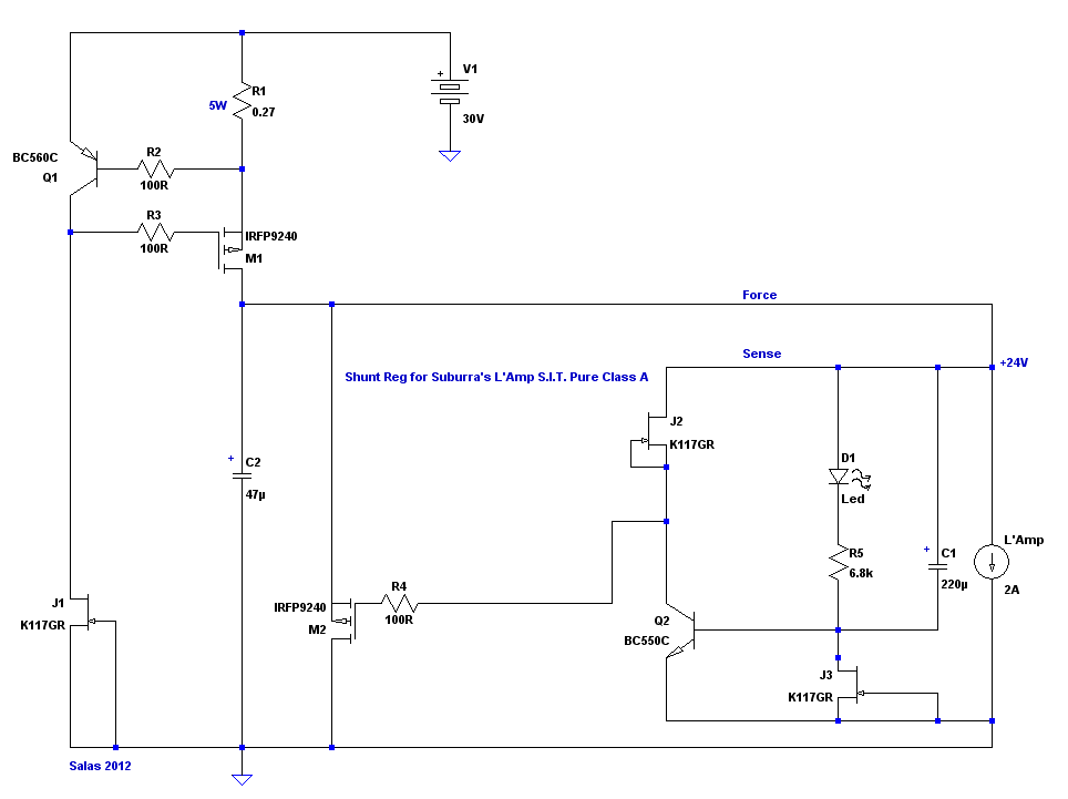

Hi Salas
Could you help me, please.
I'm building L'Amp
Grazie mille
Marco
OK, will investigate and reply you a circuit.
Here is your circuit. Get some Toshiba 2SK117GR, measure their IDSS. Use just a little above 3mA for J3, pick from lowest IDSS group in your batch for J1, and from highest for J2. For C2 get one with about 0.3 Ohm ESR. For C1 the best electrolytic you like subjectively. M1 is going to dissipate around 14W, M2 around 6W. Don't test without 2A load, in that case M2 is going to burn 55W!
Salas
Thank you very much!!
Some questions:
Flter capacitor, it'ok 10KuF ?
Diode, i have Ixis soft recovery 10A/1000V , are good?
And last, dummy load, 10R 30W it's suffice?
Marco
Salas
Some questions:
Marco
At that current 10mF//10mF is better so to divide ESR and up the ripple current rating. Diode you got OK, but sink it. 12R 50W on sink dummy or the amp itself.
