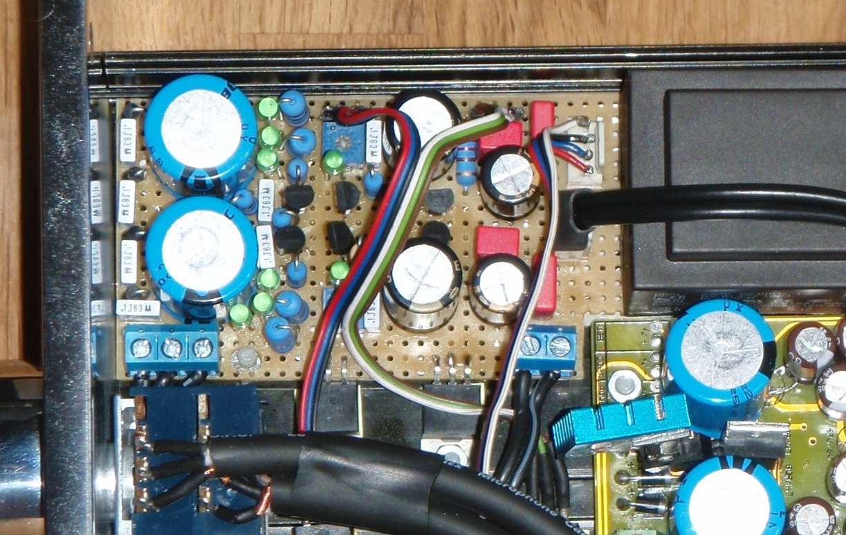

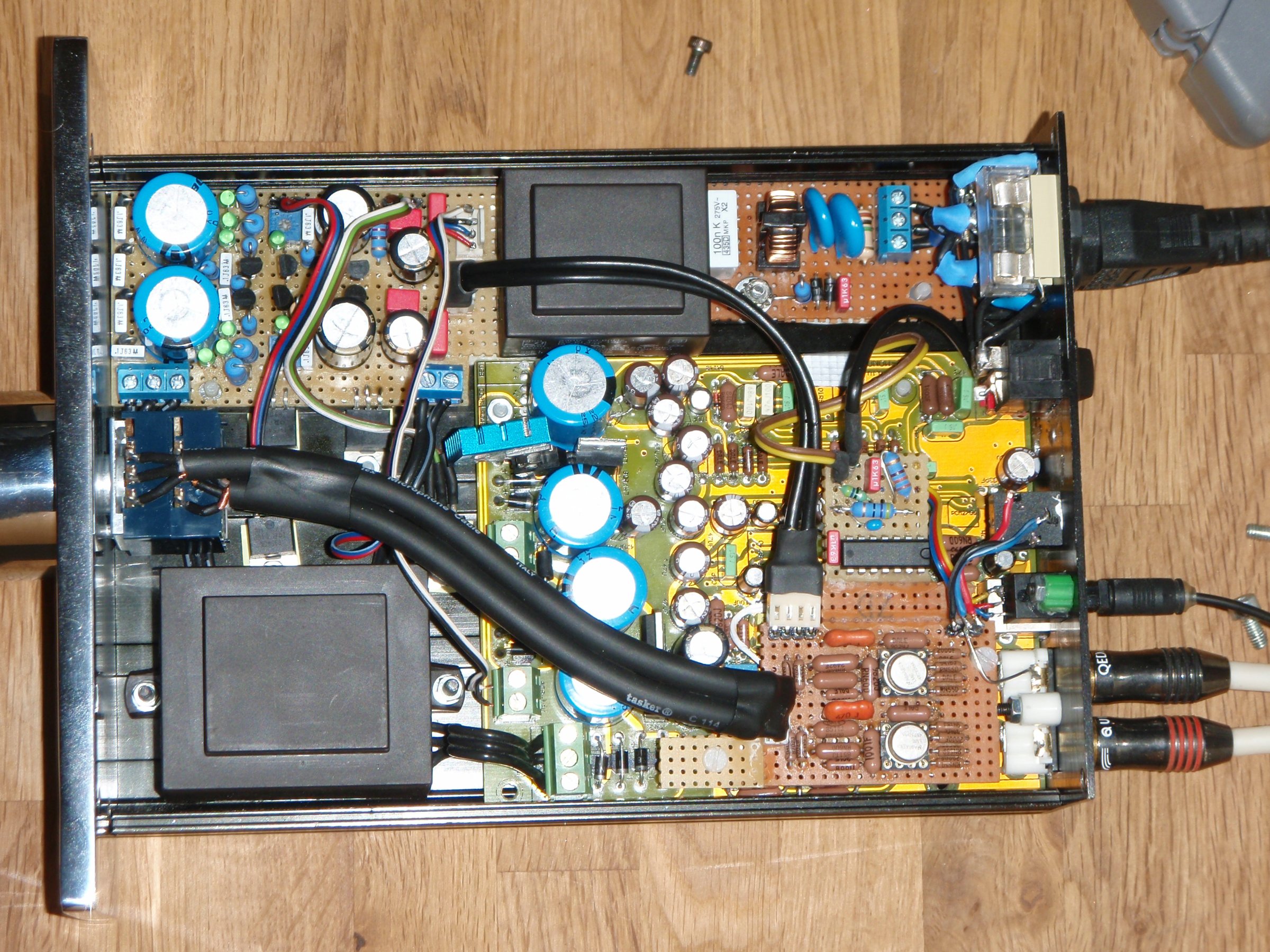

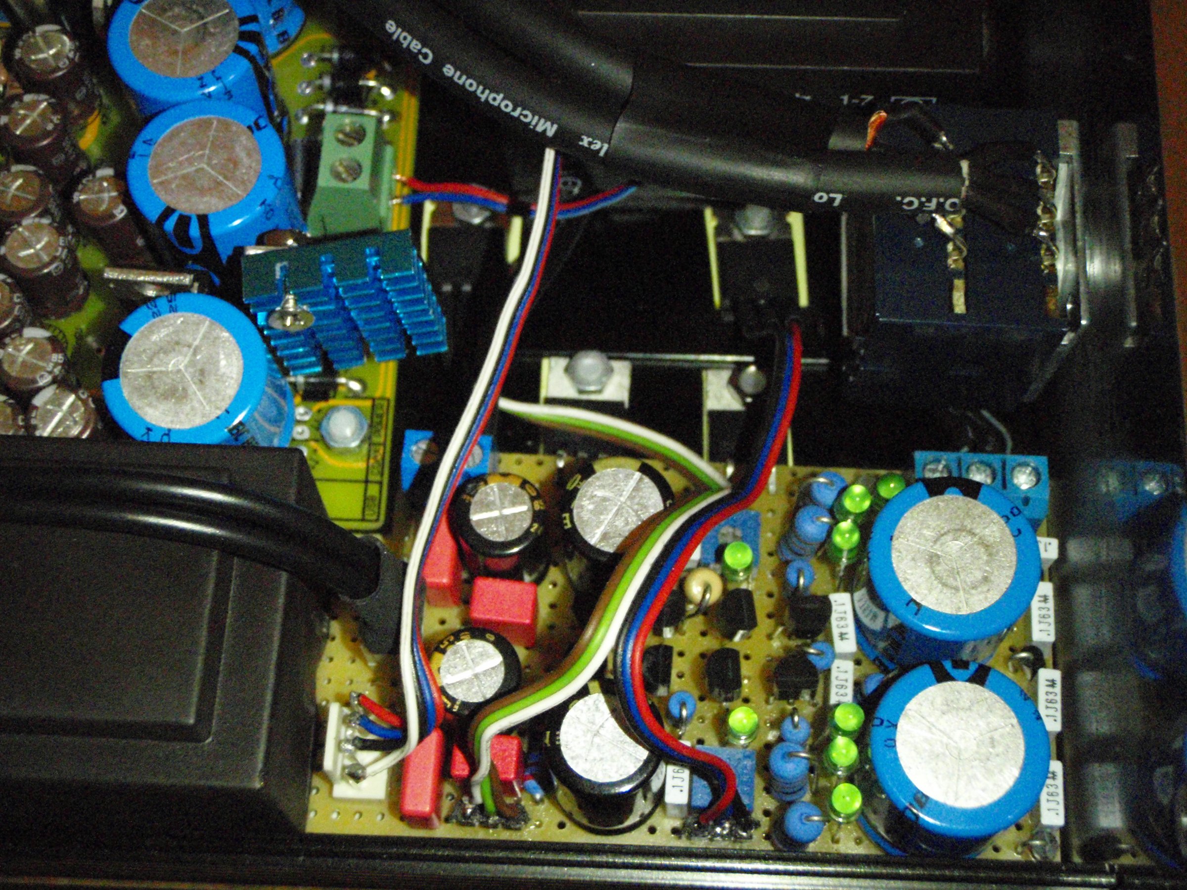

Its more about ambient temp it seems. Having the IRFs near the BCs and SKs says that. If the junctions aren't the cause and the case temps aren't 70C it wont give a damn.
yes, it seems like that as the majority of all components gets as hot as >50c. Even blue BCs show about 52 degrees. I know the design is not the best, but there was really no space in a tiny box I had (plss see att.) 🙂
By selecting R1 of 16ohms, there should be a current of about 150mA that is far enough for feeding preamp based only one LME49710HA per channel, isn't it?
Sure it leaves enough to keep the reg flexing. Did you get any audible difference powering the chips as such, or you did not have a different reg on them anyway?
frankly speaking haven't compared 7812 & 7912 regs that are feeding DACs output opams (49710HAs as well, I like them) with shunt for preamp. However the 1st impression (CD-> trivial preamp on just 2x 49710HAs + shunt reg -> headphones) made me shocked, so damn good it was 🙂
here is the overall picture of the overcrowded box (not finished yet, wires to 3.5mm socket will be replaced, pre and output RCAs for preamp will be added). I was thinking of replacing 7812 & 7912 as well with 2nd shunt reg, but seems that it would be simply impossible due to the lack of space and additional considerable heat.

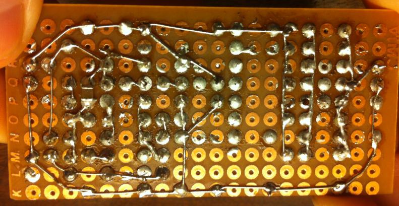

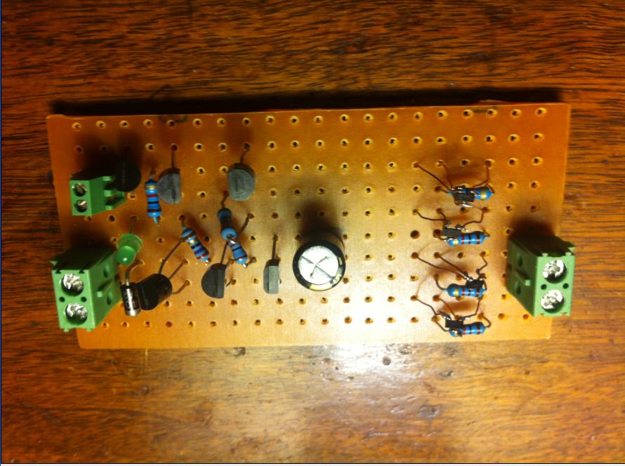

some pictures! (salas deserves lots of them 🙂)
first two is,for experimentation purpose, a modified version of sslv1.2 3.3V with a jfet instead of...r6? and 4 bf862 paralleled as the ccs. also the shunt mosfet is zvn0124a. the whole thing l fed by batteries. i did have some oscillations with no gate resistor for the bf862 but now it s fine. the jfet instead of r6 sounded not very natural so i eventually replaced it by the said resistor as per schematic, but the jfet ccs with batteries gave me transparency like never before. it s not even funny🙂. i also tried it with the 1.1 and it works fine also.
build at your own risk though....🙂. i used it to feed an es9022 for those interested.
if there is one thing i noticed out of trying different parts in this shunt reg is that low capacitance parts are of prime importance in sound quality for 3.3V in dacs.the SSLVV1.2 CCS also benefited from having a zvn3310a in another low current reg i made for clock. it s just too bad these are available in to-92 only...
on a more general note, i found out it is way more convenient to p2p on a larger pitch board like this one than a .1 inch board.

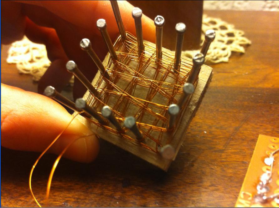

next, DIY resistor,
i used it in CRCRC... filter before SSLV1.1. it is made of 32ga copper magnet wire. for clock duty and i gain loads more detail and smoothness compared to MOX or even metal film. the thing is that it did not sound balanced. seems like digital supply dont like too much this kind resistor. maybe i ll try it later in something analog to see if it sounds more ''right'', or maybe the problem is the winding technique or even the concetpt itself...
i can show how i winded it if someone is interested(RCRUZ?🙂).

The R6 for CCS substitution I had tried back in the inception days and I did not like it too. Low capacitance Jfets main CCS is great if making for low currents. Its just so much quiet and fast using high gm low noise parts. As for pre-filters, members always rated CLC high instead of CRC. If for resistor, they rated thick film high in DCB1 over MOX. Your findings ring valid in other words. Post a schematic with your parts of choice and settings for the low current TO-192 nice cute mini 1.2R if you may, there are many members who want for a clock, opamp etc.
