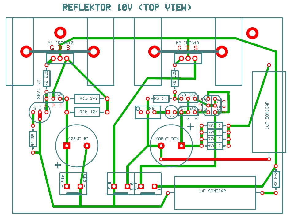

With a lot of help from Salas, I have just built myself a 18v Reflektor. Now powering a DAC and let it run in a bit before listening. First impression is not bad at all 🙂...
Please let us know your component´s choices and layout.

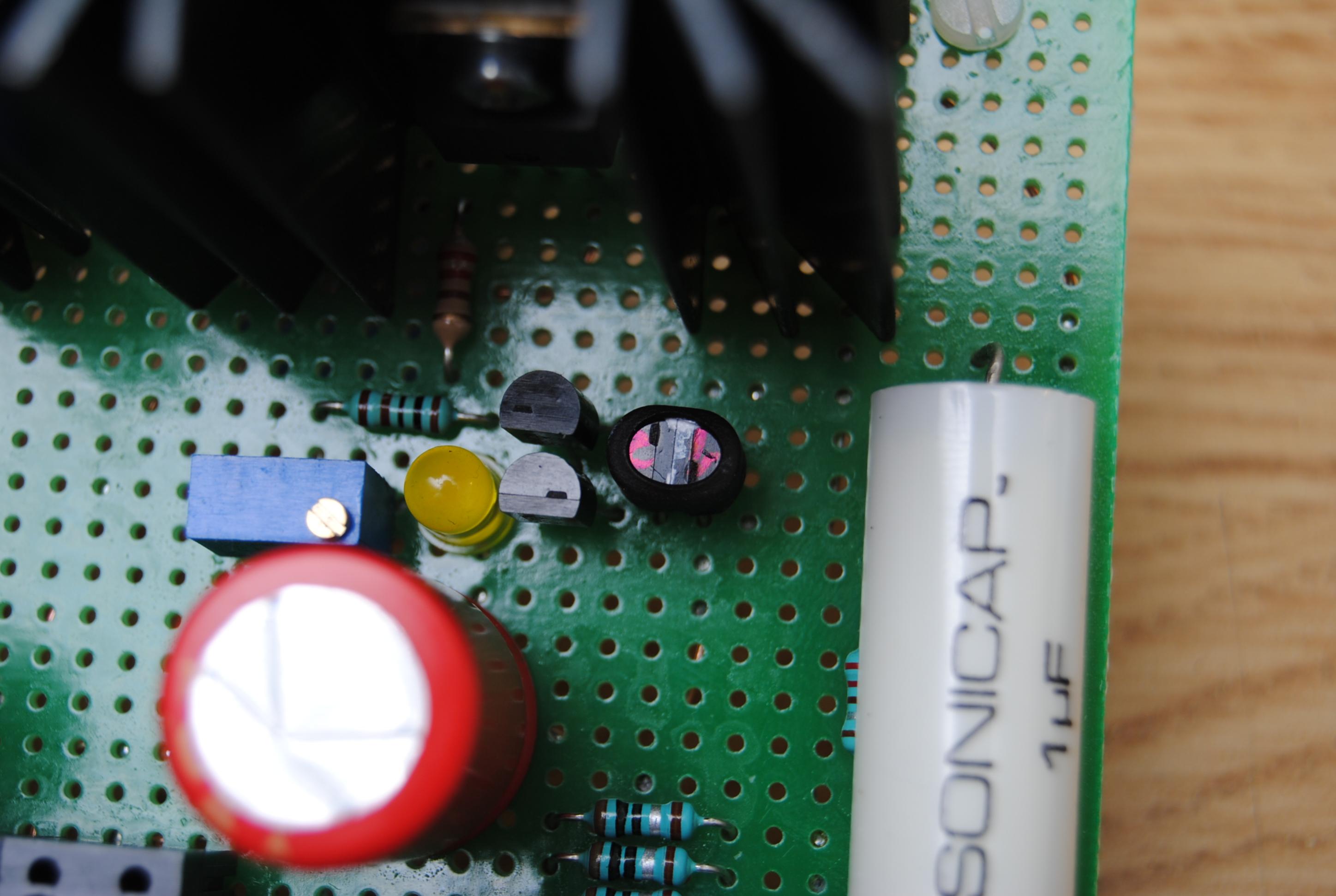

...apart for thermal traking I think that the Current mirror transistor need to be thermaly coupled for better traking I mean goop and tie wrap so new lay out tomorow

R11 and R12 are in the V12R sorry for confusing.
In the Reflektor, Q1 and Q2 should be tied together face to face. Q1 Q2 and Q3 should be matched for close hFe.

Tanks I have noticed qiute a bit of voltagge drift on a 450 Homs dummy load my current lay out will need to be changed.
Wuld it work better if all 4 the transistor in the mirror are tied togheter?

You should not see much voltage drift from a reflektor. Don't tie the 4, they work on different temp some of them. Q1, Q2 only. Try for Q1,Q2 best match on vbe, hfe. Try follow them for hfe in Q3. Also see if there is an issue with trimmer quality if using one instead of a resistor under the LED.

My layout is not acording to the latest Salas schematic. It was an experiment... I only posted it so you could see the transistors layout.
Yes.. sometimes trimmers are faulty... they may be the cause for noise and voltage drift.

...And there are a lot of fake Bourns 3296 out there, which are carbon film instead of Cermet
The problem I think is cermet or plastic trimmers have a positive tempco, whereas carbon film ones have a negative one..... This can be a problem in some circuits for example if they're used to control shunt current : the less resistance, the more current , the more it gets hot, the less resistance, etc.....)
This is even more of a problem if you are running them close to the limit (I think 500 mW) especially if you're using only part of the resistive element surface to dissipate the heat (roughly when you're at 50% of the wiper position, you can only dissipate half the power rating, so the thing gets really hot...)
I had that issue on the Shunt regs from Twisted Pear... the trimmer is somewhat undersized, and with trimmers which I discovered later were carbon film, I saw the shunt current dangerously (slowly but surely) increasing, until I replaced it with a fixed resistor....
think of a pot or trimmer as having a current limit rather than a power limit.This is even more of a problem if you are running them close to the limit (I think 500 mW) especially if you're using only part of the resistive element surface to dissipate the heat (roughly when you're at 50% of the wiper position, you can only dissipate half the power rating, so the thing gets really hot...)
eg.
500mW 2k trimmer. Maximum continuous current I = Sqrt(P/R) = Sqrt(0.5/2000) = 0.0158A = 15.8mA.
That is the manufacturer's maximum recommended current to give specified life and specified performance.
Many including myself recommend continuous operating power at substantially below Pmax for certain performance and reliability advantages.
For resistors, including trimmers, I suggest <50% of Pmax, but lower limits are preferable to some designers/builders eg. 25% or 10% and in some critical locations.
For a 50% of Pmax limit the current must be reduced by a factor of sqrt(2).
That 15.8mA must be reduced to 11.2mA. No part of the trimmer can pass more than 11.2mA if you restrict your maximum rating to 50% of Pmax.
