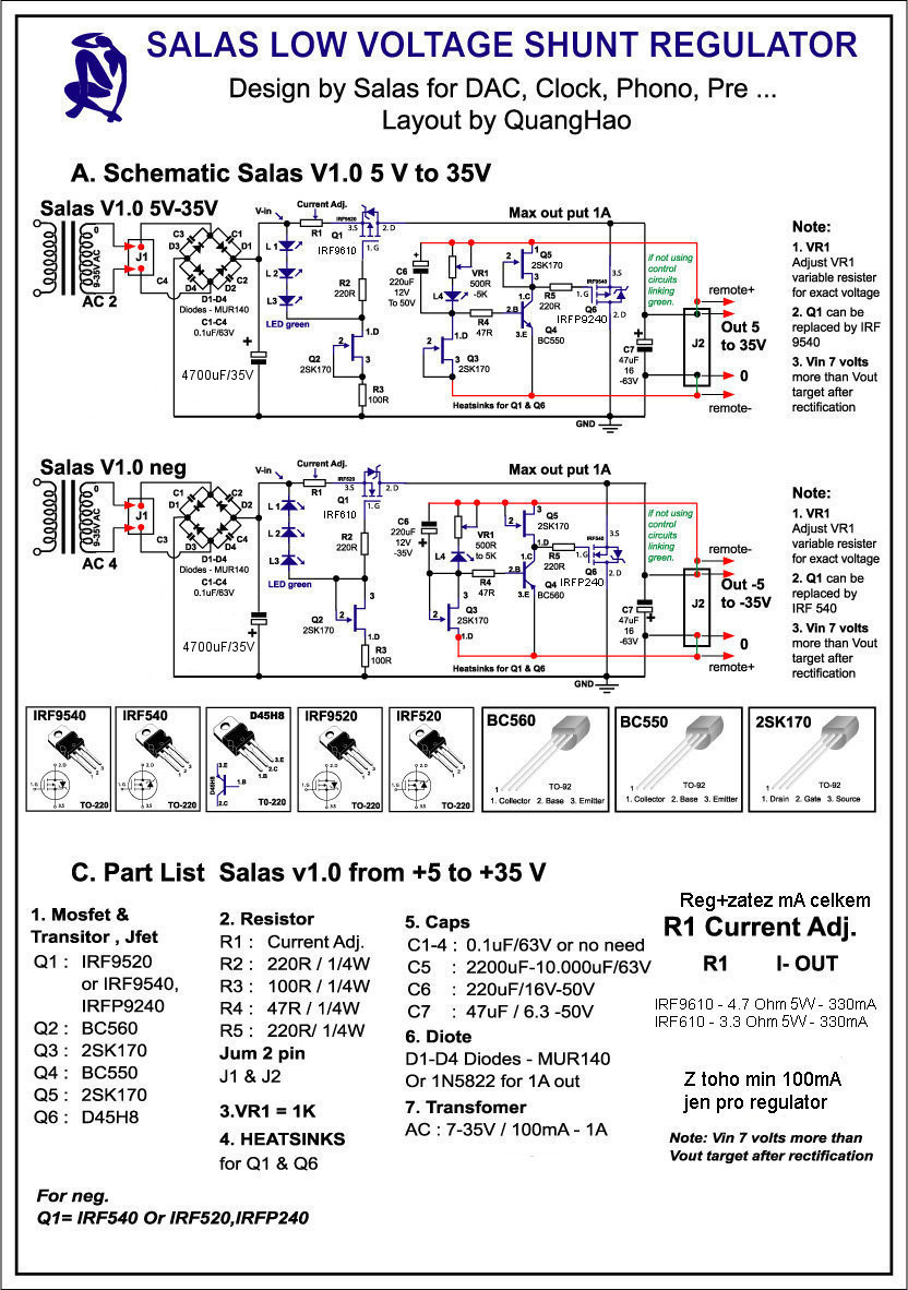

As it is configured already. I.e. 1 positive and one negative per channel, same transformers. But its not best advised to ask specific modding steps here for a product we don't have experience with. The mods guy must figure it out. Maybe there are things or revisions there that we don't know about, and we can not take any responsibility by just looking at a web schematic. This is a diy thread specifically for the regulators, beyond that it carries a disclaimer.
In that version it changes the transient behavior a bit. You can try values between 10R to 100R and find your best subjectively.
Maybe if I change the output mosfet to a IRF530 ??
I have some SSLV1 that I would like to upgrade to use an output zobel.
The open loop gain zero point goes dangerously high and the phase margin is vanishing fast with either MOSFET and a zobel, so better let it be.

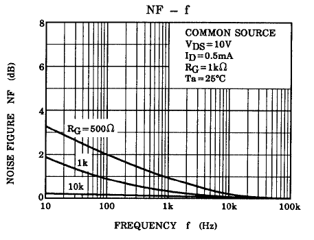

There are tons of noise studies for BJT, JFET and MOSFET available on internet. If someone would search & read those articles, he would see that BJT's are only choice for low 1/f (low freq) noise and MOSFETs are the worst choice.

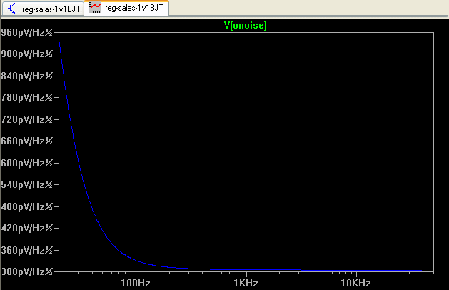

Merlin uses MJE15031G output option and 220uF Vref filtering as I saw on his pic, recommended for clocks in the guide. Here is the output noise sim. Very low Rbb PNP follower, low noise BJT gain error amp 50dB OLG, heavily filtered passive resistive Vref, low noise Toshiba CCS JFETs. Check.
Very good choice. But what is capacitive reactance of 220uF lytic at 1Hz or 10Hz? And CCS JFET's voltage noise?
Those simulated figures look very nice, but adleast few orders of magnitude too optimistic.

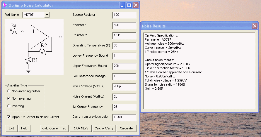

Xc @ 10Hz = 72.343 Ohm. That is //~1kOhm in the 3.3V reg. The AD797 has 100 Ohm on its input pins, its bipolar so it has some Ib over them & over the gain ones, 2.58x gain via 1.3k/0.82k Rf in that link you provided. Those are altering the best the chip can do. There is no Vref gain in the BiB, only buffering. That shines more, the more Vout we need. I measured a Muse 220uF/25V for DF, has 0.0346 @ 100Hz, 0.0358 @ 120Hz, & 0.0925 @ 1kHz. So loss is normally dropping the lower we go. The 2SK117 Vref CCS is same league with AD797 (naked, best samples) for sub 100Hz near 1kOhm source and does much better near 10kOhm (Most people here will use ~5kOhm for 15Vout). There is no input bias current or other resistors on it. You don't get a 220uF Nichicon Muse in a SOIC package silicon die, nor 500mA idle current from its embedded output transistors. All in all not too bad for a discrete it looks like for elements and configurations, can have several nVrtHz 1/f in real life and not 1nVrtHz @ 20Hz, I don't buy that either, but its a good indication its not at least overlooked for noise as far as discrete go. And you can't ask say 45V @ 0.5A from an op amp, the BiB is general purpose. AD797 quotes 50nV p-p 10Hz BW self noise, forget the network around it. I give 30x simulator error because say the models are not good for complete noise calculations. If it gives 100nVp-p noise between 1Hz-10Hz in BJT output 3.3V guise, it would be nice. If someone with a BJT output BiB has a lab grade spectrum analyzer it will be nice to measure it for us. As for the subjective part, its up to each one's liking in the multitude of combinations it can serve. Some will hate it some will like it, I already provided the fairy tales part in the thread's title, so feel free shooting it or loving it and saying it here. Personally I will be glad if it can be adequate and useful in the hands of enough people in the long term if they will feel it was worth putting it together in the end instead of sticking an LM317.
HERE is nice opamp noise calculator to make calculations easier and also some low noise calculations.

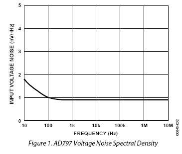

For AD797 noise from 0.1 - 10 Hz is specified as 50 nVp-p, that is 17.68 nVrms.
Where is specified 0.1 - 10 Hz noise for JFET?
If we assume there is 3nv@10 Hz, what is at 0.1 - 10 Hz?
30 nV rms....50 nVrms...70 nVrms.....?
In BiB regulator noise from voltage reference (LED + 500R trimmer) is shunted by 220uF capacitor (bigger would be even better) + noise contribution from CCS. This is feed through R104 to base of Q104. Q104 is BC550 with base spreading resistance of 150R@3mA and 145R@5mA. And there is another CCS, Q105.
In Fleapower regulator situation is not that bad. 10K and 3.3uF are forming LPF with Fc(-3dB) @ 4.82 Hz thus filtering voltage reference noise and shunting noise to GND (I would filter even lower, bellow 1 Hz). Shunting capacitor across 1K3 feedback resistor is decreasing AC gain (noise gain).

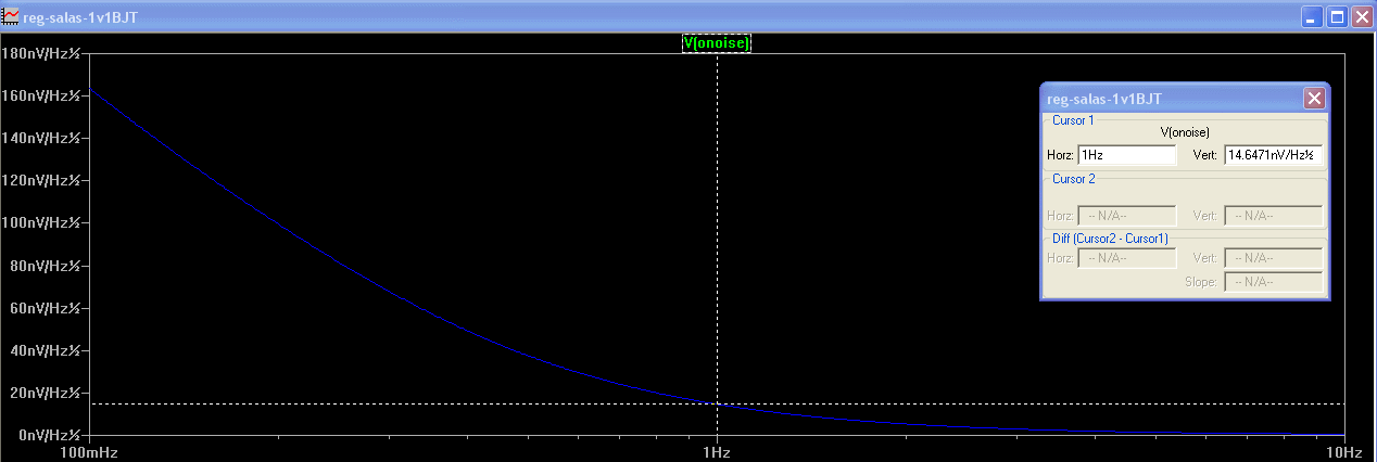

550R and 220uF is 1.32Hz, the cap is supply rail referenced. More than 220uF does not do much for total noise by running iterations up to 1000uF in noise sims, just slows the CCS regulation on the resistor. Maybe due to other noise sources prevailing. But for clocks 10Hz under noise, a 1000uF can be fitted no problem, there is space. They don't give noise density unfortunately for the Toshiba, just a 10Hz end dB value for 500R, 1K, 10k in the diagram I posted. Its almost equivalent to a K170 noise wise, which is very popular and maybe there is more data if we look around. I was just looking at components in each one and their possible noise generation for studying them. There is a 7812 CCS leg and output rail in the Flea to consider, BC547 BJT pass element final version in page two flea, same Rbb as BC550, as there is also a main CCS in the 1.1 etc. I don't have clocks and spectrum analyzers to fit both and see how the clocks pick up, if there is PSRR in clocks resisting some noise etc. I would make it out of curiosity since I have the parts and LT1028 even. Its just good learning to think by looking in specialized circuits, I never designed for clocks, or I especially recommended anything I made for digital. But its interesting discussion. I still give a fat order noise error and I estimate the BJT 1.1 3.3V at 100nV in the last 10Hz octave. And I am sure that a flea will multiply the basic 797 noise to a serious extent too.
*This is the worse I could do simulating from 10Hz down to 0.1Hz so to approximate flicker output noise interest region for clocks. I threw in a 1mF filter cap on Vref for good measure. I am not a finite time sample integrator to FFT and average that for ever, 😀 but can it be 100-120nV p-p roughly?

- The simplistic Salas low voltage shunt regulator
