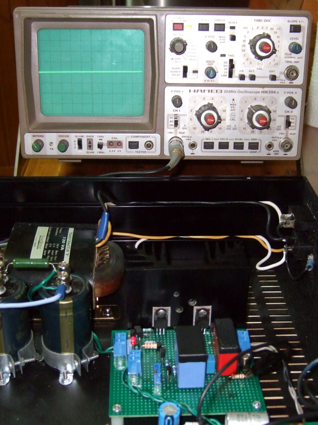

I am afraid to be overdoing it but I could not resist... After 24h burning, the V12R are now really showing it´s claws.... very good detail without any sign of agressiveness but retaining lower mid and bass presence.

Hi Mikvous.... Do you have everything inside the same case ?
What are the brand of the caps you are using for vref and the output ?
Now, you are charged to find the best subjective combination of Vref film cap quality type, and output system caps quality types as a coherent whole, not changing from safe recommended values +/- 15% for the members to know in the long run. I believe this is your forte. What about that?
P.S. ESR no less than 0.35 @ 100kHz.
I evaluated some easy changes on V1.2 and I think they come across subjectively in a positive manner. At least on my 61dB Low MC phono. Pretty stable on the scope also. So I am calling the usual suspects with builds in hand to evaluate and confirm or not on their client applications. Lets call this the V1.2R(revisited) beta test. The changes are two. First the 33p-1k step circuit is deleted and the BJT error amp's base resistor is made to 1k. Second, the output network across the force lines becomes a combination of one electrolytic, a resistor and a film capacitor. Its not crucial to change the value of the Vref film capacitor or the value of the output film capacitor in existing builds for testing. Only to add the 47uF and change the Zobel's resistor to 0.22R. I attach an example. If you fancy beta testing, let me know your feedback.

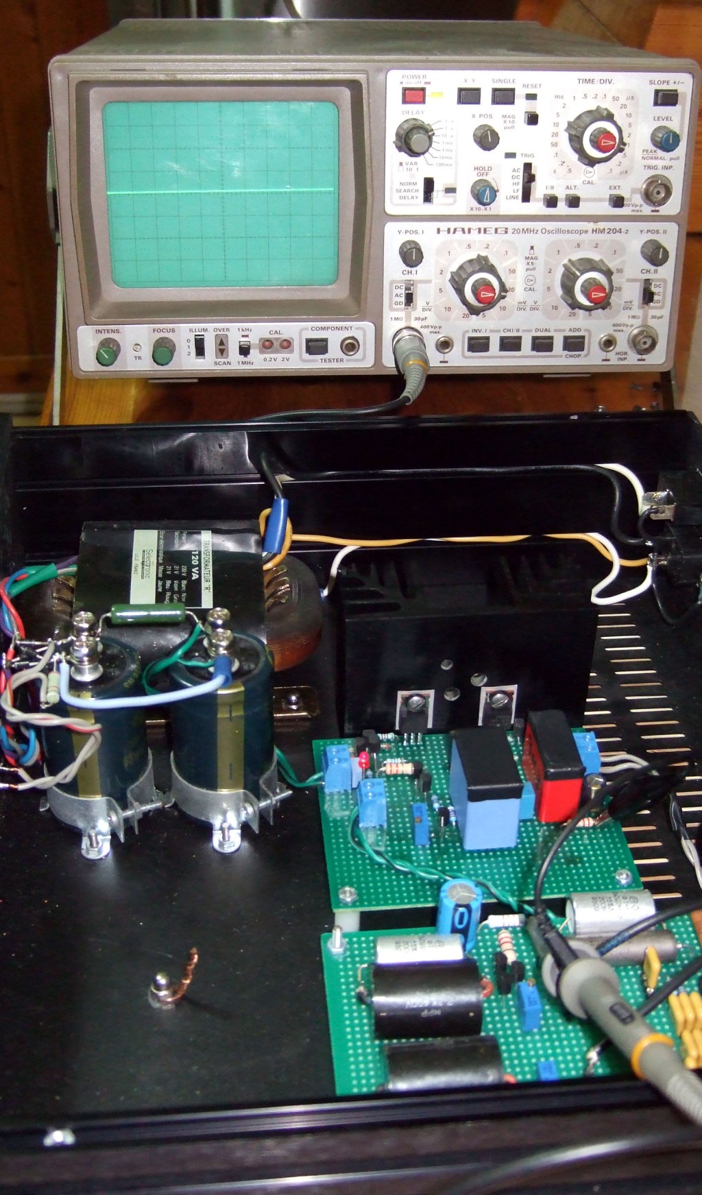

Hi Felipe..... I had some difficulties implementing V12 because the distance between Film output cap and the Mosfet is critical but This one is as stable as V1 and perfectly noiseless... And the gains in detail relative to V1 are substantial.

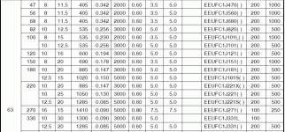

I have used the Panasonic FC 63V 47uF 0.342 @ 100kHz ESR standard in combination with the Zobel resistor. Keep in mind not to venture far.

Yes... I understand that we must not use Rubycon ZA/L there but Silmics and cerafines might do good.
Silmic has that wonderfull bass / upper bass but adds some grit to the sound.... Cerafines might be very good.
As for the BG.... it is still burning and getting better over time so I will wait.... nevertheless BG are almost unobtainium so we must search elsewhere.
