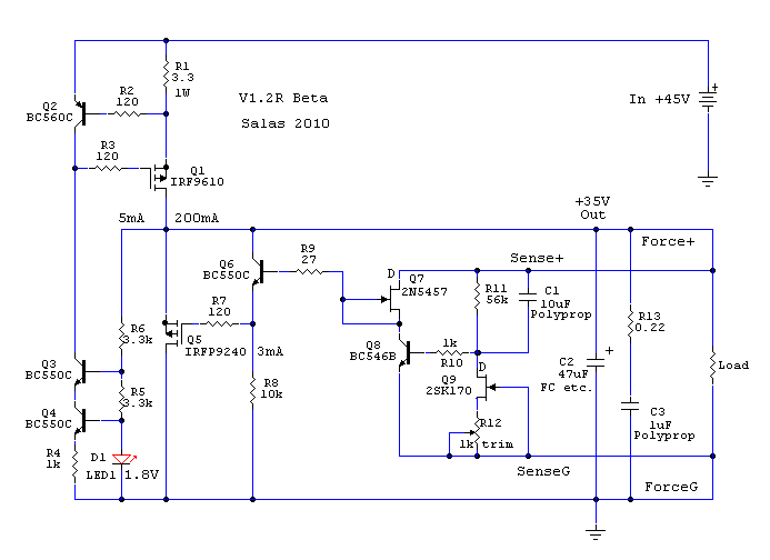

V1.2R beta
I evaluated some easy changes on V1.2 and I think they come across subjectively in a positive manner. At least on my 61dB Low MC phono. Pretty stable on the scope also. So I am calling the usual suspects with builds in hand to evaluate and confirm or not on their client applications. Lets call this the V1.2R(revisited) beta test. The changes are two. First the 33p-1k step circuit is deleted and the BJT error amp's base resistor is made to 1k. Second, the output network across the force lines becomes a combination of one electrolytic, a resistor and a film capacitor. Its not crucial to change the value of the Vref film capacitor or the value of the output film capacitor in existing builds for testing. Only to add the 47uF and change the Zobel's resistor to 0.22R. I attach an example. If you fancy beta testing, let me know your feedback.
Also R5/R6 are now 3.3k (were 5.6k) and R11 now 56k (was 47k) and R9 added as far as I can see....

I use 47V on the phono and 5k6 in its CCS cascoded tail. You just calculate whatever resistors in any Vout application that are able to feed circa 5mA to the LED. R9 or not, no real problem. R11 relative, no worries. Its just a 35V example to eyeball the changes. To test the V1.2R you just lift a leg from the 33p-1k feedback network, that will write it off circuit, you change the previous 27R or 33R BC546's base resistor to 1k and you strap a 47uF across your existent RC output. Not using only a 47uF, both. The lytic's added and the film cap RC Zobel remain. Its a system, and crucial to termination and stability. Even screwing the lytic in the force out connector will do for easy testing. If you like it, let me know. Then you can fix the changes. Else, you reverse them in a minute. If we all agree its positive, then V1.2R stays. Else, it does not graduate.

But why did you delete the 33p-1k step circuit ?
The V1.2 with 47u EL output sounds warmer, with a fuller upper bass, lower mid presentation than the 10u film output that has much higher detail but can sound lean in some systems.
Its not a parts quality change its a different calculation of its closed loop gain contour and phase. You guys just test it subjectively and tell if you find it better or not.

I have a 33r as R6 (BC546 base resistor).
I have no resistor between Q8 BC550C and Q6 2N5457.... must I place R9 27r there or can I experiment by just replacing R6 by a 1k ?

Refer to the V1.2R previous page's example designations, so its clear. Replace your 33R with 1k. 27R to 550C driver not crucial.

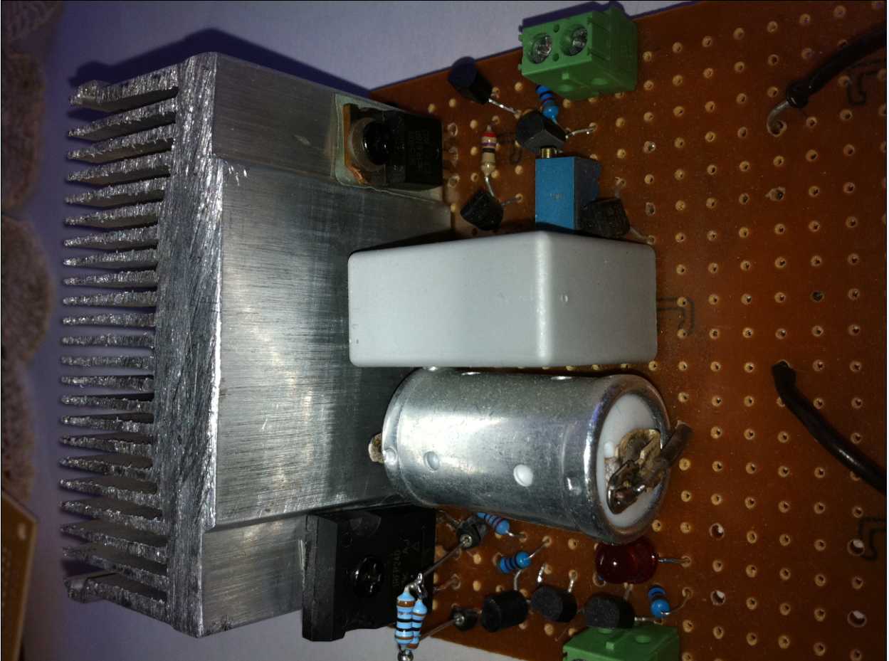

Just completed the mod in left channel shunt.
On the output I have a 33u // (1u sonicap + 0.25ohm).
Working perfectly on the bench.... Slowly rising voltage as temp goes up 🙂

Its stable on the scope too. Slowly rising is the 546's Vbe changing with heat and both its tempco and K170's tempco. We could mini sink those and see if they are steadier for drift also I guess. In lower voltages the 27R was showing a slightly better damping theoretically but its not something I could find a practical difference for. Maybe in longer layout its good to damp the trace inductance to the 550's base though.
