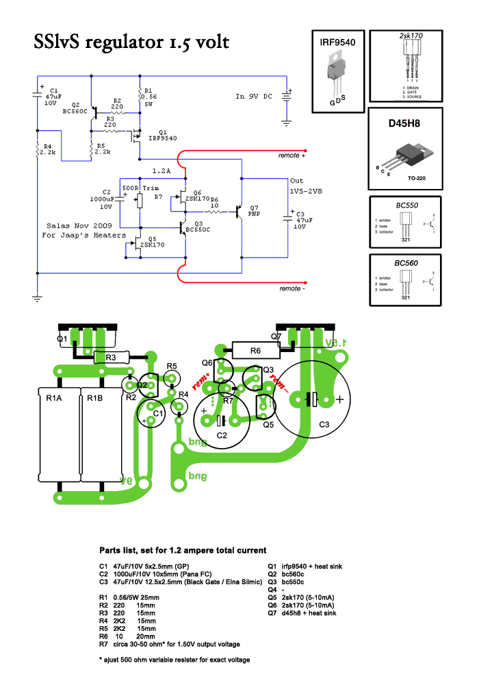

As per Salas, suggest move input J1 to lower edge of brd about midpoint (roughly below the present R13) Will probably need to increase the "vertical" distance (height?)
At the same time, consider using that vacant area between the Q1 and Q4 as a convenient point for the output pins (it doesn't have to be a traditional +/- connector at all) and so the 0volts points are neatly together at the bottom edge of the pcb - will also need to move the R12 + C3, unfortunately.
Random other thoughts - R15 could fit neatly between Q2,Q9 and, D1 could do with a cap across it (IMO, that is) and the "Jsense" point is a bit confusing.
Perhaps, also move the resistors R4, R5 a bit further away from the Fet pins and you might consider adding the option to connect the R6 closer to the central 0volt point rather than directly to the Fet - not sure if any advantage, but just another donut
This will give a more compact, shorter track version but the "more square" board may not suit your requirements.
None of these comments may be of any use to you, and it's good to see your design - good fun, this!
my 2 cents ...
Thanks Salas and James for the help. The general board shape is important for my final configuration, but, I can adjust other items. The Jsense is for a a socket with two legs filed off. The first board will be used in a prototype, so, I expect to be connecting and disconecting frequently and don't want to desolder all the time.

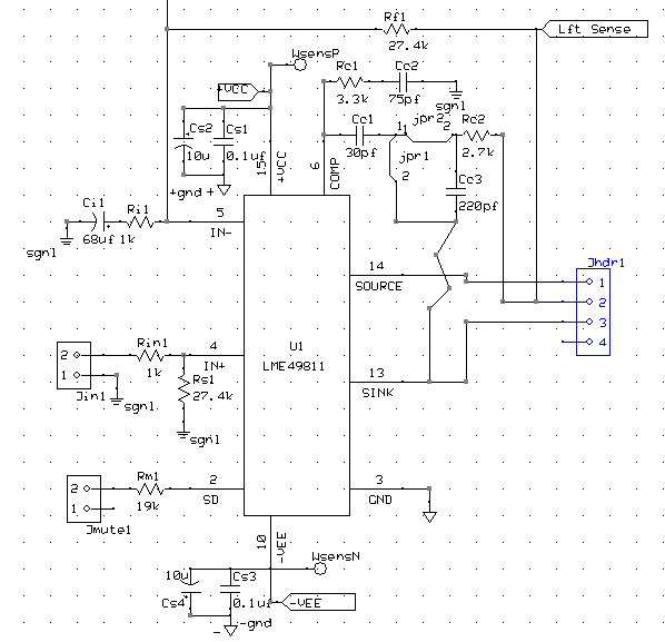

At the risk of being heckled again, I have a question about decoupling caps at the load. In this case my "load" is an LME49811. As I was reading Iko's thread, I seem to remember Bill mentioned that he is implementing the regulators without decoupling caps. Did I get this right? Should there be any decoupling caps?
If no caps, what does the ground connect to? I currently run this device with the signal grounds separate from the power grounds (schematic attached). Would I continue with this grounding arrangement (just omit the decoupling)? As you can see there is one point on the chip for a ground connection, I believe that this is a power ground connection.
Thanks for your help.
