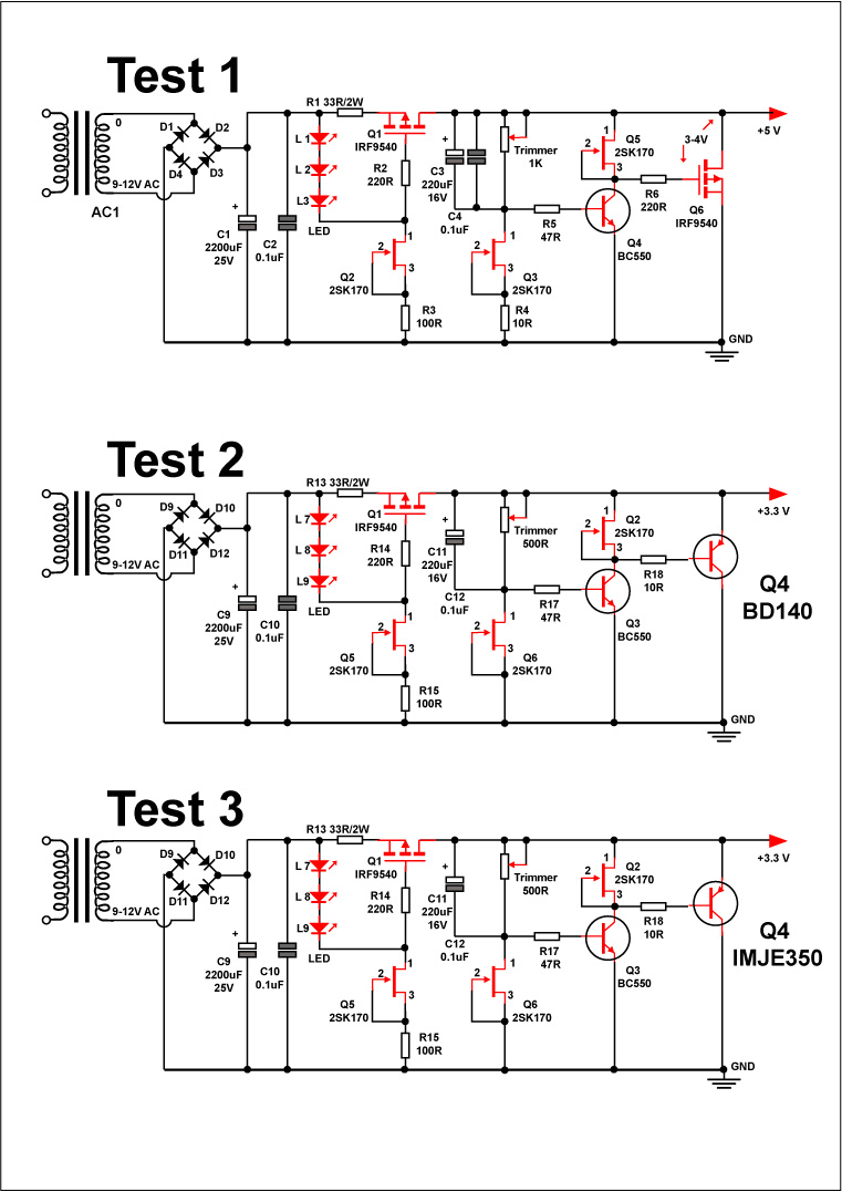

For smaller voltage output decrease the value of R18 and R16. The current limit is set by R25. To get 45V output Q8 would have to be replaced with some higher voltage npn.
10k & 11k, could I use a 10k trimmer pot to fixe the voltage needed? any suggestion for higher voltage npn Q8?
Yes, you could use a trimmer, but after you find the right value it would be best to use fix value resistors. For Q8 you could try BC546B.

I remouve R= 10 Ohm
and I Change C 220uF// Trimmer by Tantalum capacitor 22uF or 47uf!
I see the sound is like! only this cap.
What do you think about the change???
BD140. Avoid tant caps. Most distortion, bad reliability. You probably liked the elevated 2nd harmonic they contribute. Test1 circuit shows Q6 reversed.
Ok! I use Bd140 ad 3.3 v and not use Tant caps!

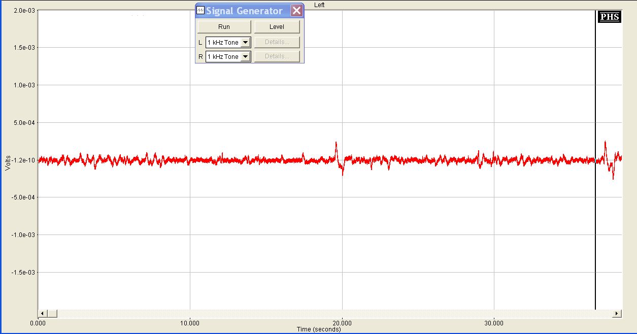

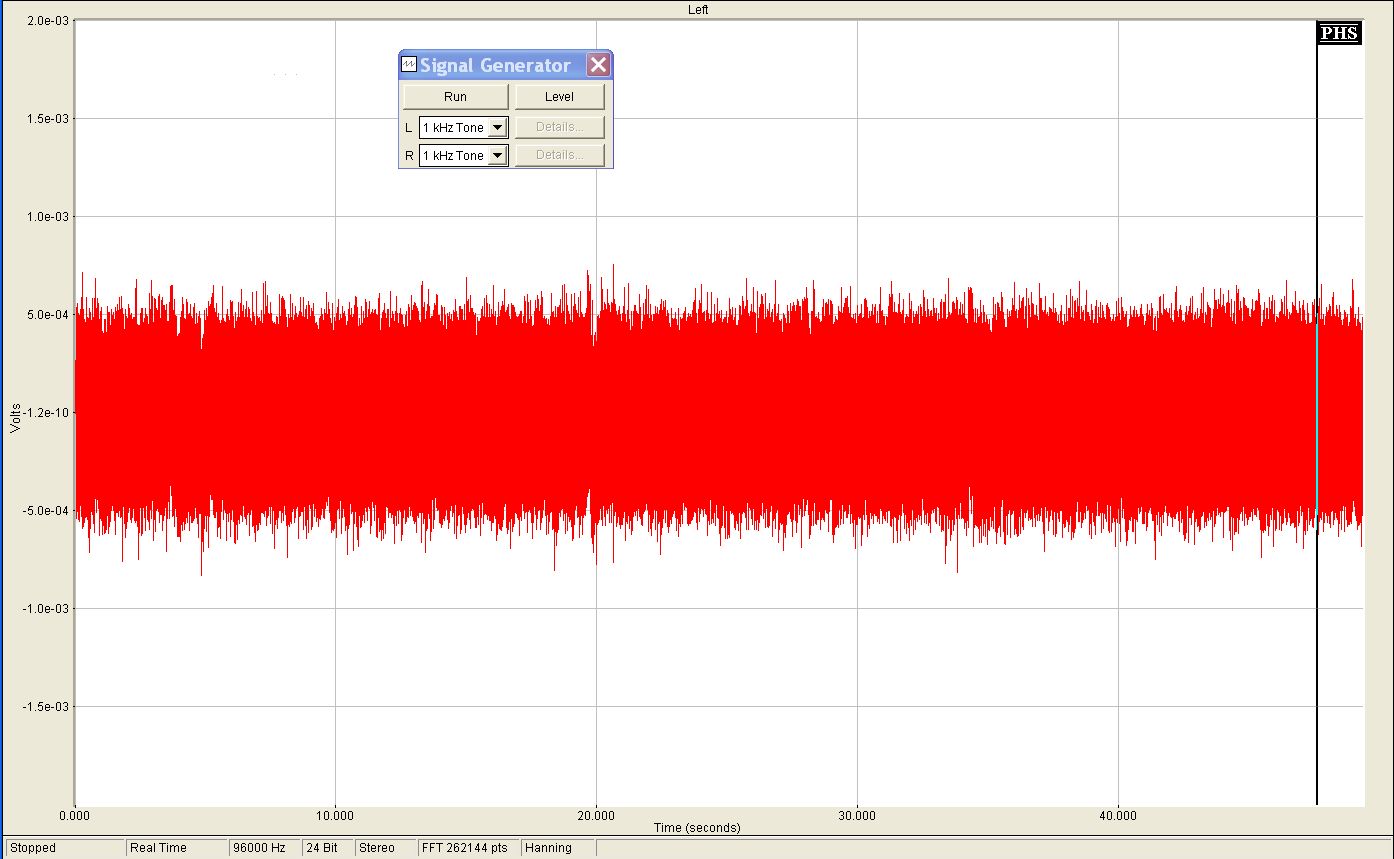

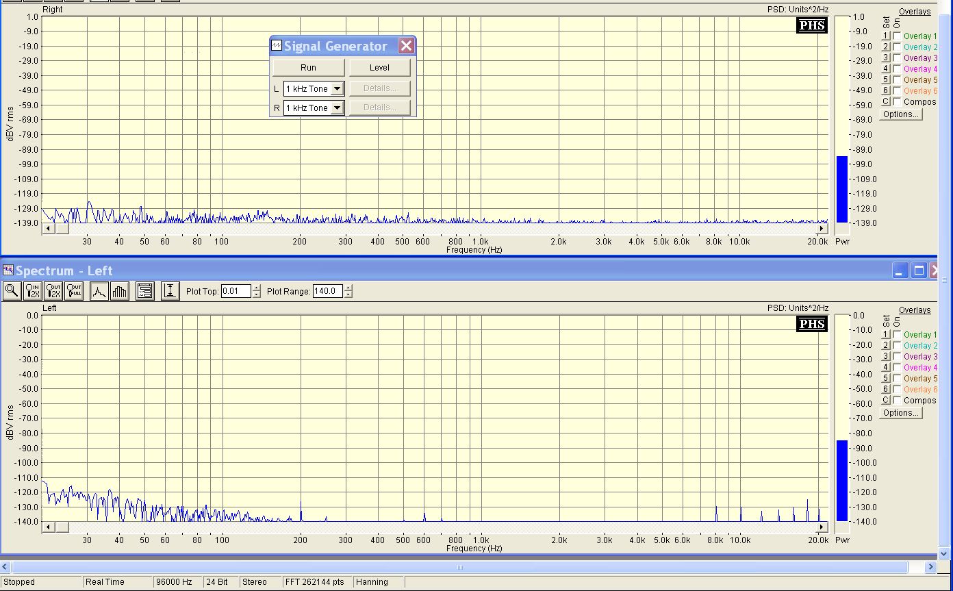

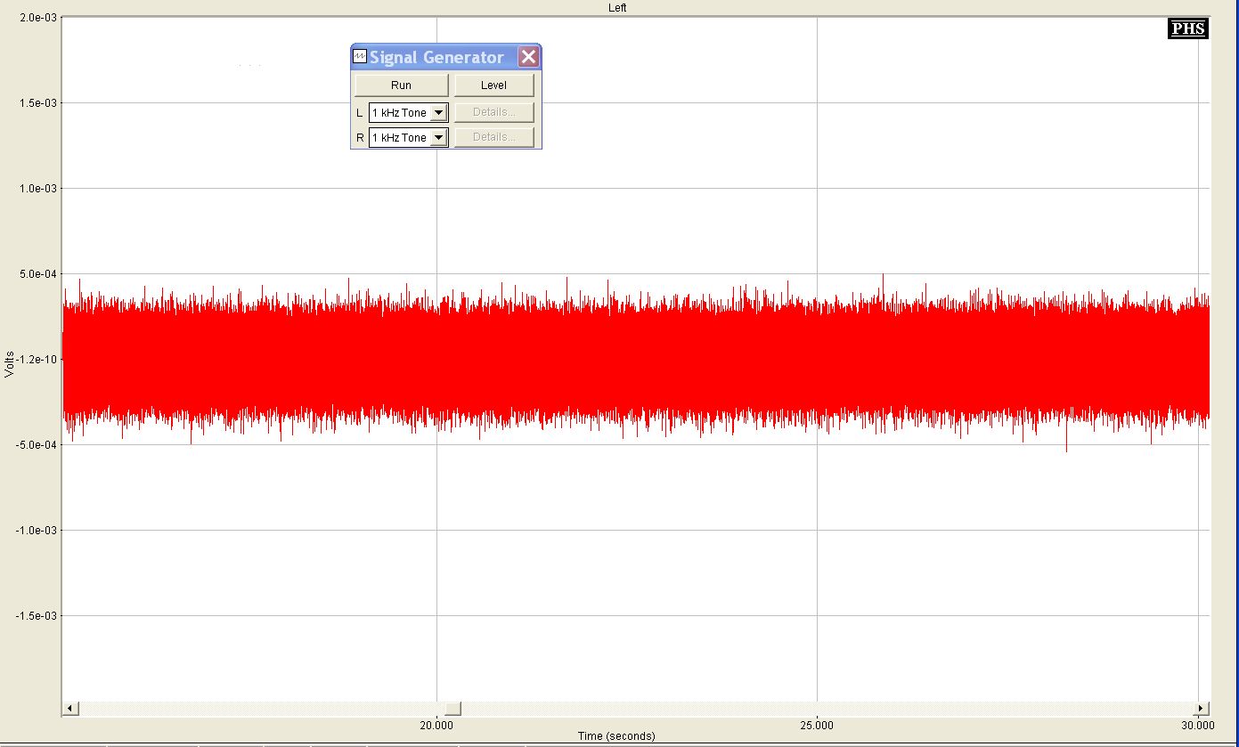

Today I measured SSHV V1.0 DB140 and MJE at 3.3V using the following results
1. BD140 At 3.3V
1. BD140 At 3.3V
