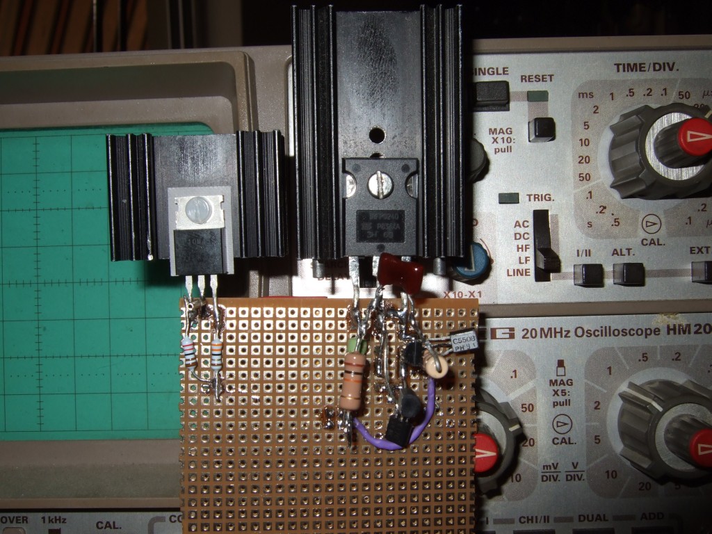

Mind you 1.2 needs good layout practices. Tight. If it is done wrong it will show 250mV 12.5MHz oscillation. You will understand something is wrong even if without a scope because it is going to choke the music in the phono, will sound distant with hum everywhere in the spectrum. If the signal is as strong and clean as before without new noises, its a success.

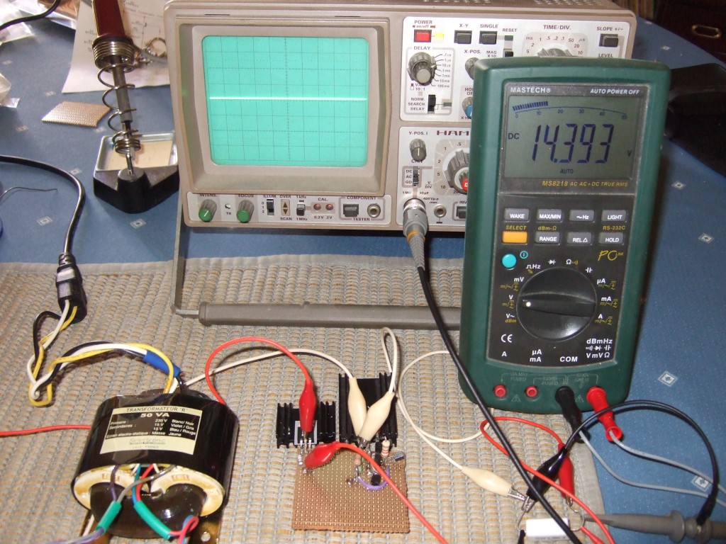

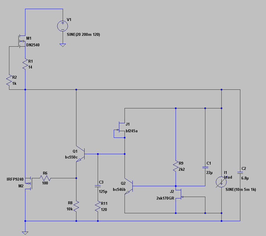

Today I did experiment on simple man's 1.2 dead bug, so someone can practice easier and learn. I used 10M45S and no trimmer and no films. Significantly lower parts count. The bandwidth is the same, OK the CCS is not as good and can not be set more than depletion's idss, but if its pre filtered with CRC it can make it somehow. It worked alright even with flying crock leads, I set it at 72mA with 33R and 2k2 gate stopper. Could see 1mV of wideband noise with the 10M45S, that I could not with the enhanced mode and its cascode tail of the full 1.2. but could be also due to its just a makeshift toy construction. I show it with DN2540 in schema here which is better, but I don't have in hand.

That from 110 is OK for V1.0. But that one will never oscillate, has very hefty margin, and its low parts count, you can make it any way you like.
