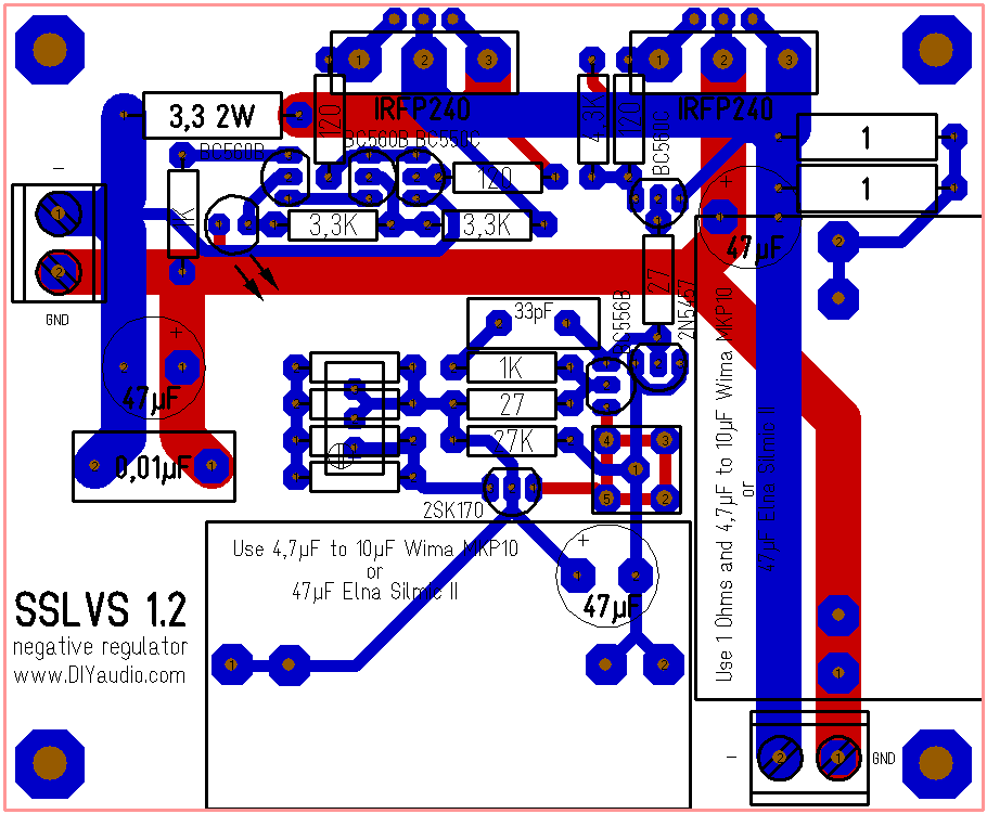

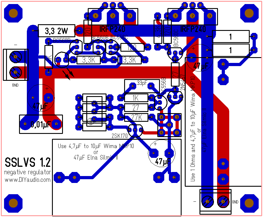

I designed a new PCB for the LED-reference BJT-cascode and tried to incorporate all the feedback.
The small transistor pads have been increased (they now only have 0.3mm space between them - I don't think that it'll be a good idea to further reduce it - any comments, maximo?)
Due to popular request I also added TO220 holes to the PCB layout.
The new design looks cleaner IMHO.
Since the new design does not require IDSS sorting, can go for higher input voltages and performance is the same as the older version, this new design will become the standard design I will be working on.

1.) Somewhere in the thread it was mentioned that LED-reference could be used in the remote sensing and adjustment part, too. Does that improve overall quality? (There seems to be enough space left in the new design so that I could even add in that option with a "daughterboard".)
2.) I understood correctly that the performance of the LED-reference version is at least the same as the one with 2SK170/2N2559, did I?
3.) At the moment the circiut contains BC560B and BC560C. Can't one model be used for all without compromising performance?

Move 33 pf cap to the left (on top of 1k resistor) in order to reduce track lenght. Its pitch can be 5 mm or smaller if you use a good ceramic component.
If I remeber right, Salas advised on using a Silver Mica 33p and I took the footprint from the datasheet. I don't know about performance of different capacitors there, but I'm eager to learn and changing the pitch is not a big deal...
3.Yes, use 550B-560B for those CCS TO-92s, so some will not stick out for hfe too much. Had no problems with mixing B or C, or all being C, but the B grade is more conservative around 300 hfe.
2. Yes, equivalent. BJT or FET cascode same PSRR.
1. LEDs are for fixed reference on a daughter board if you fancy. In that case you should have to jumper the source to ground of the trimmer controlled JFET, because the LEDS are going to need stronger current to be happy. They are stiff, will not come up thermally anymore than +/-0.4V, the resistor will slide with the small Jfet current coming to thermal final -but stay then-. Also less impedance. A bit different subjectively than a resistor Norton ref. Semis are active things. Much of a hassle for 24V, not recommended there since you will also lose noise performance gradually with number, but nice in the 5V.
P.S. Don't know if TO-220 will work equally well given the extra length to gate stoppers in your last iteration. But they can always get soldered directly to legs and just leave their other leg lengthier to is pad.

TO92 pads: I'd rather go for oval shaped pads 80 or even 100 mils, similar to the ones used for through hole ICs.
33 pf: Salas originally wrote (post 1904) "Preferably tiny NP0,C0G", obviously ceramic.

Another reworked version:
- made some cosmetic changes
- made the TO-92-pads oval
Keep the good comments coming, I feel that version 1.0 is coming pretty close...
About the TO-220 pads:
Personally I don't see why someone would be using the TO-220 if the performance of both types is identical and the TO-247 have way better heat dissipation - am I missing something there?
Additionally you could always bend the pins on the TO-220 to fit into the TO-247 holes.

I agree. Delete TO220 pads. Bending legs apart isn't that easy 😉 but can be done sometime.....
some to-220 mosfets are a bit cheaper (like the 540 family)...but yeah bending the legs is always a viable option.

Hi THKL
I can not identify the sense wire connections on your board.
Also I can not see what is the square part with 12345 lettering.
Why the 47u on input ?
Splendid pcb work BTW.... I will use some of your ideas in my next build 🙂

That square thingie is the sense-wire 😀
Actually it's an SMA-socket.
Because the sense-wire should ideally be a coaxial rg59, an SMA-connector does the trick nicely. You don't have to fiddle with soldering the shield and always get good looking and securely shielded connections...
The 47uF bypassed with 0.01uF is for decoupling if longer cables from the transformer/rectifier/cap-reservoir are used. It has just been added, because there was unused space on the board and it might come handy under some circumstances.
I will sleeve the rg59 and the power connection together and have another small PCB on the "receiver" side, where rg59 and power are joined together and fed into a 2,54 or 5,08mm two pole connector for the power connection to the consumer.
A good power-supply does not only have to be highest quality, but look nicely, too.
You talked about a cheap PolyPropylene on the Vref - what would you recommend there? I mean the PCB was designed for (upto) 10uF MKP10 PP
Thanks for the compliment on the layout, but I couldn't have done it without the feedback here. I would have had many tracks running too long and wouldn't have thought how close the stopper resistors really have to go. I wouldn't have thought about pad sizes either - I would have used what the pcb cad software had as standard sizes...
