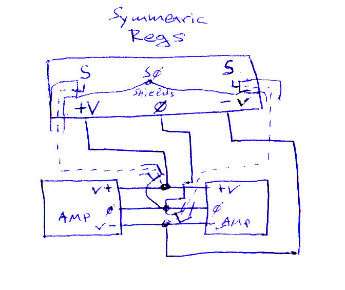

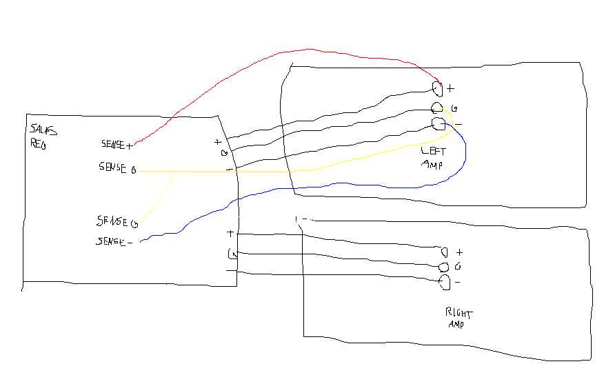

So, you want to power 2 channels from one symmetric shunt? Because I don't understand the sketch. You show four Vout polarities.
yes sorry i should have made that a bit clearer.
the 2 sets of Vout are connected togheter. i m just using 2 seperated terminal blocks. i dont know if the whole idea makes sense though...
yes i know that would be optimal but the thing is that with two seperate amp boards for left and right channel, i think it s pretty much the same to just put the reg as close as possible to the amp boards with short wires, no? we have to consider the size of the amp board in my opinion also
i agree that for a device that has everything on one board, it s more convenient. but in my case there still will be a good lenght of wire left, that the sense wire wont have control upon. i dont know if you get me?
so my theory is that i m better off with one reg for each board, or no sensing wires at all keeping short connections.
what do you think?
what do you think?
