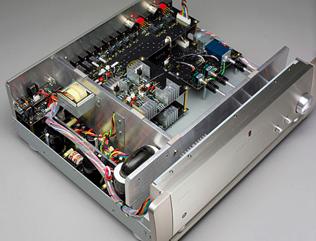

BTW, I like the Parasound approach. (Is he using shunts ?)
Nevertheless it is funny that such a small shield should reduce noise so much !
(I have an old aiwa tape deck that has a big case. The tx is placed on one corner with a small iron plate in the vertical in front of it... maybe I need only a small well placed shield)
John is using local cap multipliers and series pre regs I think he wrote as a member here, in his Vendetta at least.

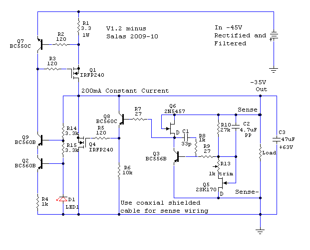

hi everyone,
in the 56v reg v1.2,
if i want the neg version, is it exercise as in the 25v version?
i.e.
1)interchange bjts channels(n to p and p to n)
2)invert q5 and r12 chain
3)flip q6 the same way as the 25v version
4)interchange d1 and r7, and faces up
5)r-11 goes above q9
6)irf540 as mosfets
is nthat correct?
So in the Vendetta he uses gyrators and series regulators ?
If I recall correctly I think he mentioned in some posts in that long thread Blowtorch probably.
Not a bad approach... I am using gyrators before serial sregs in the CDP.
IMO shunts are better... the only drawback being the heat 🙂

i already have my hands full trying to make salas shunt work...and you want me to add words to make the thing look even more messed up? 🙂😉
seriously i m just trying to understand how the negative 56v(p192) reg would LOOK like. i dont quite know yet how to upload ltspice schematics
LED has correct orientation in your sketch but it should remain down along that resistor.
See a mirror negative example.
thank you!
i ll try it out and cross my fingers...
what minimum voltage Vin it should be fed with (smallest potential difference) ?
