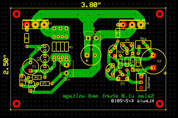

Hi Ken, could you be so kind to post (or send me by p.m.) the ExpressPCB files (.SCH and .PCB)?
I'm lazy... (and I like to play with toner transfer...)
Thanks in advance
Guido,
On the condition that the next time I'm in Bergamo you'll buy me a double espresso 😉
Here you go, I've only made the positive voltage version so far. Just rename the files and remove the ".txt" from the name.
No warranties express or implied....
Ken

I assure you that 10cm is very long for virtually making the reg ''one thing'' with the load. You will see that when you will apply remote sensing even the thicker cable you use now will ''shine'' with its absence.
2200 is enough for the current you need. Its a matter of cap quality what you will prefer in the end.
Hmm don't tell me so about Rs😡, still I'm waiting the resistors but Easter time all in delay so I don't know when I will receive the resistor to do Rs. About cables, better cable: "no cable", next time Salas regs. will share same pcb together Salas Phono RIAA😀.
I have in mind to change the box so the regs. will be the more near possible (less than 1 cm or so) to the phono RIAA, but 1st need to ultimate the Rs & who knows the reg. V1.2 if finally I can manage the oscilloscope🙂.
Now I remembered was Michael Percy who tell me about caps, thanks to confirm Salas now I will try 2200 in PS.
