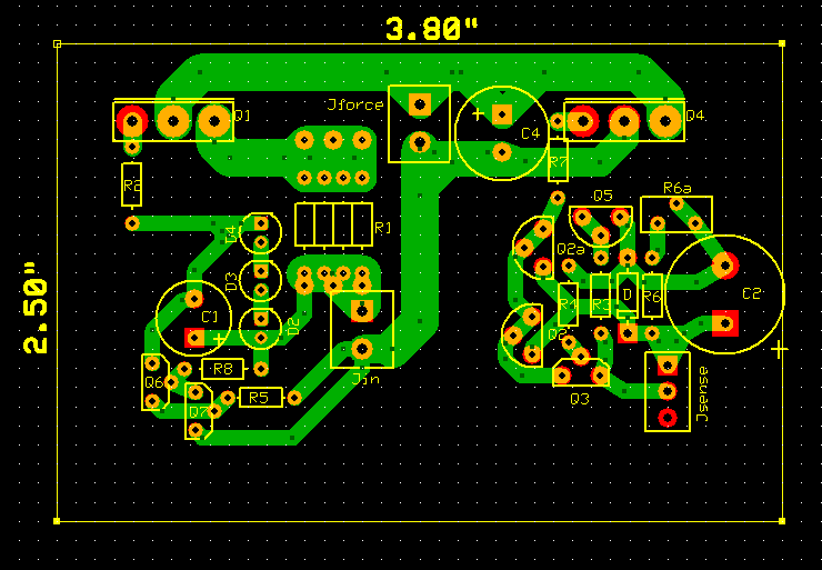

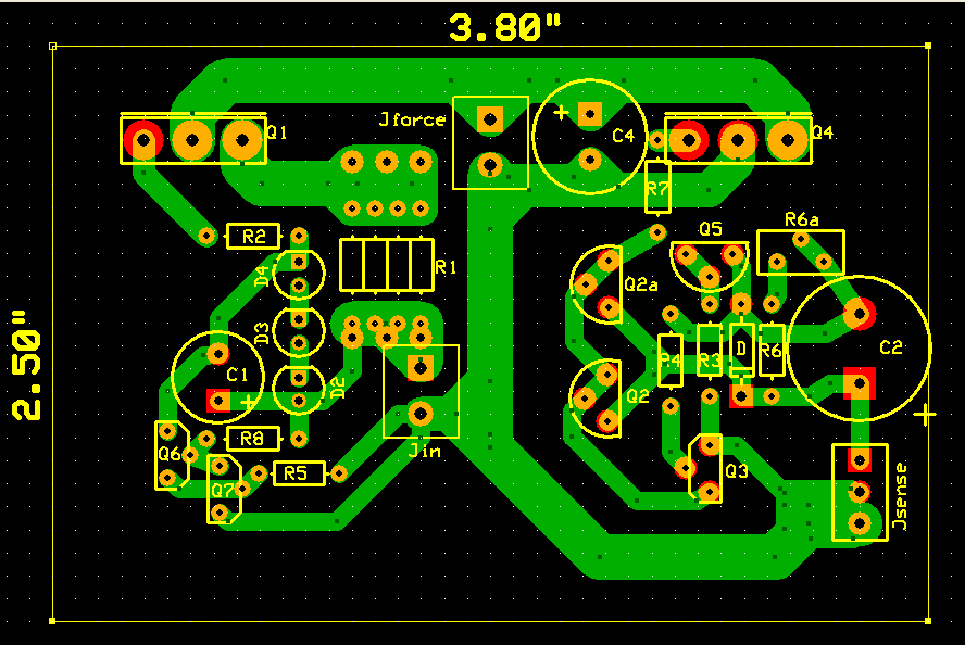

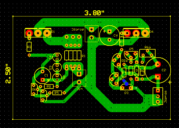

I've made this layout for a + voltage v1.2 and was hoping that folks might take a look and give me feedback. I made it so that I could use a zener or resistor to set the voltage and with two pin out versions of Q2. All thoughts would be appreciated.
Ken

Looks neat to me, although I am as good in PCB evaluation as a Kick Boxer in fine arts.😀 I think you are closing sense- locally at the reg with force main ground? Wrong. Should be meeting only through cables at the load.
