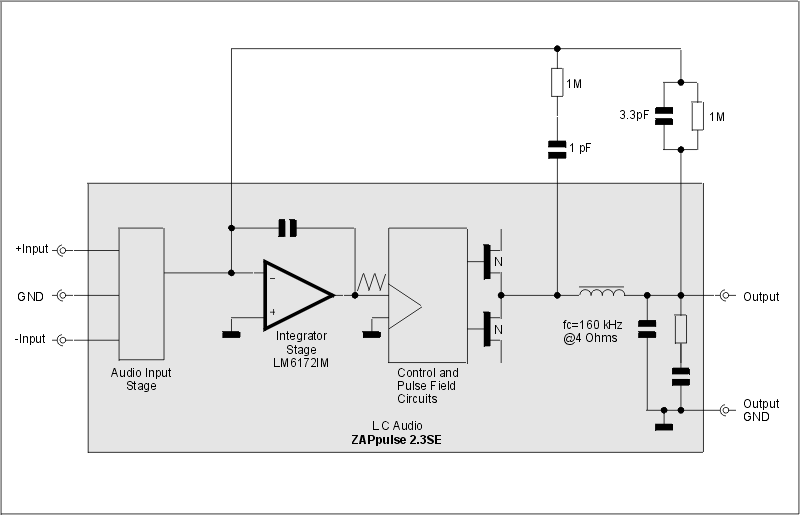

You may not only play with the RS/RP ratio (and their respective cap values) but also with the ratio RP/RF and RS/RF in order to keep the feedback at least partially "conventional".
You might even keep the conventional fraction dominant as John suggested.

Below you can see our post filter NFB setup for the ZAPpulse. The values shown are the ones that work best for ZAPpulse, and will give a constant switching frequency independent of the load. For other Class D amplifiers other values might work better. The sound is best with plastic capacitors, compared with ceramic NP0 caps.

Lars, what i mean:
here http://www.diyaudio.com/forums/attachment.php?s=&postid=662340&stamp=1118660272 is not UcD, and also far from Charles suggestion, which he gave you here http://www.diyaudio.com/forums/showthread.php?postid=655739#post655739. 1M+1pf in serial (!), if you'll hear difference with/without - i'm sure it's placebo effect.
BTW, Rf=1M as feedback res and lm6172 input bias current 4uA + 3uA input offset current, in the worst case, it's will give several volts to output lm6172, and much more noise vs Rf=10kohm. Your zappuls really use Rf=1M?
