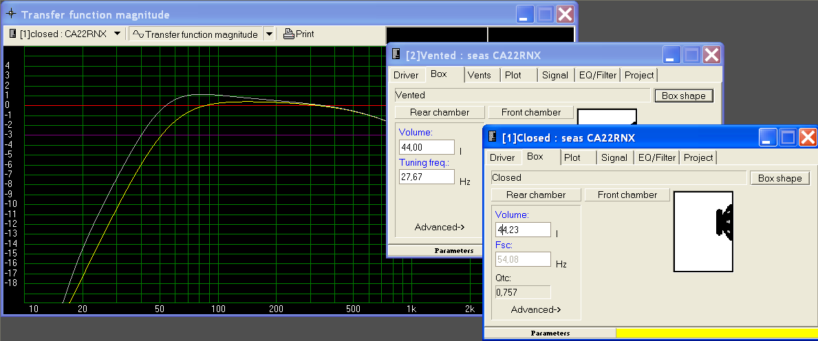

I'm planning to build big monitor with a 8" and a 1.25" dome + wave guide in a 35/40l bass reflex enclosure.
I have a tip for nice 8" driver seas. CA22RNX closed or bassreflex port on backside. So when you close the port you will have a very nice closed box, and if you want heavy bass open the port. Vent 2cm high 22 wide 32cm long.Thank for the link, I'm looking at both of them, same price range !
To close and open the port use a pice of foam like that of a cushion of a seat, thats enough to make a closed box from a bassreflex.

CA22RNX or CA22RNY that is the first question !
The second question is Monacor DT-300 + WG or P Audio PCT-300 + WG or Audax TW034 + WG . Concerning the last option, FIY the WG is quoted 125 € for two items 😀
They are all usable to me. Will make a nice sharp priced loudspeaker.
''Frequency response of all drivers on wide curved baffle without crossover'' graph shows the RNX is good for 3 way designs only considering the green line upper midrange strong breakups.
Third order xo 1.5kHz 2 way
With third order the breakup is suppressed -18db at 3kHz I do not think this breakup will give a major difference in the response.4th order even safer maybe.
Unfortunately that mount at 4kHz the especially big one, and the other mounts, denote mechanical energy storage that takes very little triggering to be excited. In reality it will never be as good as a resonance free driver in its band pass region even when cut fast & well before. We may achieve good attenuation of anomalies for nice filter lines & phase tracking but the mechanical issue will be there ringing when rest of bandwidth energy will be dead. Can be excited not only from its own filtered signal but from the total power that the loudspeaker radiates. The KEF B139 was notorious for its 1.5kHz nuisance although always used and filtered as a low band real woofer for instance. These things are to be tested in practice by listening to candidate drivers with pink noise and a well known human voice, exchanging possible filters also, and then narrowing down to which one provides more, i.e. the gain in sensitivity of a rougher driver is what prevails and makes the speaker tick but its mechanical issues are not that apparent? Or they still stick out? Maybe a tamer in break up less dynamic driver wins for definition, lowers fatigue, dialogue diction gets easier to follow? Etc. etc.
