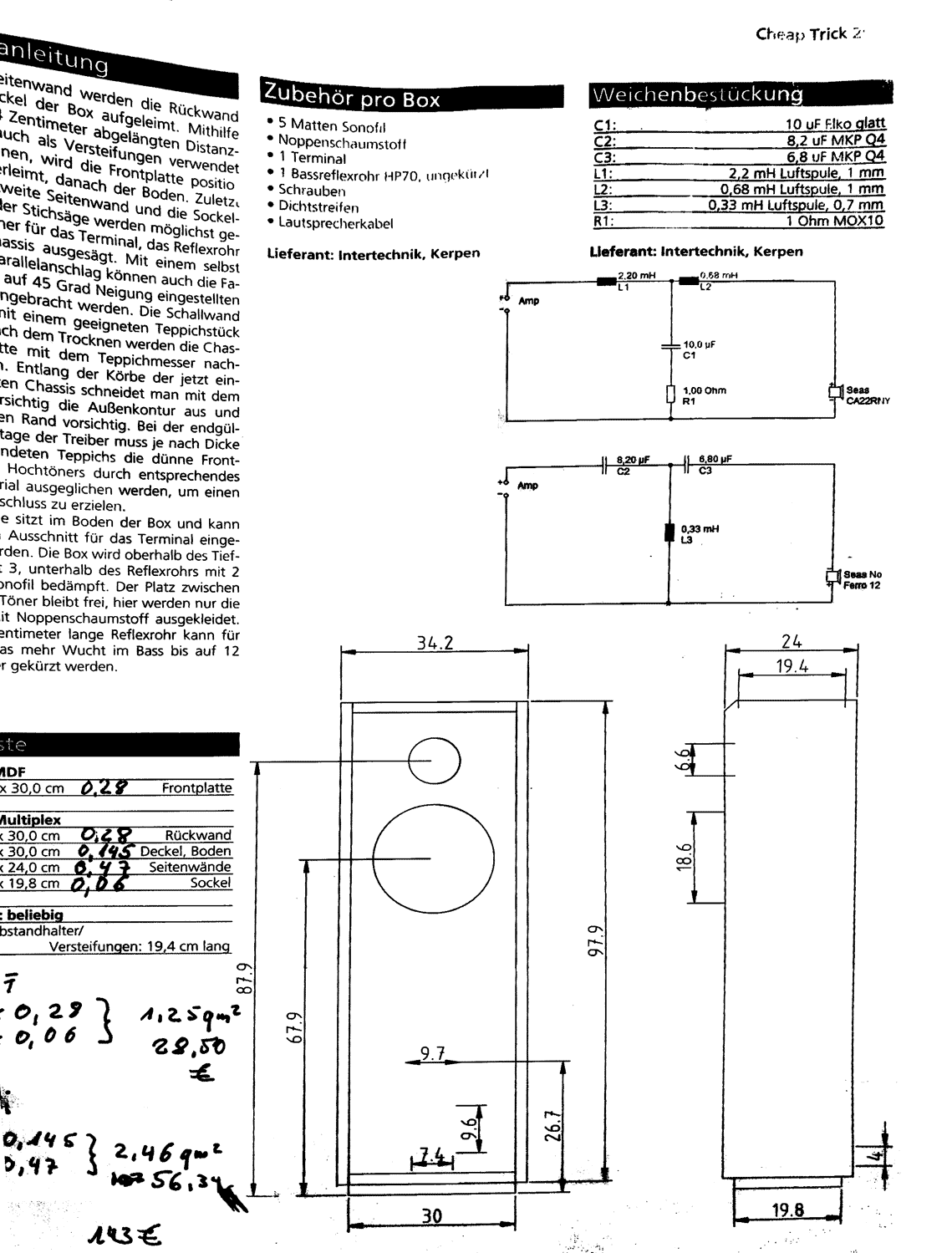

Can I use Seas CA22RNX instead of the CA22RNY? For tweeter Peerless HDS tweeter I think is not available is there a substitute for this?
For Salas:
The "Peerless HDS" has been replaced with a new name (but same tweeter):
ScanSpeak Discovery D2608/9130 1" Textile Dome HDS Tweeter
Salas 2way in wider enclosure

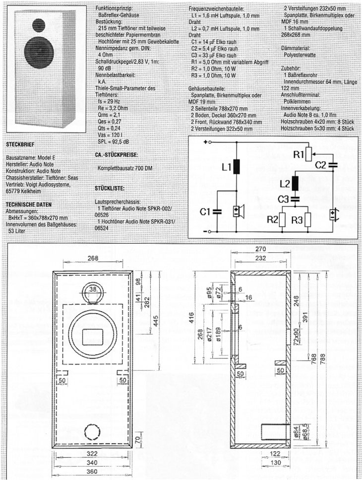

i would like to build the Salas 2way speaker -but in an Audio Note E enclosure.
It is a little smaller in the deep- to achieve 45l.
Which crossover parts need an adjustment?
Is it possible only to lower the value of the L1 coil?
Surely playing with L1's value is of primary concern because different baffle width will mostly change the curve in the lower mid and upper bass regions. It may be enough.
But box dimensions changing can bring smaller ripple effects higher up in frequency also. Best is to measure raw response and impedance of drivers on the new cabinet first.
When not equipped for such measurements, modeling with a diffraction simulator to mix published responses with calculated acoustic effects in a crossover simulator is recommended.
So to anticipate possible filter components value adjustments before migrating the design. Like with using those excellent software contributions from Jeff Bagby and Bill Waslo:
