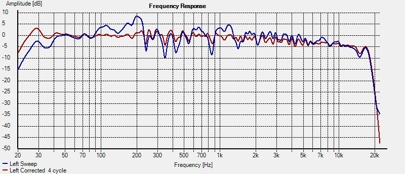

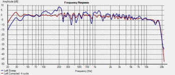

Just for Reference
Below shows the FR of my left speaker - at the listening position - which is 25' (7.6m) from the speaker. It is also off axis, being at the point of the stereo triangle, the center position.
Blue is the uncorrected response, 1/12 octave smoothed. You can see the baffle peak and some other nasties. Red is with DRC in 4 cycle mode, 1/12 octave smoothed.
I will get some measurements away from that position as soon as I return. I am curious to see them.

Going towards a "speaker correction only" at say >400Hz (or even prefereably lower according to setup) and correct just for the anechoic response.
Having an interval of 4 cycles to be averaged, the pathlength of sound ( N x Wavelength) will be
approximately:
400Hz....3,4m
800Hz....1,7m
1600Hz...0,9m
This means at 1600Hz in many room steups just bottom reflection an a reflection from a close sidewall might come into play and >3KHz in many cases there will be no reflection from "structures away/outside the speaker" having influence, so we are arrived at "pretty anechoic" condions then and wat whe do is mainly "speaker correction".

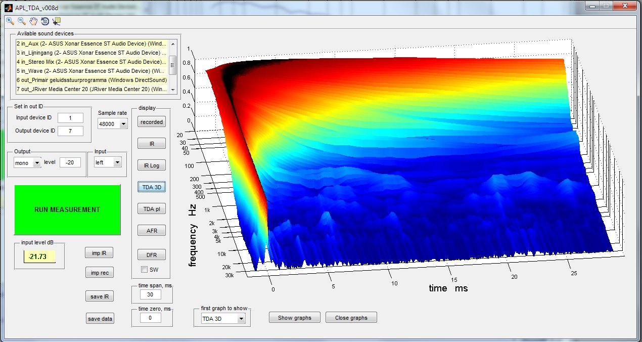

In my 2D APL_TDA graphs you can see what I mean:
You do see that phase isn't linear here, it is minimum phase throughout the bandwidth.
The above graph is made with the demo version of APL_TDA, which hopefully brings this thread on topic again.
No amount of digital signal processing could have gotten me this without using room treatment. I treated the first reflections. With the treatment I did loose a sense of spaciousness. Adding later reflections, between 15 ms to about 30 ms can give you back that sense of spaciousness without being detrimental to imaging or phase behaviour. Still it is not perceived as echo or a separate sound source.
approximately:
400Hz....3,4m
800Hz....1,7m
1600Hz...0,9m

LineArray, to add something useful to this thread, why don't you post an APL_TDA plot of those wondrous marvels you keep telling us about.
APL_TDA is only a measurement suite... no need to fear it. The DSP suite is separate. It will display the time domain behaviour of your speakers.
Plus it would be entirely on topic for a change...
Using the demo version and a screen grab would suffice. So far all you do is talk and ask others for proof. Why not be nice and play along? You'd only be measuring, not manipulating your signal.
