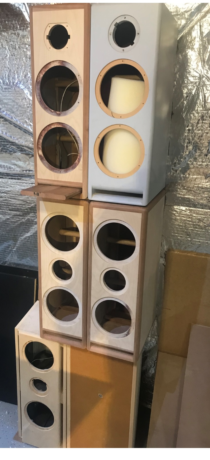

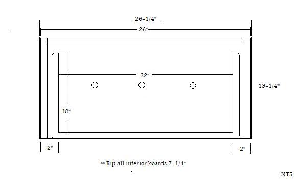

Here's another sketch, for a mdf build. Again I cringe a bit when I see folks cut the sides too small/tight, so avoid that.

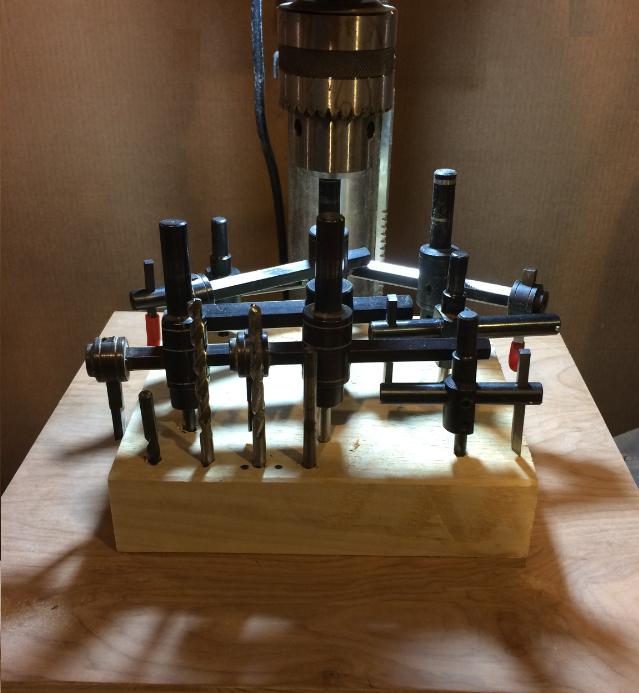

Another construction note about hole cutting, found a pair of circle cutters at flea market - $5 bucks each to add to the collection. I'm surprised they are not more poplar, the are perfect for speaker building, easy, fast, last for years.....
Do you need help cutting baffle boards? Everything is set now to rock and roll.
Tip of the day on circle cutters, replace the supplied 1/4" drill bit with a solid shank for better results.

I have all of my pieces cut out all ready. I wish i had some of those circle cutters you have. My biggest issue was trying to get the tweeter cut out centered. I am not use to cutting circles so small. normally i use the screw holes to find the center hole but the tweeter does not enough holes. i can normally eye ball it pretty good but here a lil off is too off.

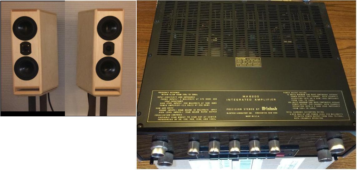

A nice find, thought some may find interesting.
A vintage MA6200, which is less power and older than what I've been using.
ROCK solid base and as advertised "let's the music shine through"
It's a great combination with the Dayton tweeters and the warm sound of this Macintosh amp.
History? Unknown. It's in pretty good shape tho-- runs nice and cool on this 4ohm load.

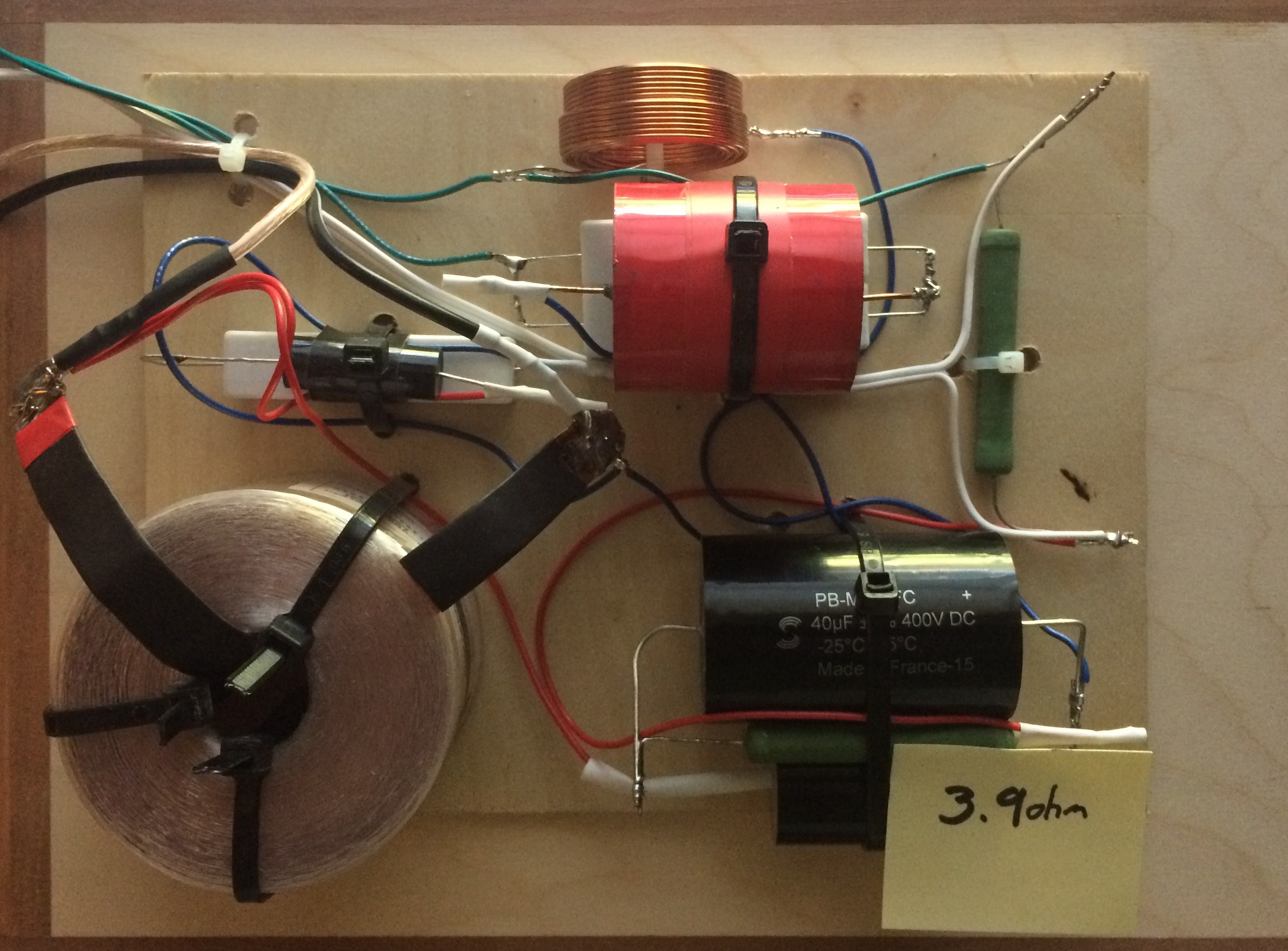

Another success!!

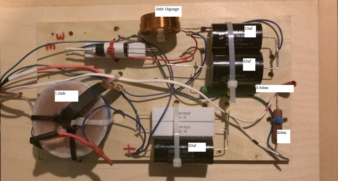

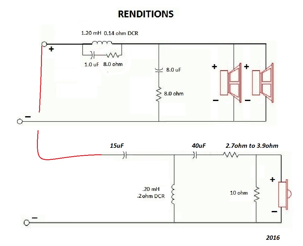

The xo is back on post #47, but added a photo of the center channel xo which has slightly better parts than L & R. (used poly caps for L/R, but they sounded fine in stereo anyway)

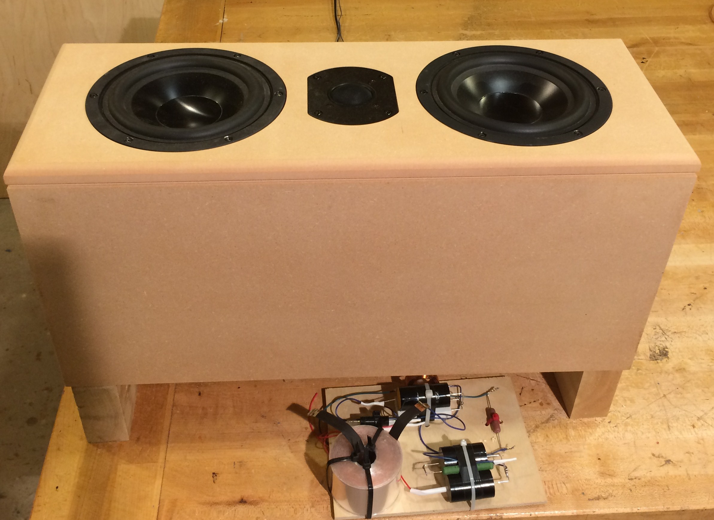

The sealed box ploy on the previous post was a flop, guessing the woofer cones just didn't have enough movement to sound right.
[speakers sealed well, it's super air tight]
Will try it one more time as a sub woofer before giving it the heave-ho.
Going back full circle -- this Rendition MMT works nicely.
Added thin strips of foam in the port(s), to help the 80hz roll-off (HT).

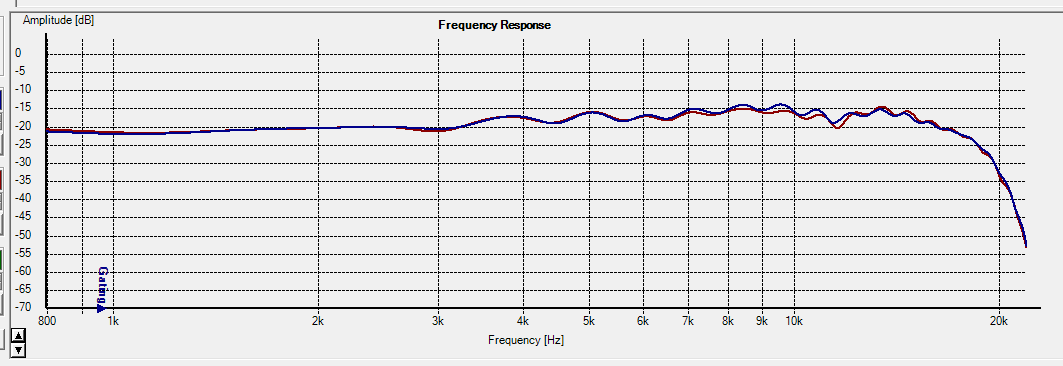

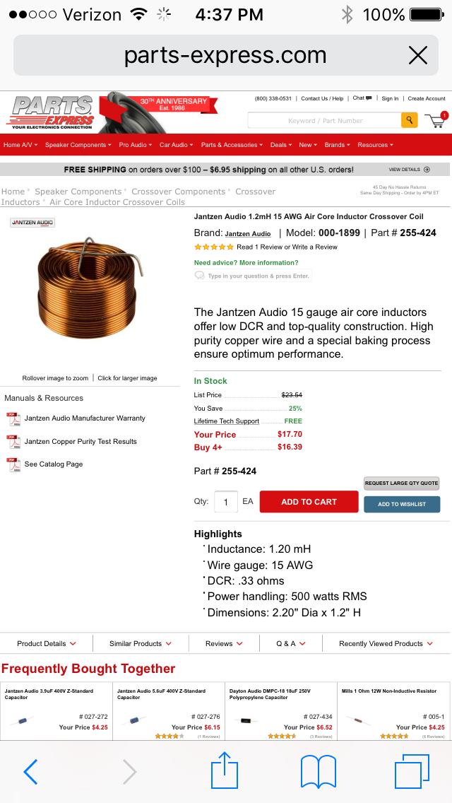

Been dialing these in the last two weeks (something new every day).
This TMM with the 12gauge - 1.2mH foil coil seems to work the best.
Great tone and detail...very nice!
One revelation, they sound best slightly askew.

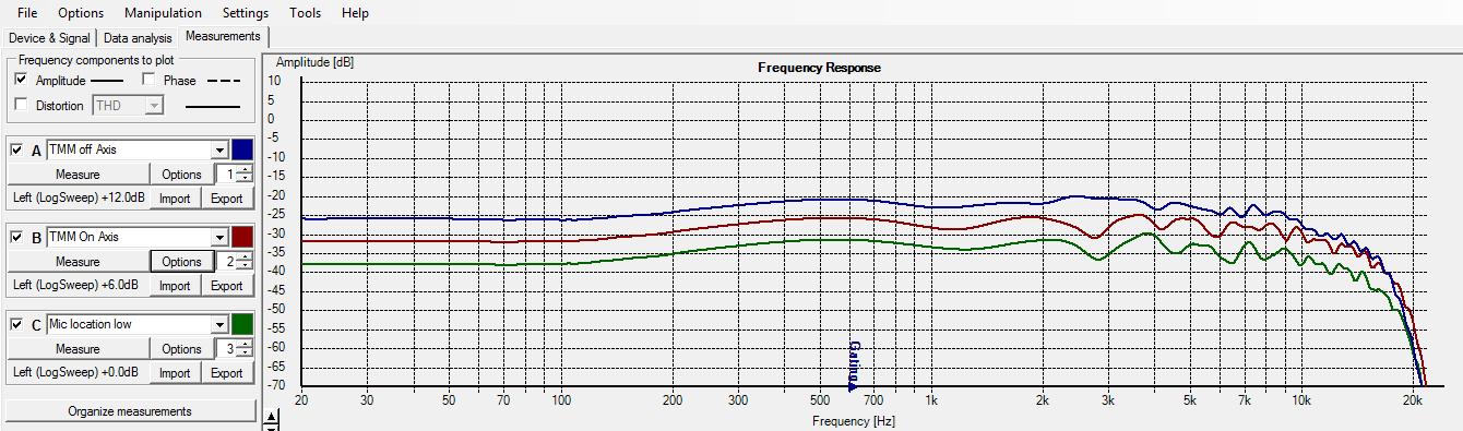

Posting results - all new testing gear in a different room.

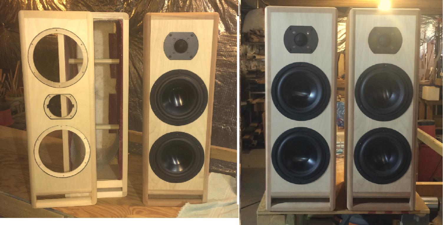

I’m in the process of building these, and just wondered if the middle brace is solid or hollow? Solid seems to really restrict the air space, but I want to be sure. Also, did you guys put anything in the bottom chamber to equalize the weight of the upper chamber? They are going to be very top heavy if I don’t, so I guess I’d go with outriggers... Thanks for any assistance!
beak81champ,
No top-heavy issues and the braces are just 3/4" dowels. So the build is straightforward. The 5/8" port is 7" long, as seen in the pics. The slab of wood is not super tight, so 5/8" (or minuscule over) works nicely.
You're going to have lot of fun, the Anarchy take on a life of their own with the mid bass.
I'm still using a passive crossover for a TMM pair. The HT has MTM's.
Went with a mini-dsp, there; tried 24db, then 18db, but back to 24db with slightly different settings.
The HT has a Anthem AVM60, with Rotel power amps. This is my second AVM60 and never ran the room correction on this one lol. Didn't need too, lol
This is one silky smooth sounding HT room, sounds like the super expensive rooms at the high-end audio rooms (there's plenty around here VA/MD).
Let me know if you need anything.
Doug

beak81champ,
They look great! as mentioned you'll have years of fun with them (I have anyway)
You can always make the foot/plate slightly larger for stability.
Are you using the 8ohm drivers?
The Dayton RS28F-4 tweeters?
XO from the the OP?
XO from the the OP?
Yes, the 8 ohm and RS28F-4. I sent the cover diagram to Madisound and had them build the crossovers. That is not in my wheelhouse yet, but I’m trying to learn that piece of speaker building. This is only my 4th set of speakers that I’ve built.
