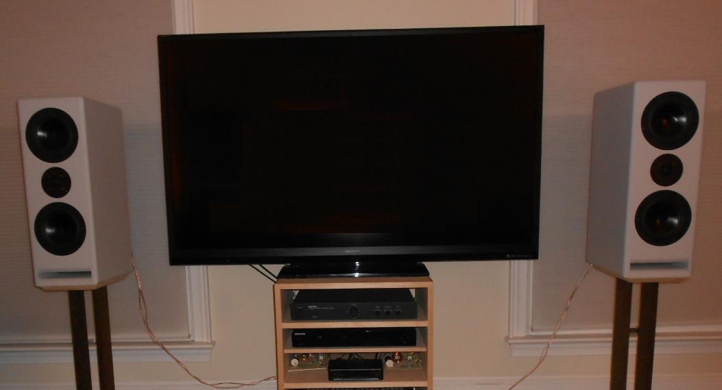

Spent the day setting up the MTM's. Unbelievable sound really, now that said the sweet spot is pretty tight and had to tweak the angle a few times.
Using the passive xo's here, they are not in the boxes and on the rack btw.

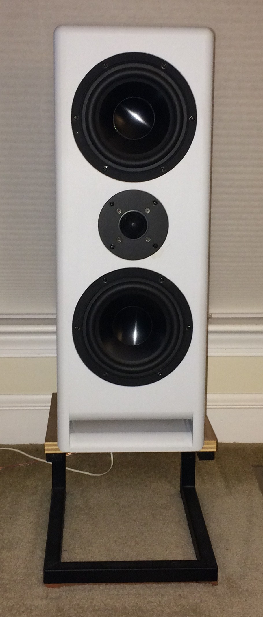

Update: gave up on the short bases, these Star Wars Legs stands work better.

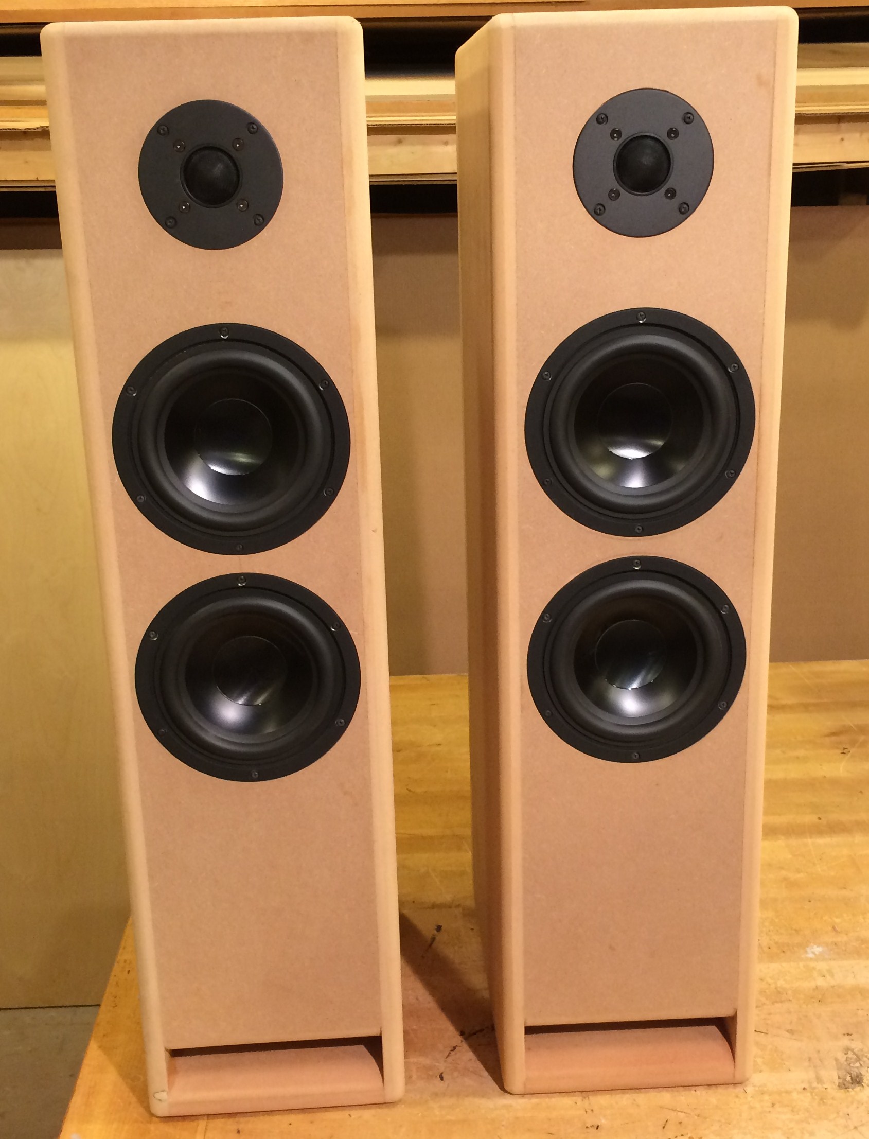

Tweeter is set at 38" center. The mtm pair was a weekend project (using high grade mdf) Thinking where to go from here would be a BB pair.
Adding a pic of the TMM's, which was from another project, but seem to work fine with the TMM rendition xo.
Third pic is another speaker fan 😀

Wife asked the other day, what CD is playing????
It wasn't the CD - it's the new MTM's. The sound just fills the room with a really nice sound stage.

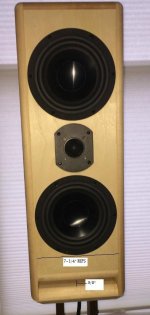

Good enough for me, so started a BB pair.

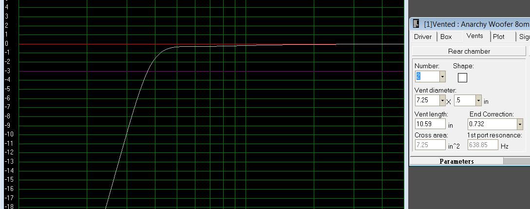

Made the port smaller: 5/8" x 7" which should move the Fs up a bit - high 30's
These cabinets are 8-3/4" wide btw.
One side is not glued, just clamped so can still change port length if necessary.

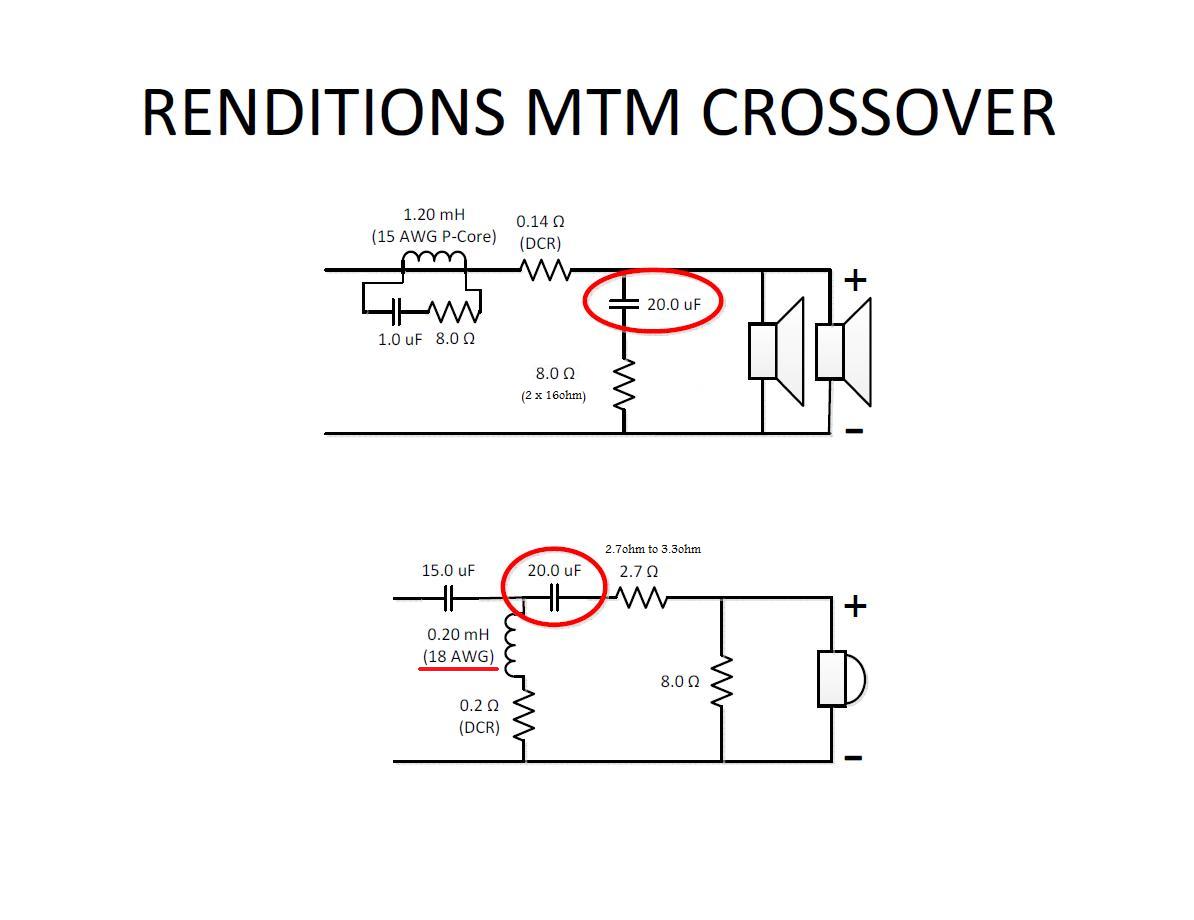

Here's a parts list for the woofer side:

Tweeter:
Highlighted the .2mh 18AWG coil, the 18 AWG .2ohm is important.

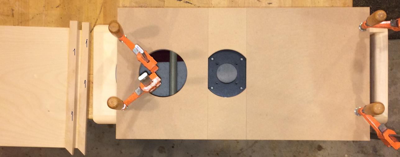

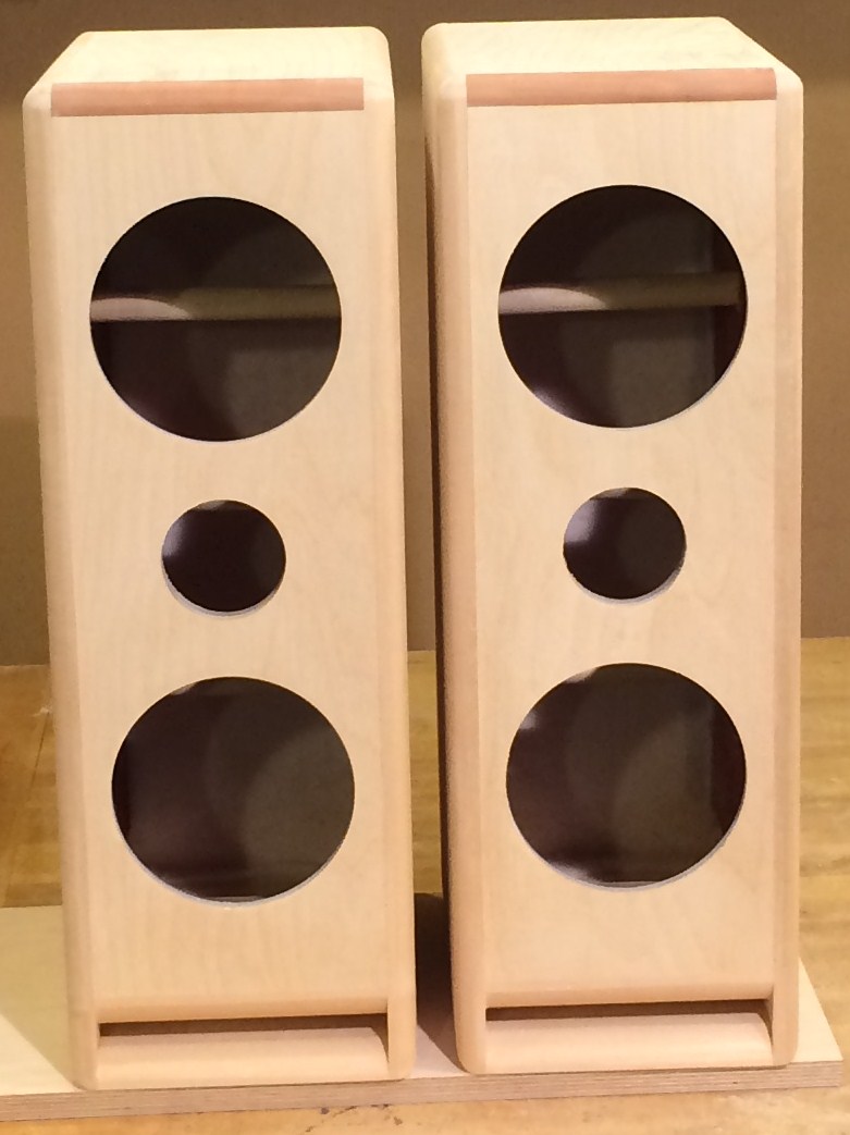

Constructiuon Tidbit
Made an easy/fast/accurate 4 piece tweeter template out of scrap, the steps are:
Cut round hole to the 4-3/32" size, mark and cut carefully and then glue it back together with 2 square boards as shown. Now I did say it was easy 😀
The upper circle is the standard 4-3/32".

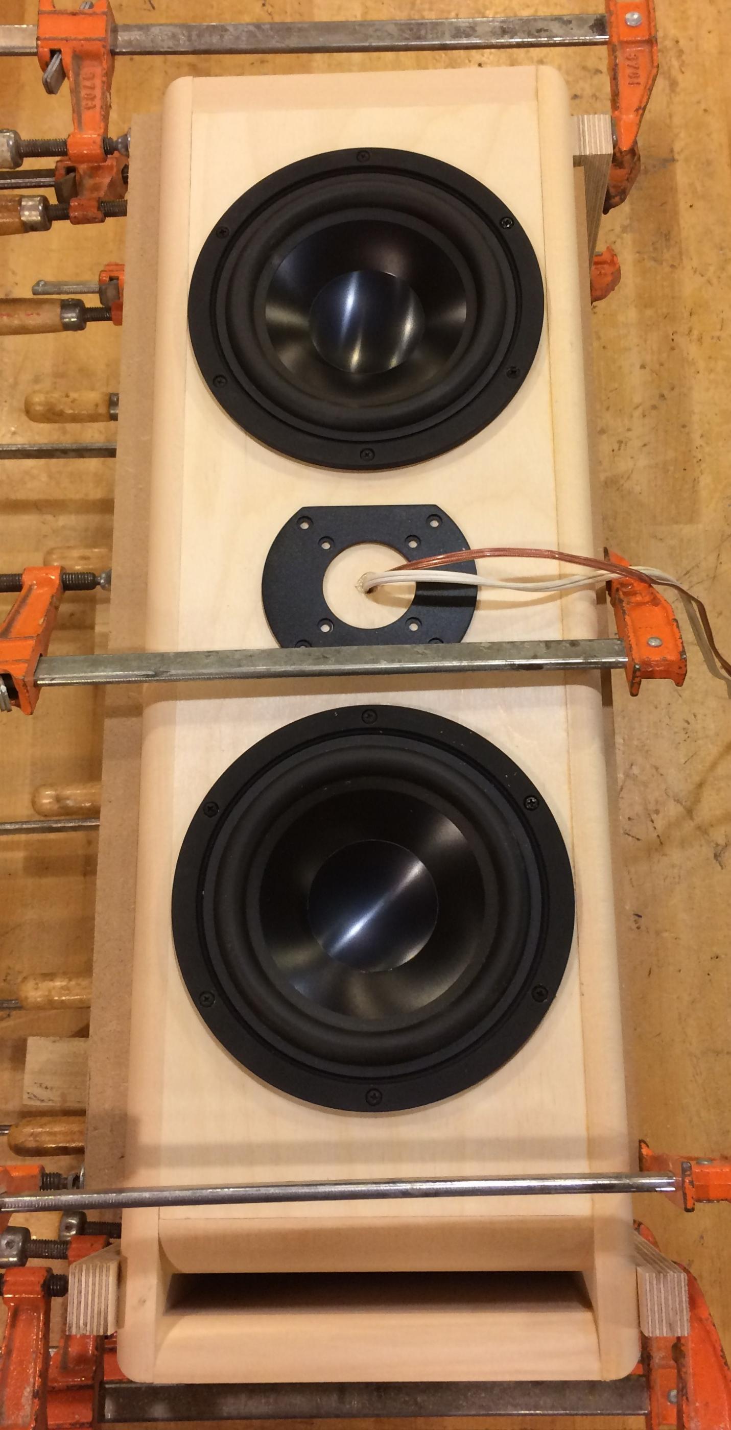

The BB boxes are turning out well, no miters except the 3/4" x 3/4" wood edges. Mark the wood grain with arrows and orientate the grain so there won't be any tear-out when rounding over with router.
btw - the woofers are 12" CTC.

Last if i wanted to split the port in half and have one on each side would that cause any issues?

Two ports, yes, this driver was already loaded in WindIsd so made a few clicks:

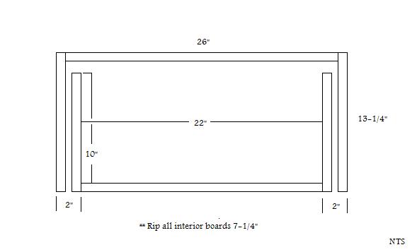

As i am measuring out the cuts i realized a few things. the ports are a half inch wide on each side??? and the height is 8 inches in total including top and bottom???
Woofers closer together work better, not really depends on the design.

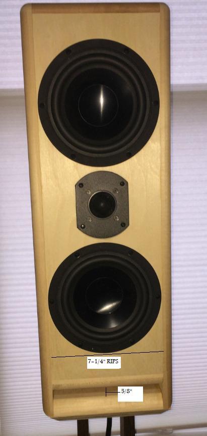

The ports on post 55, yes 1/2". Have 4" x 4" spacers (aprox.) ready for layout, building and assembly.
The final width is 8-3/4" but just work to the "rips". There would be over 8 feet of 7-1/4" rips per speaker. It's important to cut the pieces at the same time and get them as uniform as possible.

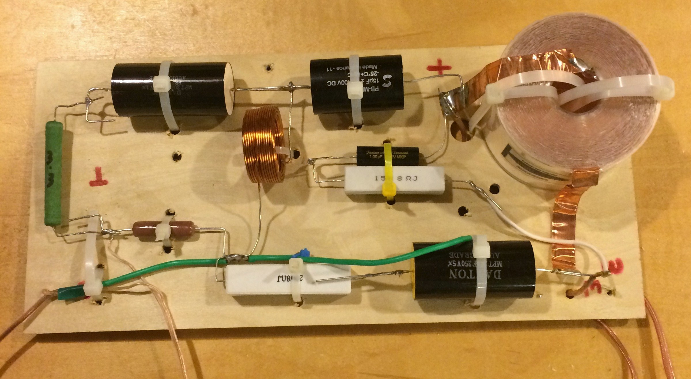

Here's a few pics, including the xo. Don't look too close, it's been taken it apart and put back together a few times.
Oh the BB boxes are awesome, the few small mods and better wood did make a difference 😀

That works i wasn't sure but i got you. I don't see the speaker input on the crossover.
