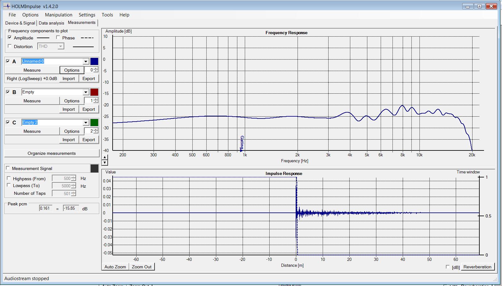

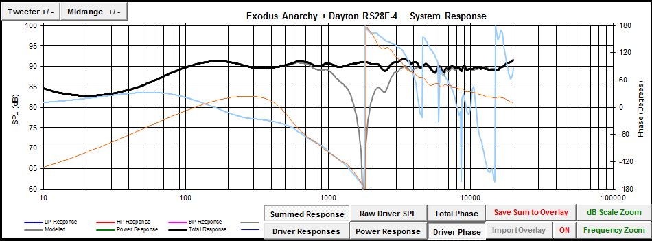

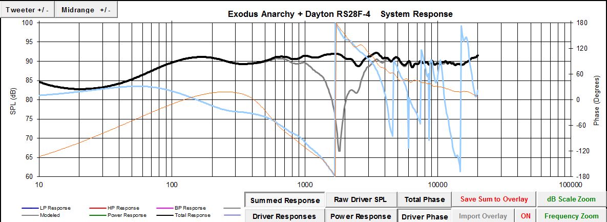

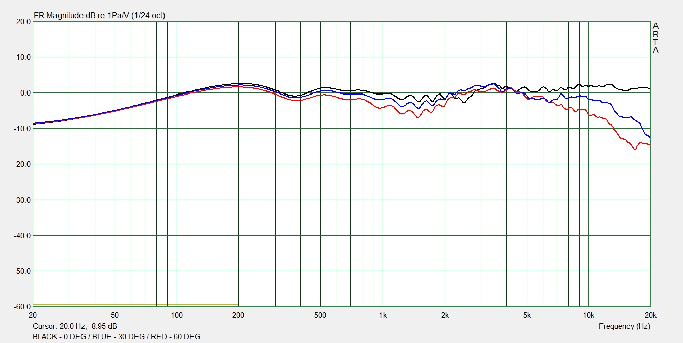

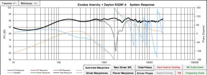

Originally, I built this Anarchy TMM system using 2 8-ohm woofers wired in parallel, mated with a Dayton RS28F-4 tweeter, as an active system. The active crossover was done with the Behringer DCX2496, but I also liked having the flexibility of using these as a passive system, so I modeled a crossover in PCD. The actual measurements came out to exactly the same as the sim, so I was quite happy with the results. After running it through a variety of music, the Renditions are still my favorite speakers. Bass is insane, and the RS28F tweeter proves to be one of the best values out there. Here are some data on the build:
- Crossover frequency: 1,800Hz
- Box Volume: 1.0 cu.ft, tuned at 36Hz
- 2nd order electrical on woofers, 3rd on tweeters
- 9 total components, so inexpensive parts overall
Hong
Hong

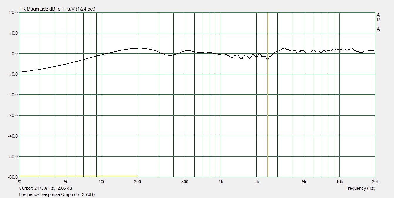

Do you hear any comb filtering?

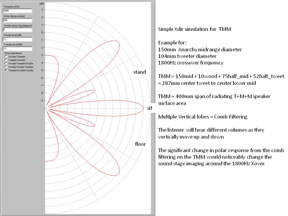

When I run simple polar simulations like Xdir for a TMM topology speaker with 6" midranges I usually observe comb filtering issues, which moves the design to a TM-WW 3-way. I like the idea of adding a real 6" midrange like the SB17NRC35 (Mms=11g, 92db sensitivity) and using the two Anarchys (Mms: 30g, 84.5db sensitivity) as woofers in a separate box volume with a separate Xover. The midrange crossover does become more complicated.
One example for:
150mm Anarchy midrange diameter
104mm tweeter diameter
TMM = 150mid + 10wood + 75half_mid + 52half_tweet = 287mm center tweet to center second mid
TMM = 400mm span of radiating T+M+M speaker surface area
You describe a TMM topology, with both M electrically connected in parallel and using the same passive Xover. Around the crossover frequency all three speakers TMM are vibrating and generating air pressure waves. Think of the total TMM surface area as a collection of vibrating points spanning ~400mm from top-of-T to bottom-of-M, which arrive at different angles/times to the listener's ears. A 1800Hz wavelength is 190mm (7.5") long. At frequencies around the crossover the air pressure from one vibrating point arriving at the listener from speaker angleX can be inverse to the air pressure from a second vibrating point 190mm away on the 400mm long surface arriving at the listener from speaker angleY, and interact(X*Y) to cause a lower pressure(SPL) at the ear. Around 1800Hz, a seated listener can hear a different SPL, from a standing listener, from a listener laying on the floor. At frequencies around the crossover... lobing..... comb filtering... describe this change in vertical SPL. The significant change in polar response from the comb filtering on the TMM would noticably change the sound stage imaging around the 1800Hz Xover.

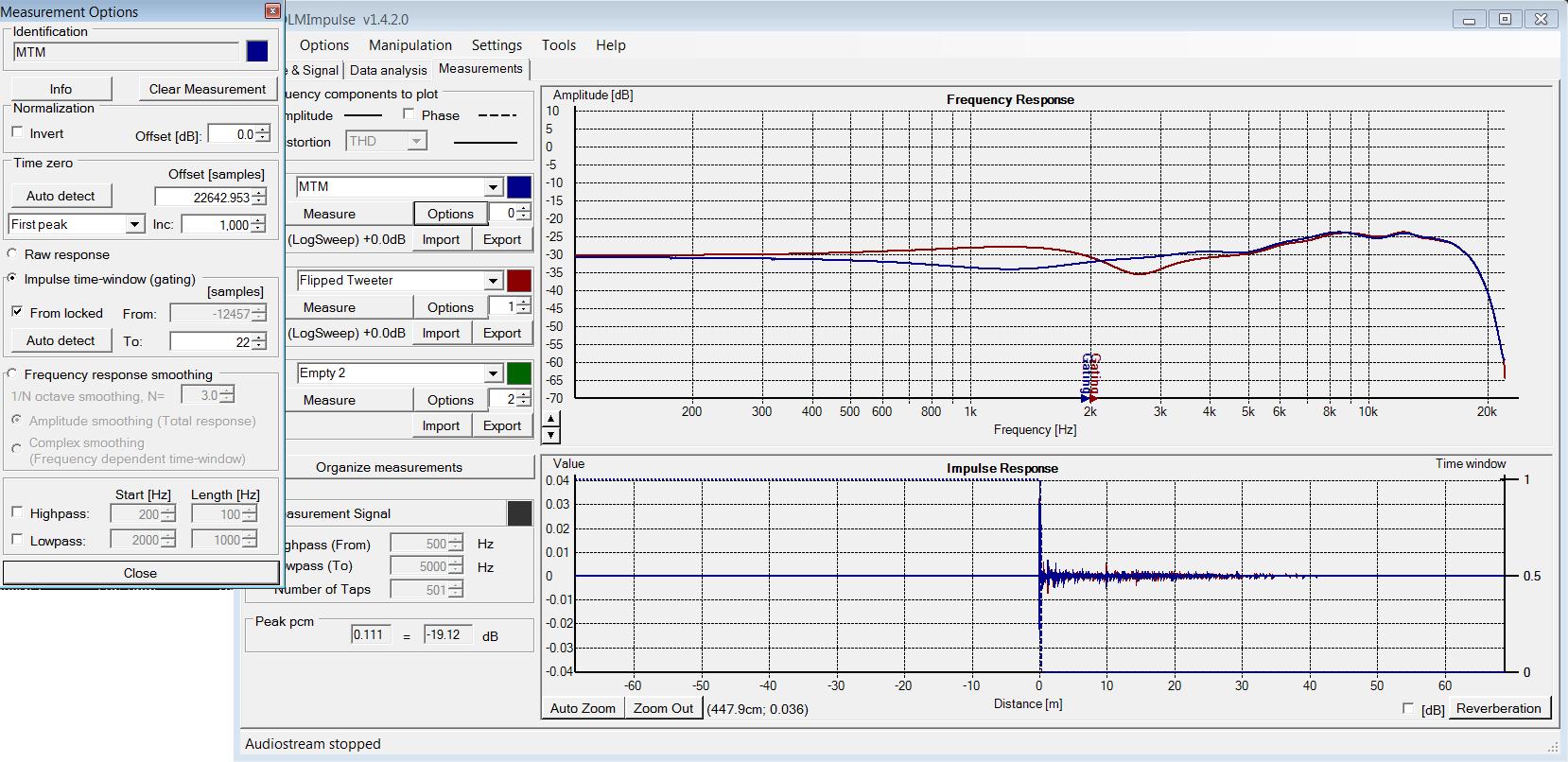

I was asked if the crossover worked for a MTM configuration, so I modeled one as well. Thanks for looking.

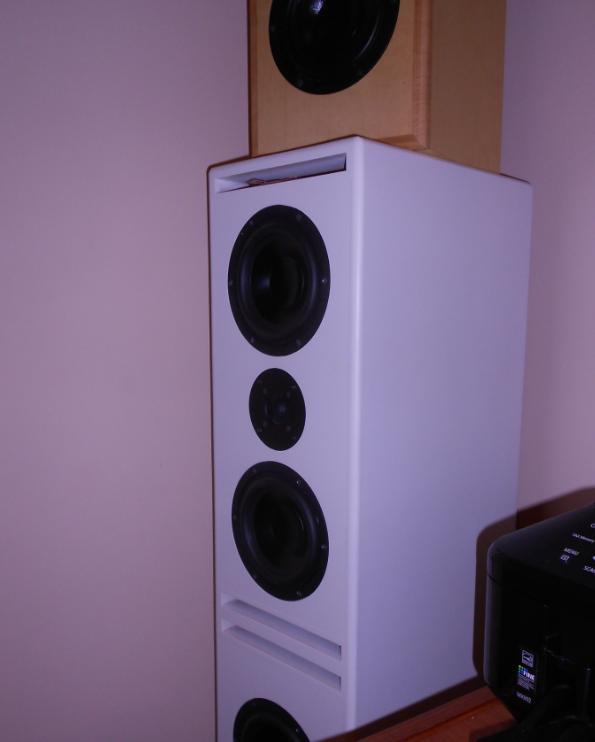

Ok Hong! Way ahead of me, no xo here, using these for speaker stands right now.

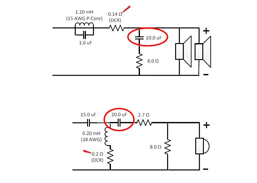

Have the parts to mock these up, except the 0.14 and 0.2 ohm resistors.
They seem really small for a xo circuit - am I missing something 😕
The small resistors are the DCR of the coils.

For simming the 1uF is not connected correctly.
I did this design for many reasons.
1. The tweeter is at ear level when I'm sitting at the listening position, so the height of the tower ended up being reasonable and the design pleasing to the eye.
2. Comb filtering being a vertical phenomenon, my listening distance 20 feet away, I rarely listen to music lying on the floor or standing for hours, so this a non-issue for me. In addition, I use a DEQ2496 to correct minor room modes, so the end result is a virtually flat response overall.
Thanks.
sreten, the 1uF cap is part of the parallel RLC notch filter, in series before the crossover, so I don't understand your comment here.
Hong
Hong
It should connect across the coil and its DCR, it's a minor point.
rgds, sreten.

Doug, this is the resistance that comes with the inductor, so picking a different gauge or type of inductor may result in a change to the crossover frequency response, phase and impedance. The difference may be insignificant overall, my values are a just starting point, so you can experiment and go from there.

Yes, all coming back to me now.

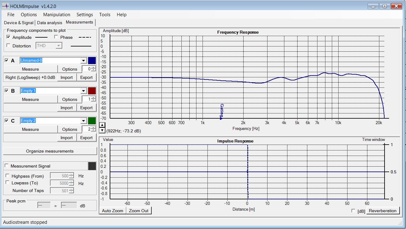

Here's one done, sounds nice, powerful/efficient.
(the red line is tweeter leads reversed)
[had one 1.2 14 gauge air core on hand]
Checking now to see if woofers are in series 😱
Ok 4ohm connection now; thinking the 2 woofer coils are attenuating the middle a bit.
Of course the bass is stronger.
Hong,
We are having a blast with the new xo, and again only had enough parts for one. The ploy was to mock up and measure before ordering parts.
It's connected to a small Luxman R-114 receiver - hard to believe the bass pouring out from a small amp and small 6.5" cones
This box is slightly bigger, 1.3cf (net) and double 9" x 3/4" x 18" ports (243 square inches). The material is 16" shelving board from local lumber yard, although as bad as that sounds, it is a nice solid grade of MDF. The seams didn't move much in the last couple of years, which is pretty common with MDF. Will rebuild with BB someday. The tuning is 40hz (I think, need to recheck).

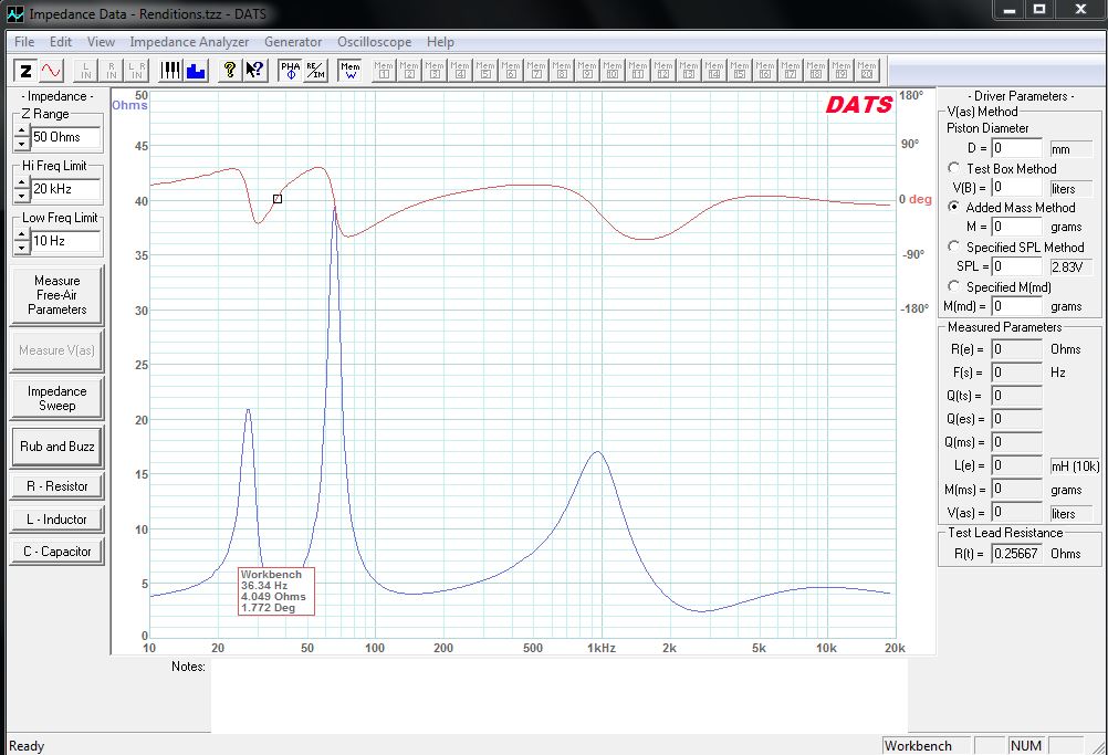

Doug, just run an impedance sweep. My box was tuned at 36Hz, so yours may be lower due to the larger size.

So my 10.5" wide box is .3 ft3 larger and tuned to 35hz (slightly lower).
I'm curious if the wider width will affect the baffle step diffraction, more or less bass. Not that I'm complaining, the bass is terrific.
