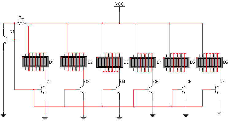

so Sy, you can golf your age?
And,......nice circuit. The far east and anyone under the age of 15 will love it! But the LED's need to be blue.
Too simple,as well, needs more transistors, maybe a few more caps and resistors, buncha compensation and feedback circuits,and presto! a transistor amp in disguise.
Is this where you guys gather together and throw me off a cliff?
But serially..a very nice and simple circuit. Just the way I like 'em. Tiny parts. big sound. The circuit is pretty. Always a good sign.
