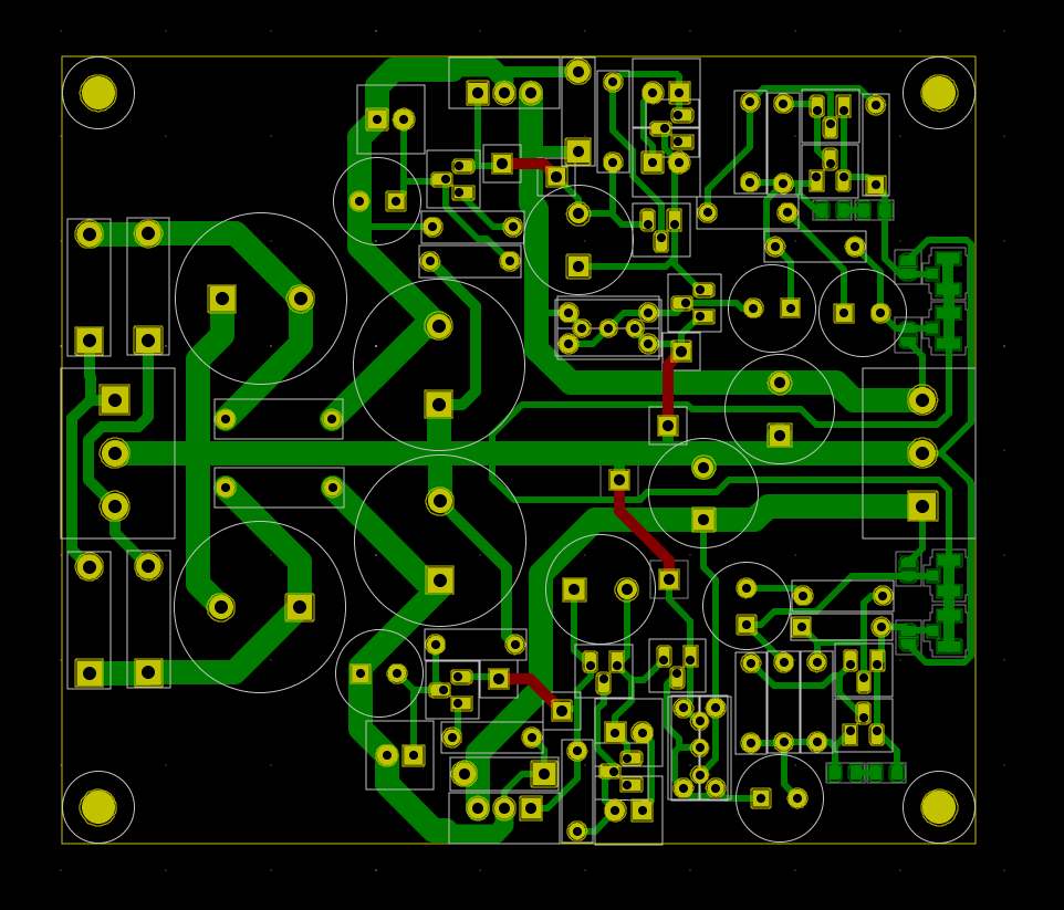

Make sure there's 1.25V between the 317's output and adjust pin. And that there's something like 10V from output to input of the 317. And, of course, make sure that your B+ to the regulator board isn't low.
OK, theres a problem there alright. Voltages between those pins are only 800mV and 300mV respectively. I'm wondering should I completely rebuild one. I've checked resistor values, even pulling some off the board to check. I noticed I did touch the side of the pot with the iron, but when I took it out and checked it resistance I had from 20K to 100K, so it must be OK.

I'd check the pass transistor and the 317 first. If you miswired something, they're toast.

OK,
I put back in another 317 and tip50, but the result is the same. I also put in another zener when I was at it.
I've just gone back and re-read the bit about the circuit board, and pinkmouse made a comment that he thought he used a different transistor. I wonder if thats whats wrong. Looks like I may need to order some more parts.

Someone suggested to me via email that you may have burned your boards backwards. You might want to check that.
In general, if something causes a transistor or chip to pop, substituting another one will just cause more silicon-to-carbon transmutation. One needs to get to fundamental causes.
Thats all possible. When doing the boards I just copied the layout from pinkmouse right onto the copper and dropped in the components as per the list a post or so after the PCB layout.
If that was a mirror image or something then thats that.
I will order up some new parts I think and maybe just wire it P2P not on a PCB.
I will try subbing in a resistor for now just to see is the rest working. If I have screwed something else up elsewhere and need more components, I want to do all that in one order from mouser.
Fran
Fran
Or you could burn the PCB right way round. But it's an easy hour wiring P2P on a couple of perf boards.
