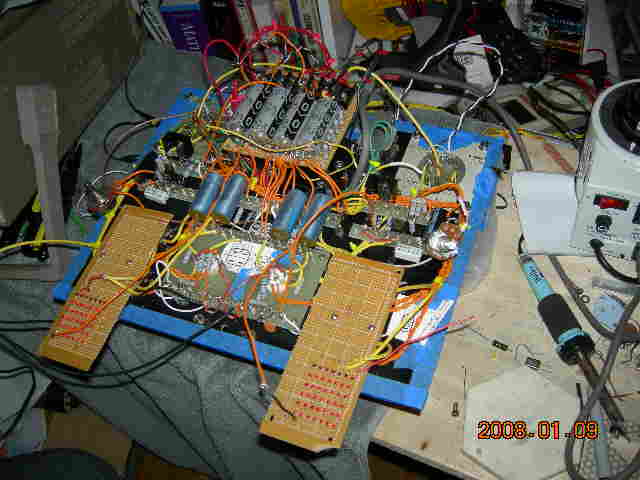

Almost Finished RLD
It may not look pretty yet but I assure you I already put 50-100 hours on it and it sounds nice. I found that had to go down to 5 rows of HLMP6000 leds to get my EL84H's to bias up at a reasonable voltage.
Dont make the same goof I did. If you like to operate your unfinished amp upside down keep in mind that the voltage drop across the LEDS has some temperature dependence I was wondering for days why I had to keep chasing the bias set point for the first few hours of operation whenever I turned I on.
Am I the only person that just can't ever seem to straighten out those last few wires and put a box on anything?

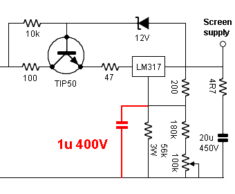

Wouldn't it be a handy idea to build the screen regulators on a little PCB? Even if it was just the marker on copper-etch-clean method?
Has anyone done this? Would you like to share your design?!

OK,
here is a rudimentary sketch of a possible layout - it just follows the schematic but labels up the pins etc.
Could you look it over and tell me how wrong I am (I ain't good at all that stuff).
Fran
