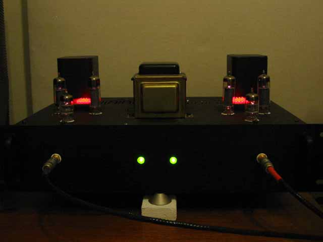

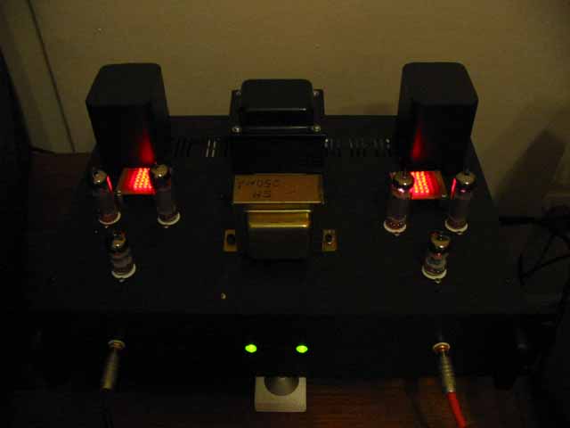

from the front... 😀

Well done, can you give us a photo with the light on of the top and underneath please. Did you find it easy? what part was the hardest? how about soldering all the leds together did you find that easy. Your thoughts and imressions please. What size is the chassis?
kopite said:Well done, can you give us a photo with the light on of the top and underneath please. Did you find it easy? what part was the hardest? how about soldering all the leds together did you find that easy. Your thoughts and imressions please. What size is the chassis?
No photos of the underneath, it's a big mess down there!
For me, the hardest part was to get the EL84s to bias at 85mA! It seems my tubes were biasing low. Thanks to SY's help and advice, I managed to get it up to 80+mA. Otherwise the rest is pretty OK for me. Solering the LEDs together on a prefboard, like SY did, is not all that difficult, you'll get the hang of it after a few. I like the sound, really got no complaints at all. Previously I've heard the sound from a EL84 in pentode, and it was slightly "unrefined", with regulated screens like the RLD, it's much smoother. No problems handling anything with my speakers. The chassis is about 12" by 9", recycled from a previous project.
