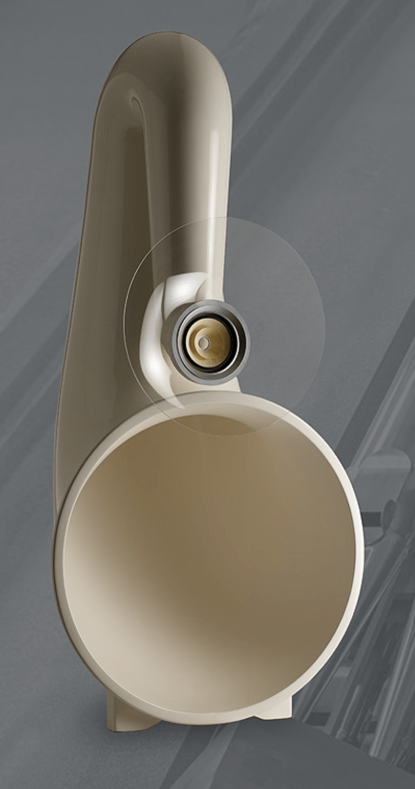

Model Aerofon is a real back-loaded horn.
Model Pnoe is a real back-loaded horn, with short waveguide in front.
Model Axjet is a real back-loaded horn, with (real) short horn in front.

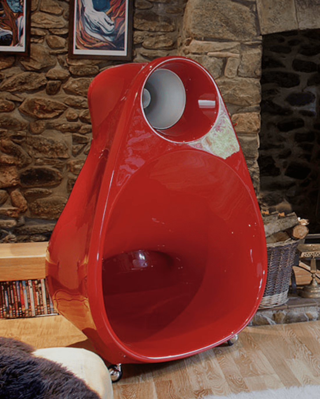

Model Pnoe is a real back-loaded horn, with short waveguide in front.[/QUOTE]

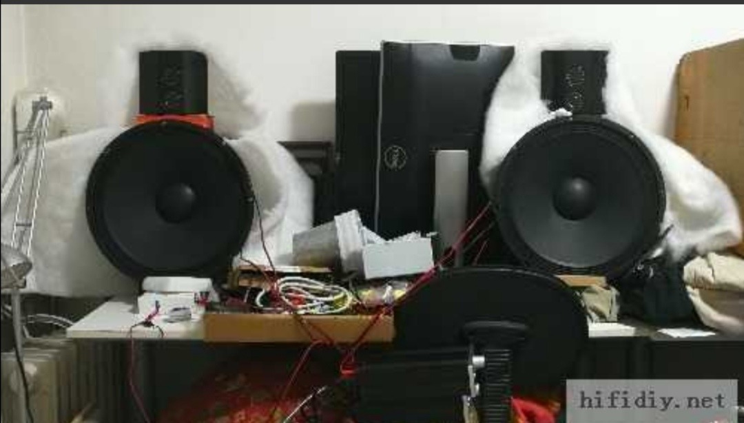

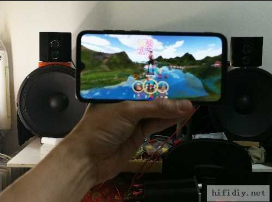

People, please note vkung's use of limited attic space and very low eaves to turn them into practically rear corner horns, (probably) listened very near-field considering the size of baffle.
I have tried 15" widerange baffle-less by sticking the magnet into a 6.5" cab driver-hole, back cloaked with a thick/dense wad of stuffing, against the wall on the desk at the foot of my bed in a small room. Surprisingly, bass was not a problem for most acoustic instruments. I easily preferred the naked 15" cello to my 8" or smaller TL speakers. Dubbed the Elfenu15. (Tweeter was True Unobtainium, dipole Mantra Sound Naturelle; of course ctc rather large.)
So I can believe a much larger open baffle/waveguide will handle the doublebass (which I listen to often on small TLonken just fine). I think extreme bass clarity reduces the need (or desirability) to play accompaniment loud, relative to the lead instrument or vocal; in fact, live music balances them that way.

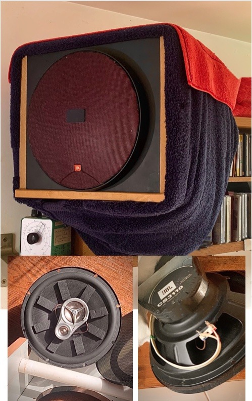

Honk-hoot-boom... fed up year on year with the sound of boxed speakers up to my price point of about £300 each, I tried a neglected pair of 12-inch JBL chassis, type CS3110, naked and unashamed. Used only enough wood, about 4 inches deep, to hold things together, and zigzagged to minimise what baffling remained. Then, a stuffing of Auralex foam and bath towel, extended rearwards to absorb much of the antiphase.
Cone resonance is there for sure - but well tamed by glueing on 8 dense radial foam strips.
A touch of EQ adds some 'body' and two subs take care of everything from 100 down to 16. Yes, I am an organ freak, but also love good orchestral and choir sound, clean harpsichord and natural voices. This low cost untidy stuff really delivers!
Last time I heard a fine speaker was when I recorded through one when I had a job at the BBC - the original LS5/1 plus its onboard AM8/1 valve amplifier. If someone unexpectedly talked near a studio mic, you'd turn to answer until you realised it was the speaker. With most it's only too obvious.
