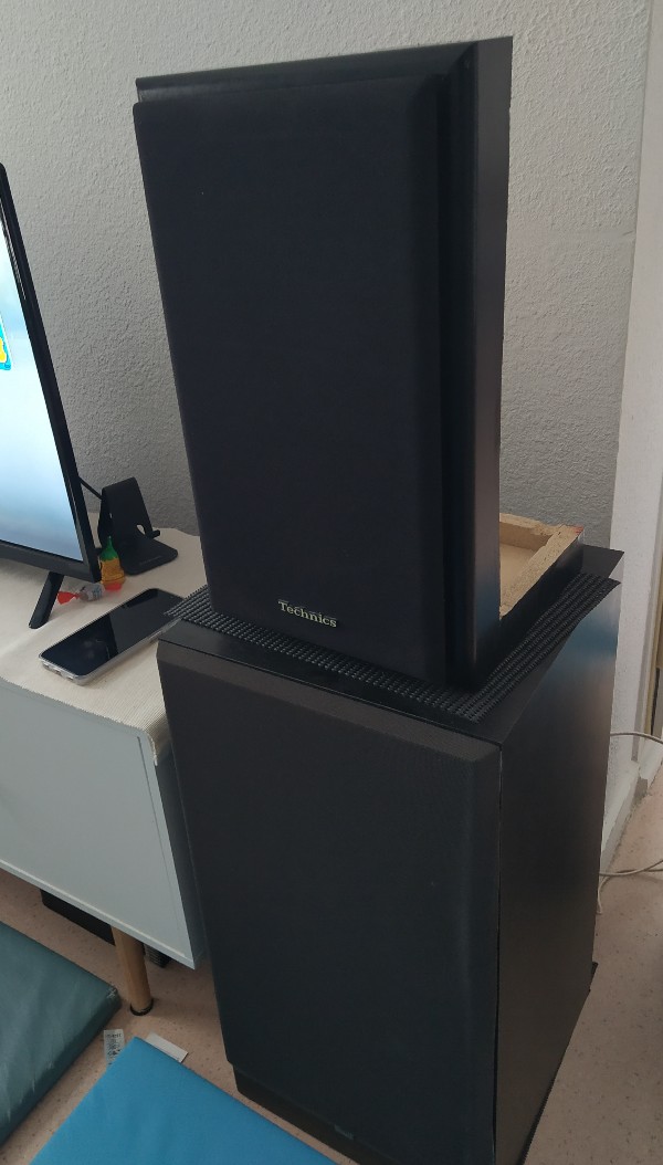

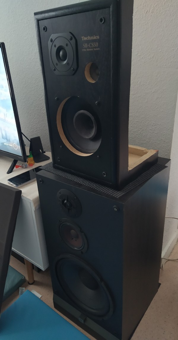

I find this thread interesting. I've been a fan of OB, (had a full size OB before with Eminence Beta 15 woofers and Visaton B200 fullrange).
But, as I have changed residence, new domestic conditions dictated the new kind of... boxes?
Well, at first I got back to bixes, as it was the most "logical" thing to do. But, soon I missed that OB sound.
So, still no place for 15" woofers (space being limited to 10 " or so).

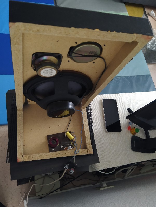

So... I got some old JBL speakers cheaply. And they played cheaply. But, at least the box was good, and it fit the space requirements. Then, after a while, I replaced the JBL woofers with Monacor SPH250-TC. It was a straight drop-in replacement and I closed the BR port. With the second order crossover at around 250 Hz, it plays very nicely.
Then the idea was to make a Waw wich I did. While not bad... I still missed the OB sound.
That is, until I took a handsaw and literally cut the box.
Then, experimented with various fullrange speakers...
Currenly using some old Siare fullrange. Until I get something better.
But hey it works!
There are two areas for future improvement:
1. Better fullrange speaker
2. Ripole instead of a bass (closed) box...

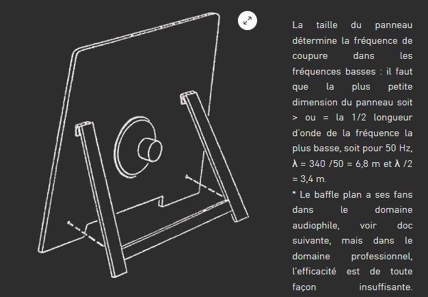

Below some documents giving explanations of this acoustic short-circuit phenomenon - sorry, some are in French :
From SoundPractices / Claudio Bonavolta website :
From the book "Les Haut-Parleurs" de Jean Hiraga :
From the tlhp website ( https://www.toutlehautparleur.com/charge-acoustique-enceinte#:~:text=Le BAFFLE PLAN&text=Soit L la largeur de,a lieu à 114.5 Hz. )
Let L be the width of the plane baffle, and C be the speed of sound, the acoustic short circuit occurs at the frequency F=C/2/L.
For example, for a plane baffle 1.5 m wide, and a sound speed C of 343.4 m/s (at 20°C), the short circuit takes place at 114.5 Hz.

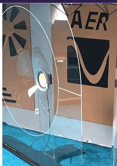

To be honest with you.. I do not think the panel is matter. It is the horn matter. Once you have the horn 98% of sound is from the front.. The placement of the speaker is easier..
I use 650mm in the shows and 1280mm at home. The difference is huge for bigger horn. According to Filip from AER, he told me 2000mm horn is
another level
Please read the comment of Filip from AER
Please refer to below Google translation in English:

I think there is a disconnect here.
vkung, you're talking horns. Horns act like a lense to focus the sound.
tubelectrons is talking OBs. OBs simply provide a barrier that separate the front waves from the back waves to reduce cancellation below a frequency that is dependent on the size of the baffle.

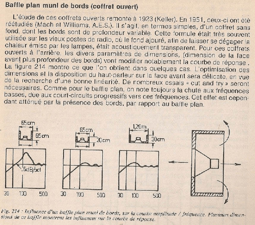

Notwithstanding your thinking, width of the panel/"horn" do matter. Look at the Figure 214 from the post #124 by @tubelectron - OB in the middle has total width of 65+2x20=105 cm, which is very close to 128 cm of your AER Excenter. As you can see, below 100 Hz output is dropping. It is not just a "theory", it is a real science theory based on real life observations and backed by literally many thousands measurements (and listening, too) in the past 100 years.
But you don't need to look at the theory, see what the manufacturer AER wrote on their web-page for the AER Excenter with 128 cm "horn":
  • Frequency response: 100 Hz – 70 kHz
So, if you choose to not believe in the science theory, you should believe what the manufacturer AER say about the bass capability of their speaker - only 100 Hz! That is why AER recommend subwoofer with the Exciter model:
"Excenter comes with our active Subway subwoofer for the low frequency range." (Quote from the AER web-page)
I don't want to dive in the more elaborate things about their so called "horn", because it is not a horn but a short waveguide, with no capability to reinforce the bass range. The depth of that so-called horn is only 22 cm - exactly the same as any 1000 Hz capable professional high-frequency horn!

OK - so let's simply calculate :
FC=C/2L
Where :
FC=frequency cutoff of the baffle, in Hz.
C=340m/s=average speed of sound.
L=smallest dimension of the baffle, or minimal radius, in meters.
Since the baffle equivalent is 2x2m, the speaker at best is placed at the centre, so the smallest dimension is 1m
FC=340/(2*1)=340/2=170Hz
The low frequency cut off of that baffle is circa 170Hz. It means that the sound level will decrease at a 12dB/Oct. slope below 170Hz and, possibly reaches 18dB/Oct. under the FS of the loudspeaker.
The included horn pictured here by itself brings a slight curvature which extends a bit the smallest dimension, but IMHO, this would not change significantly the calculation of FC, since the lenght of the acoustic short-circuit is similar.
Now the placement in the room and its dimensions have an influence about the bass response and can potentially enhance it, but it's a case-by-case basis IMHO.
Either it's about Open Baffles or Horns, a low frequency cutoff drives to a large dimensions construction, or to the use of artifacts like angle placement to complement the missing dimensions - think folded horns like Klipschorn, among others - or use of a subwoofer system.
