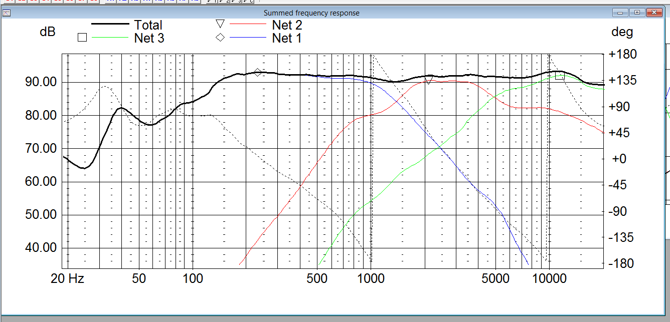

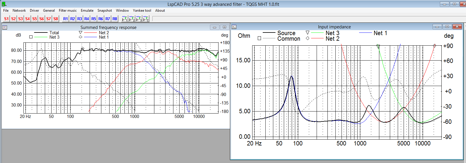

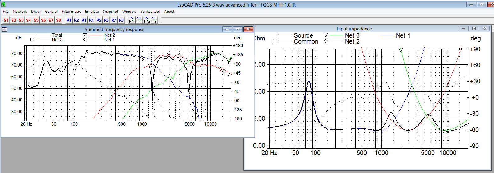

Crossover frequencies came out at 1.39 kHz and 4.81 kHz.
Voltage sensitivity is good at 92dB, 2.85V, 1m but it is also around 3 Ohm.
The woofer is 8 Ohm and has less voltage sensitivity. A passive crossover is possible with an autoformer or resistors before the midrange treble.
I decided on a simple active system though. The midrange treble gets a 6dB inline filter ( cap before the amp ) and the woofer gets an active crossover.

I would have driven the mid lower , into the 500 hz region, 500-5k, I find the woofer rolls out way too early , it will affect tonal balance, 3 db down at 100hz is tolerable ...
just to be sure to understand.This one works well is is inexpensive :- S-1 aktive Subwoofer + Satelliten Frequenzweiche "
theres no high pass on the mids also. the active devise put a highpass for the mids and low pass for the woofer?
Maybe here is a misunderstanding.
Post 103 shows the midrange, the lower tweeter and the higher tweeter.
It does not show the bass.
The bass has the S-1 crossover and a separate amp.
The mid-treble ( post 103 ) goes over another amp.
That has an input impedance of ca. 15kOhm. That amp has a 22nF cap in series.
The system results in a crossover of ca. 300Hz.
The in room response looks rather flat. It does not suffer from the Allison effect because the bass is near the floor and the crossover to the mids optimally chosen.
