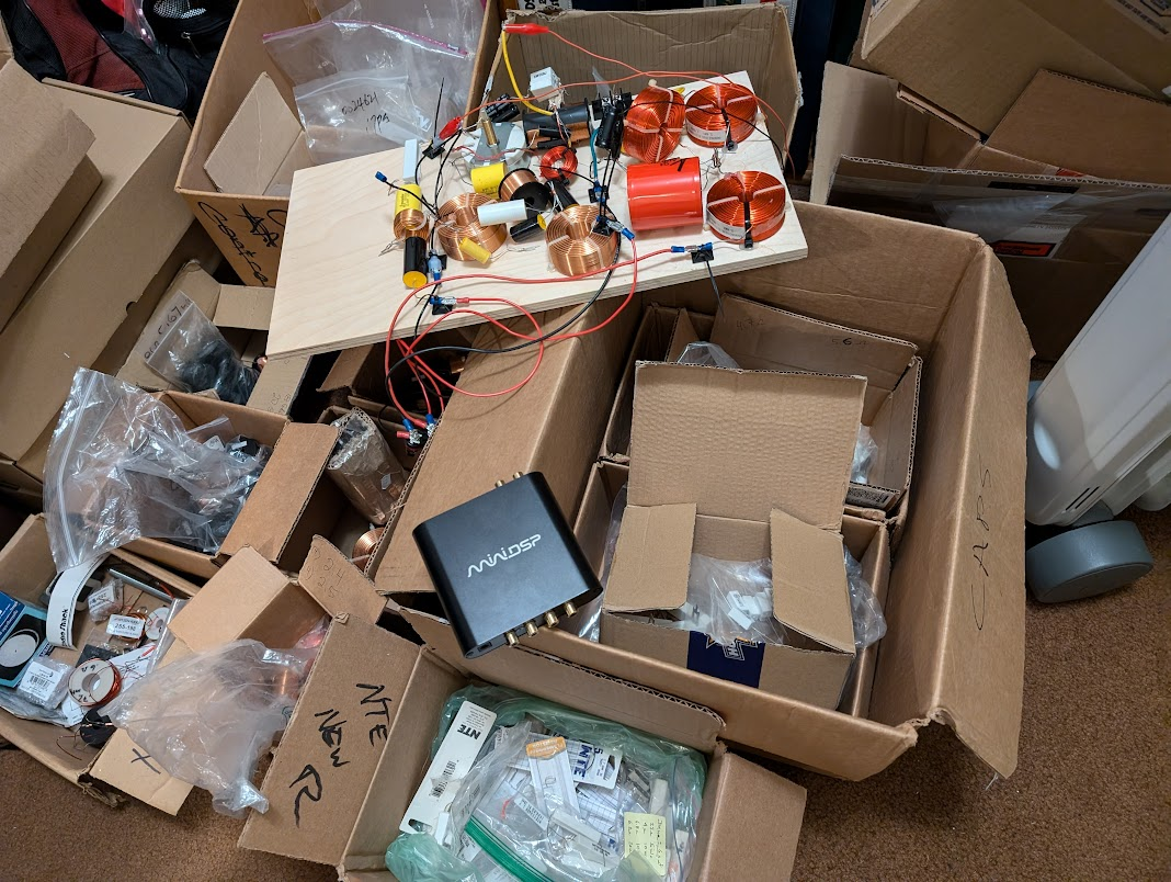

Here's how it's going. I checked the wrong box in boxsim so the low frequency part of my measurements were ignored. So that first crossover in the picture is junk. Xsim4 locks up and won't open the files I saved. The woofers were so far out of spec, they don't play nice in the boxes I built. Yeah! With this large quantity of cardboard boxes holding maybe $1000 of coils, caps and resistors, I still have to use two or three together to get a value I need. Failing that I am still relying on parts from friends today to get to the finish line. The small black box ... never mind. If it was easy it wouldn't be as much fun!
I know; put the miniDSP and amps in a shoe box with a battery and divider at the input, tape it up with lots of duct tape, and tell the other folks that it is a breadboard crossover!

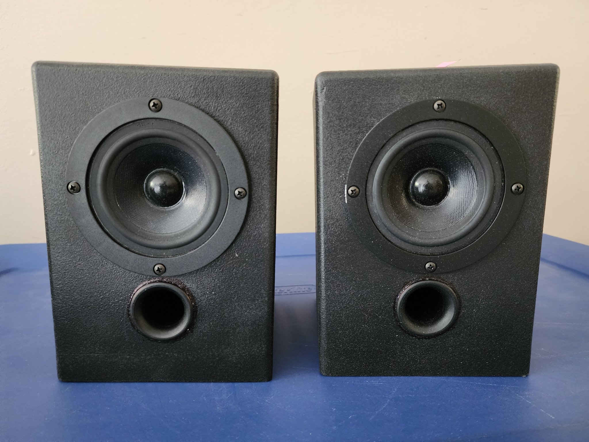

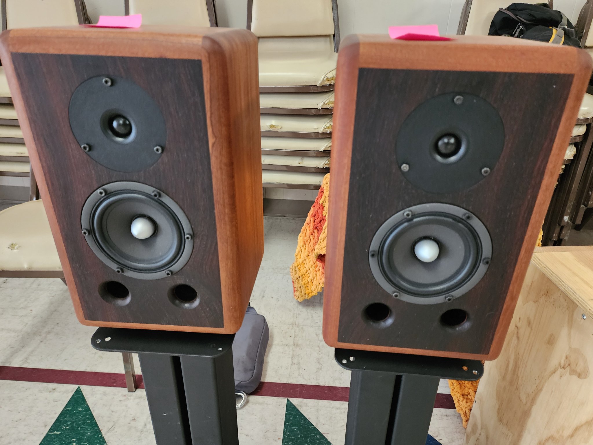

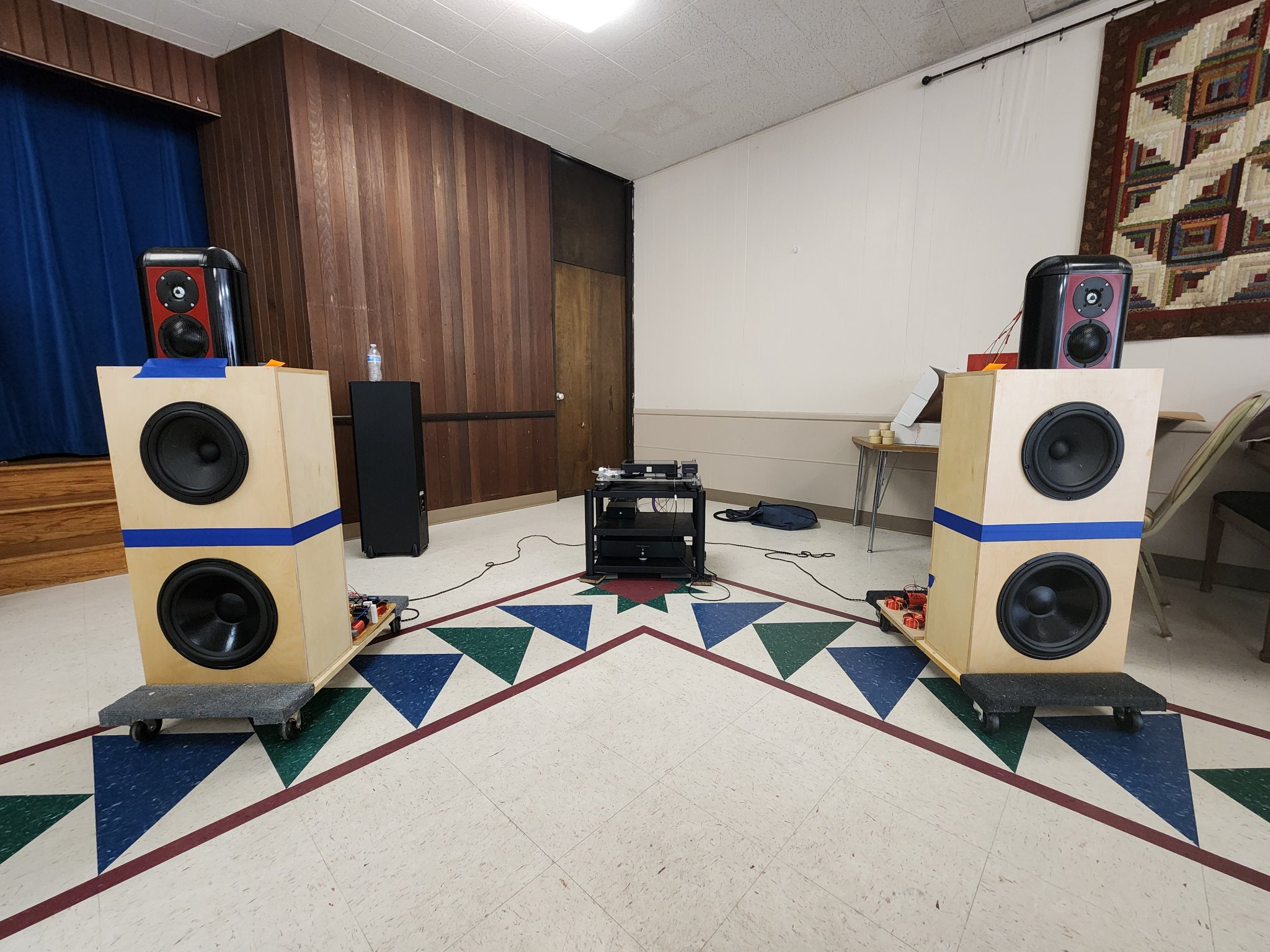

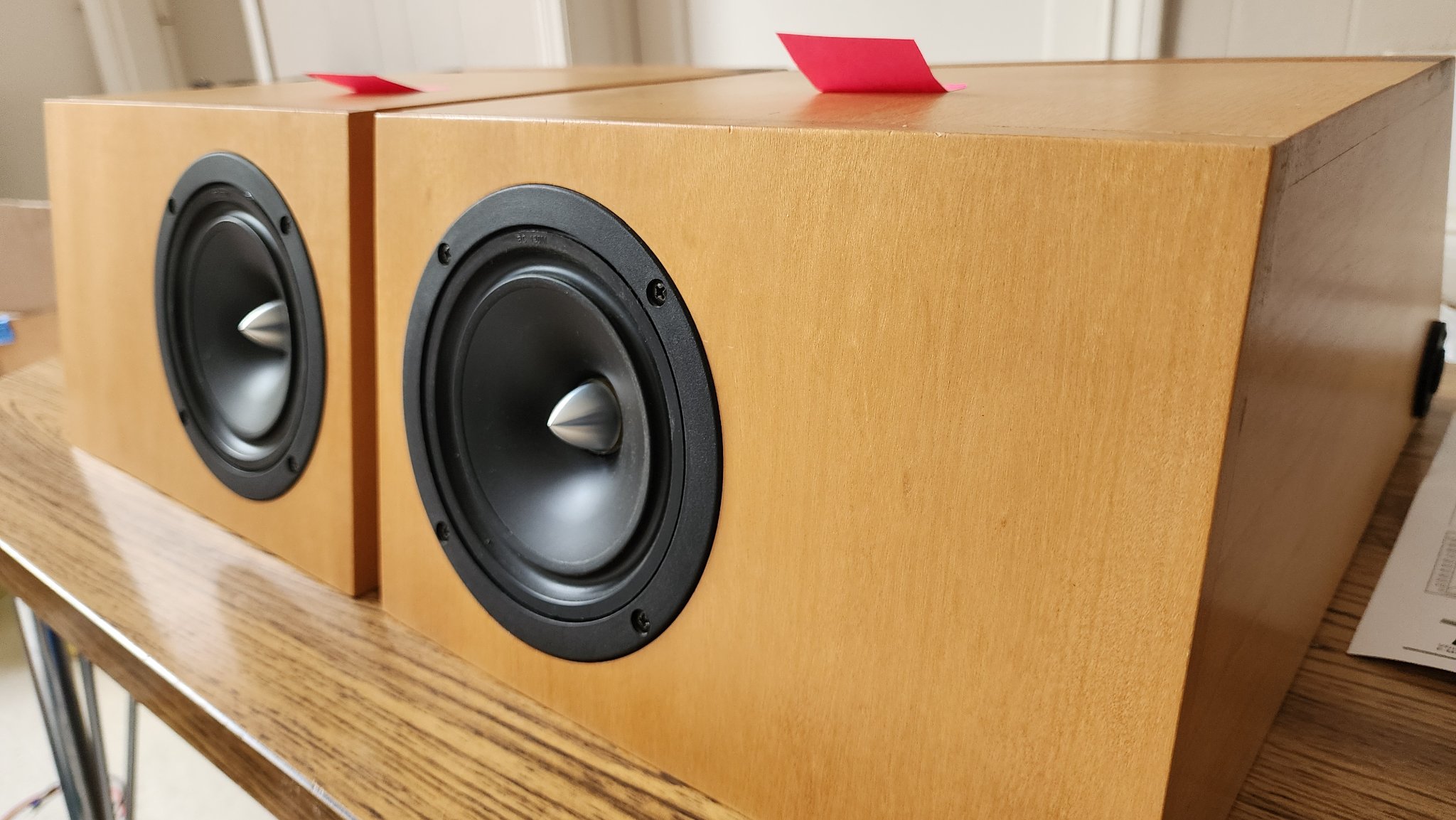

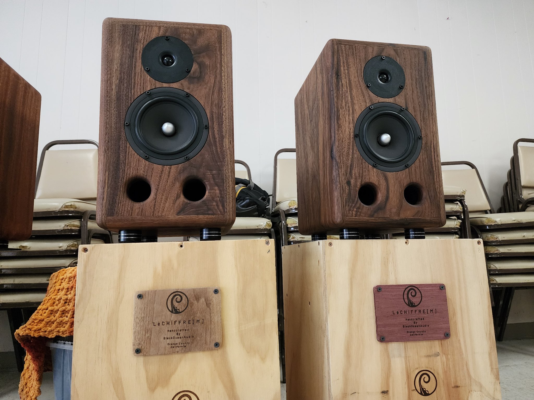

I didn't stay long enough to know the results, but there were lots of diy builds and all the ones I listened to sounded great.
Thanks to all the folks who gave their time and energy to put the event on and share their amazing builds.
