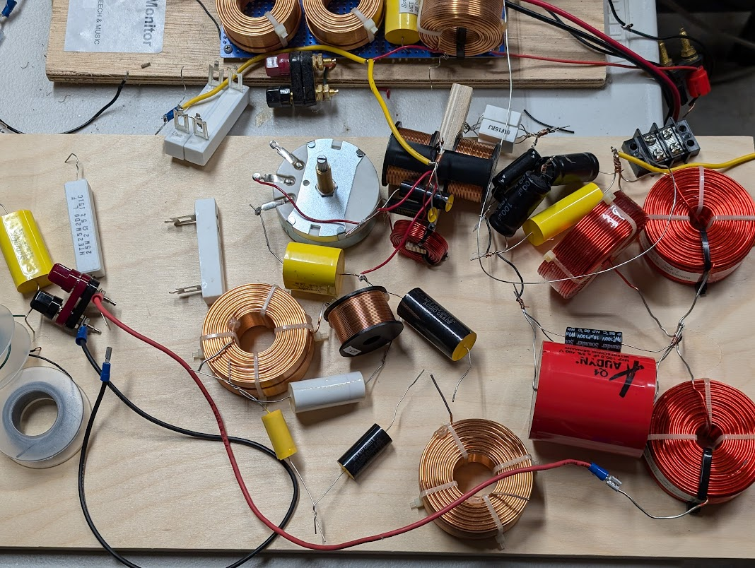

The nice thing about these passive crossovers is the expense and the "simplicity". When you don't have the value needed, just connect two or three other parts together. I'm about half way through assembly for the first speaker. Maybe next time we have a category for people building with multichannel plate amps with DSP crossovers.

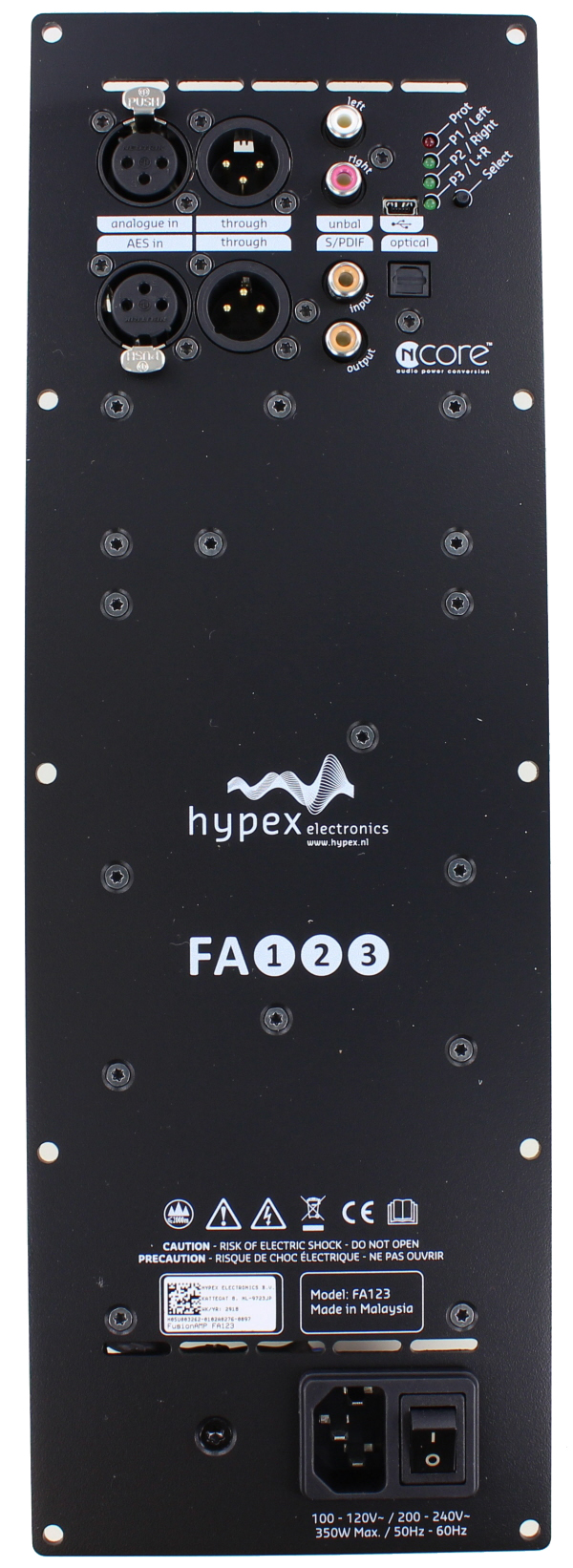

With so many tiny class D amplifiers available it is easy to pair them with a miniDSP or other digital crossover and hang the thing on the back of a cabinet. The Hypex Fusion plate amplifiers solve all the problems mentioned as they contain everything required and can simply mount on the back of any cabinet. With so many solutions from miniDSP and now Parts Express its easier by far to build an active speaker with these products than any passive design.
