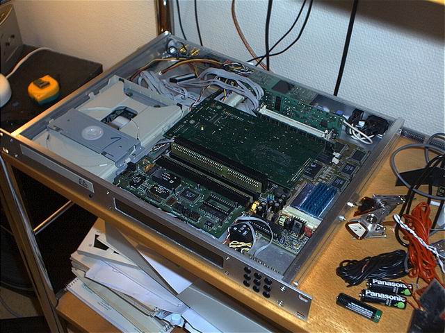

cyr said:I'm doing something similar, I've managed to squeeze a standard baby AT motherboard, network and sound cards, CD-ROM and power supply into a standard 1U case (not a 1U computer/server case).
The ISA 90deg angles are DIY, but PCI is a bit more complicated...
It has *no* harddisk (boots from a flash card) and *no* fan (the CPU is thermally connected to the case).

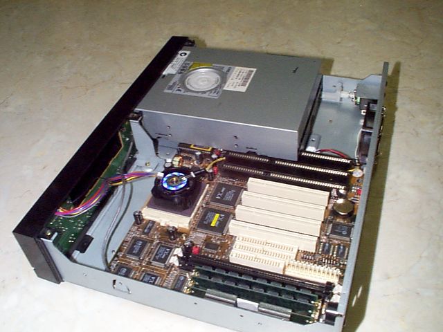

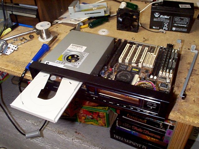

I was originally going to dismantle the CDrom, but then I found that it fitted in as it was.. JUST!! the bottom is resting on the harddrive, the top is resting on the top of the case, and the front of the metal CDrom case is "jammed" between a piece of plastic, and the PCB the buttons are mounted on.. 😛 lol, I tried puttng a different CDrom in, but it wouldn't fit!!! TOO WIDE!!!
