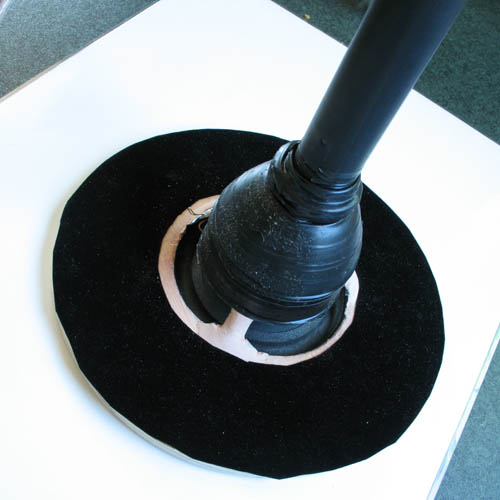

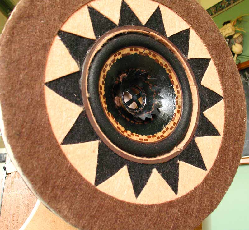

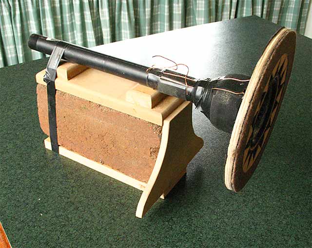

Nothing fancy they start out life as these:
http://www.altronics.com.au/index.asp?area=item&id=C0626
and these
http://www.altronics.com.au/index.asp?area=item&id=C0635
Cheap as chips but once modded the sound is fabulous
Here is a pic of one of my modded C0626 drivers from the rear. It attached to a sub baffle which actually fits inside a much larger baffle without touching it, so basically a magnet mounted driver.

It has a nice aboriginal art look.Zero One said:Here is a pic of the front of the driver on the sub baffle.
